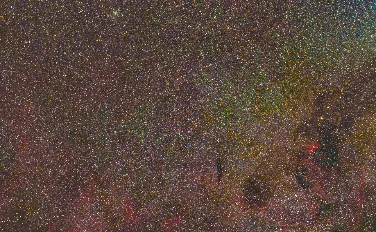

Hello guys,
I have some problems with star removal using either StarXTerminator or StarNet V2 for some time now. Maybe someone on here has a solution for this.
My workflow is as follows:
- Integrate using WBPP
- GradientCorrection
- SPCC
- BlurXTerminator
- Star removal (either SXT or StarNet V2)
Removing the Stars after I applied BXT leaves more artifacts in the center, but fewer artifacts near the edges.
Earlier I did wide field images with a dual setup with some 50mm lenses that were rather low quality. The star removal with both programs always left some ugly artifacts, but I blamed the low quality lenses and bad star shapes for this. I hoped getting better lenses would solve this problem in the future.
Now I upgraded to 2x Samyang 135mm F2 with relatively good quality. Unfortunately, I still run into the same issue with star removal, this time probably because of the insanely high star density in the frames instead of low star quality. Here is an example:

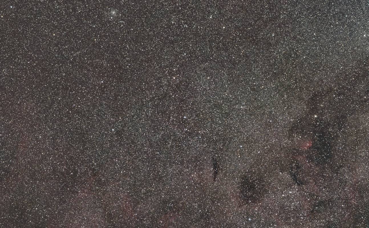

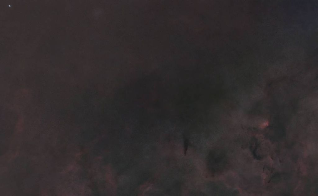

Image with stars:
Workflow: WBPP, GradientCorrection, SPCC, BXT

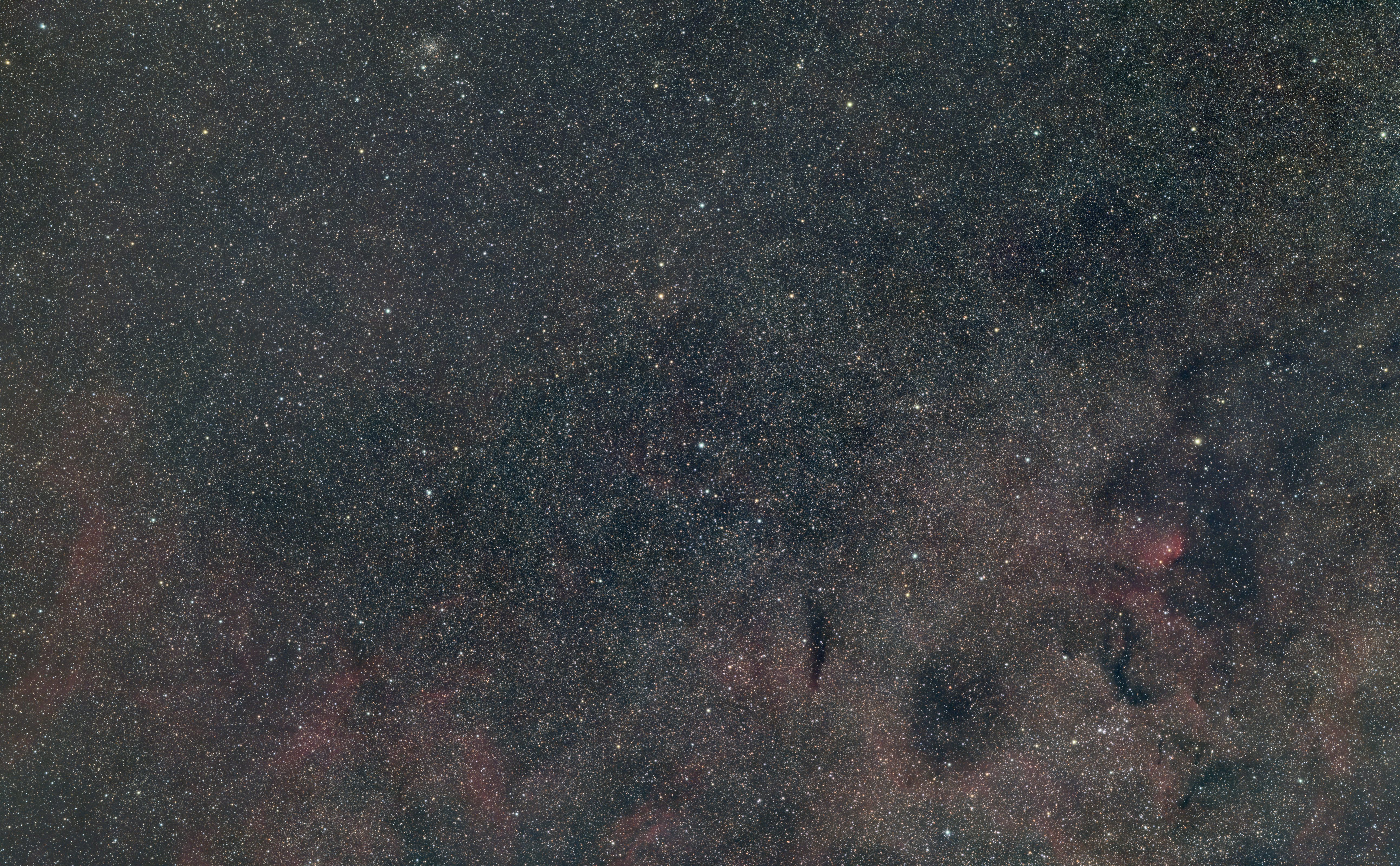

Image without stars:

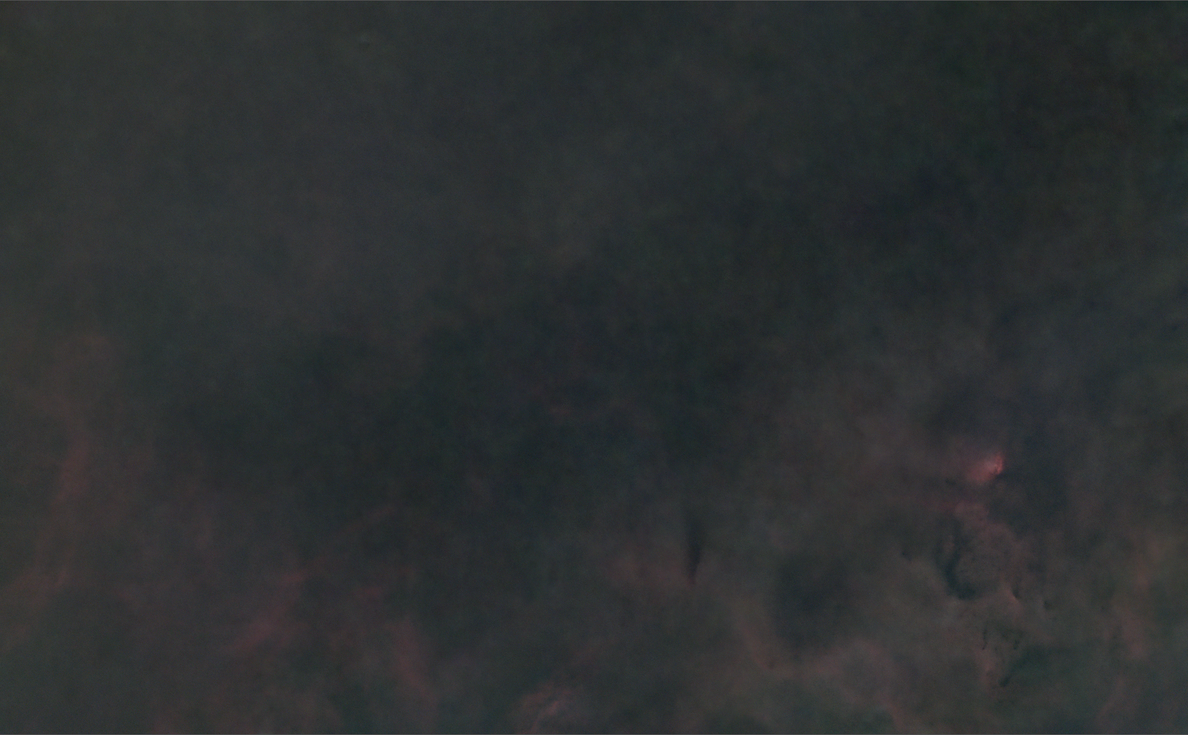

Workflow: Applied SXT with "large overlap" option to the prior image.
Both images have the same STF applied to them and are resampled and compressed to make the file size fit for the forum.

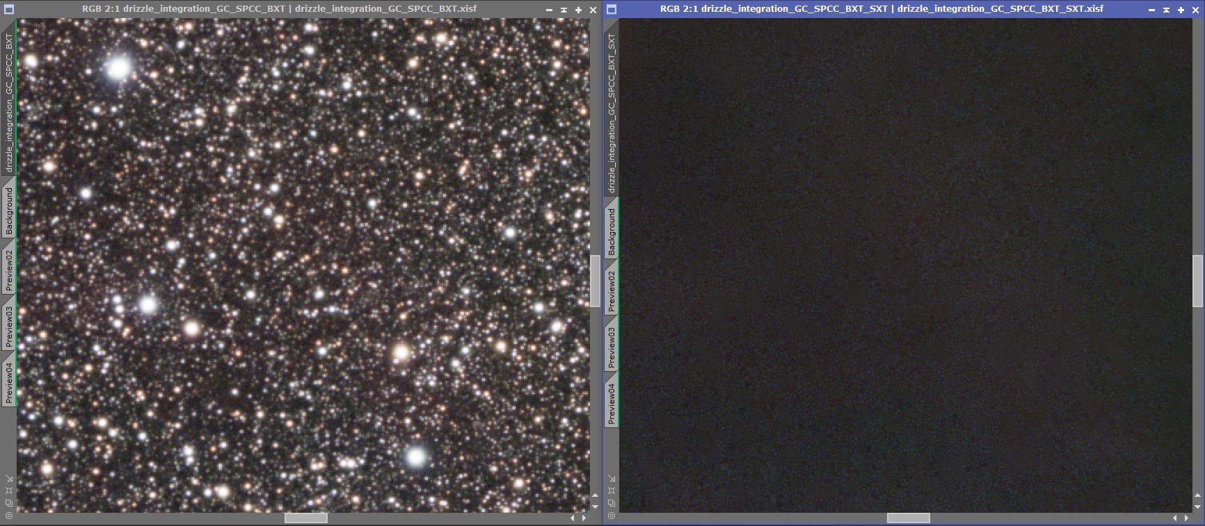

Here is a 200% comparison of a representative star field:
As you can see, the starless image shows a big dark region and has lots of point like artifacts in it.
Regarding the big dark region, I can't be absolutely sure that it hasn't been there prior to BXT, but I can't see it even when I stretch the image with stars very extremely. So I am pretty certain that this artifact is introduced by SXT.
As for the small point like artifacts, I identify them as leftovers from very small stars.
StarNet V2 does an even worse job with this.
In general, I assume that all these artifacts arise due to the crazy star density in the image. It is probably close to impossible to get a good background estimate in these regions due to this. But it still limits the processing possibilities for such fields.
Does anyone of you know a fix for this problem, or has any comments on this?
I already wrote with Rus about this, and he said that future versions will address this fix, but he does not know how long it takes to develop them, and it has already taken a decent time. So I would like to have a solution until the development is done.

First off, I can't see anything wrong with the starless image unless you plan to use just that, which obviously would be foolish. If you were to stretch both starless and stars separately, which I assume you do want to, then the "holes" will disapper once the stars are back in place. Secondly, if you were to operate BXT with a stretched version of the image then BXT would do a better job at leaving the starless relatively unscathed. Besides, I processed far denser fields than this with no major drawback from my point of view. And, yes, the big dark(ish) region was there all the time.
AstroDan500 7.19
I think SXT did an amazing job on this, I have no idea what you think is wrong.

First, there is the large dark region after applying SXT. This is a large scale feature, that won't be correctly restored after bringing in the stars.
As I said, I can't guarantee it, but it is most certainly not there before SXT. And I see that in many of my images.
Secondly, there are some features which I visually identify as very small stars that aren't removed. This gives the background after removing the stars such a "noisy" look, outside of the larger, removed stars.
This brings two problems: first, it lowers the authenticity of the data, because a lot of small stars will be way too bright after stretching the object, and secondly, any noise reduction on the starless image will try to remove these stars, as they are incorrectly treated as noise.
Admittedly, for the second problem, one has to zoom in pretty much to see it, but since this is present in the complete image, I still think it is important.
Unfortunately, I can't create a blinking animation of this that is uncompressed, I can only provide uncompressed images of the same region.
Maybe it is better to see once you load them into a blinking tool and compare the very small stars.

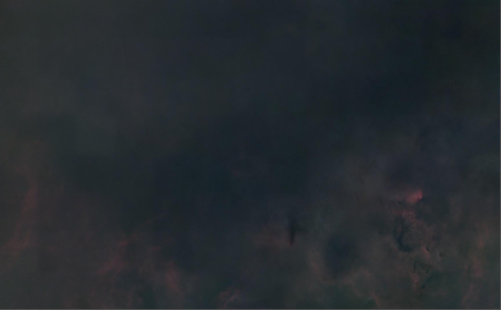

Not sure what are you complaining about. The examples you shared are rather stamp-sized and it would be best to share the original at full bit depth, but here is what it came out using SN++ V2. SXT doesn't work well unless it's full 32bit, apparently:
The one one the right is your starless, mine is in the middle. Stars to the left.

Is it possible that the starry field is confusing? Sometimes it causes us to mispredict the background. I, myself, sometimes get surprised when I see the background image after star removal, then I realize it is correct.  Not sure what you are exactly referring to as 'large dark region', but if I understand correctly, it is already there. Sometimes it is hard to see for some people, especially if you perceive colors differently. Maybe switching to grayscale might help. But I don't see any large dark regions that did not exist in the first place.

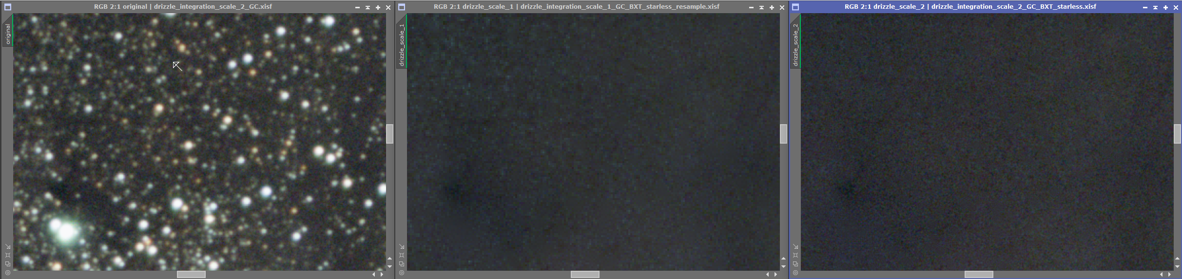

Ok, I kind of fixed the problem in the mean time, at least as far as I can tell.
I missed one of the most basic things about tiny stars: drizzle 2x or 3x!
My initial image was processed with CFA Drizzle 1x, redoing all the preprocessing with Drizzle 2x solved the problem nearly perfectly.
My theory is that the stars were too small and pixelated to be reliably identified as stars, so drizzling with an increased resolution solved this issue as it gave all stars a nice shape.
The workflow with the best results is thus:
- WBPP with Drizzle 2x
- BlurXTerminator
- StarXTerminator

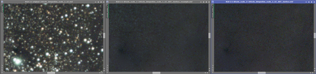

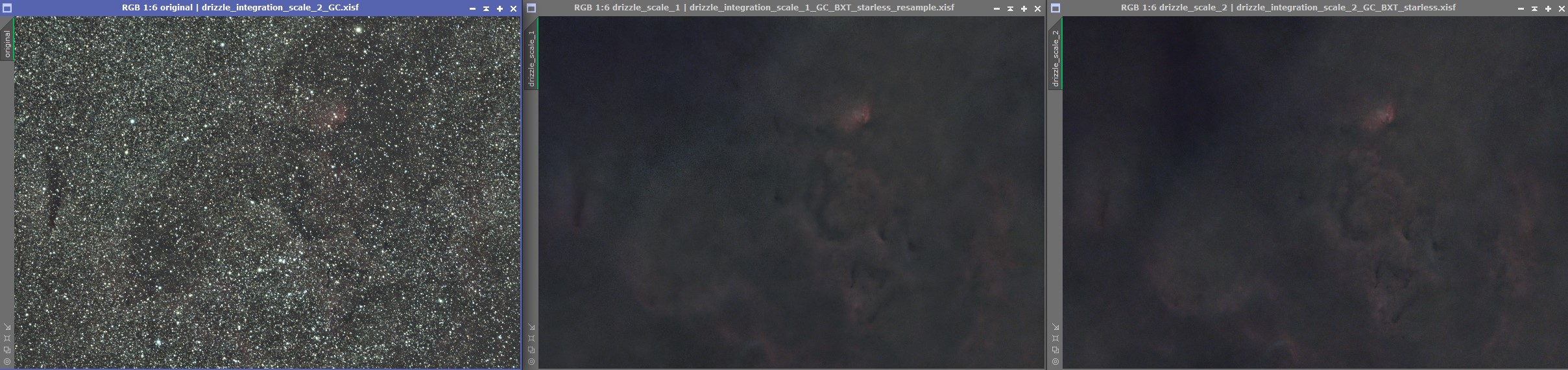

Here is a comparison between the two workflows with the only difference being the Drizzle scale:
This is a 200% zoom of the preview I used.
On the left side, you can see the original drizzle 2x image.
In the middle is the drizzle 1x image with GC, BXT and SXT applied.
On the right is the drizzle 2x image with GC, BXT and SXT applied.
At least for me, the right image looks much better in terms of star removal. A lot of the faint and small stars that were not removed with the drizzle 1x image are perfectly removed now. This makes processing much easier, but also takes much more time.

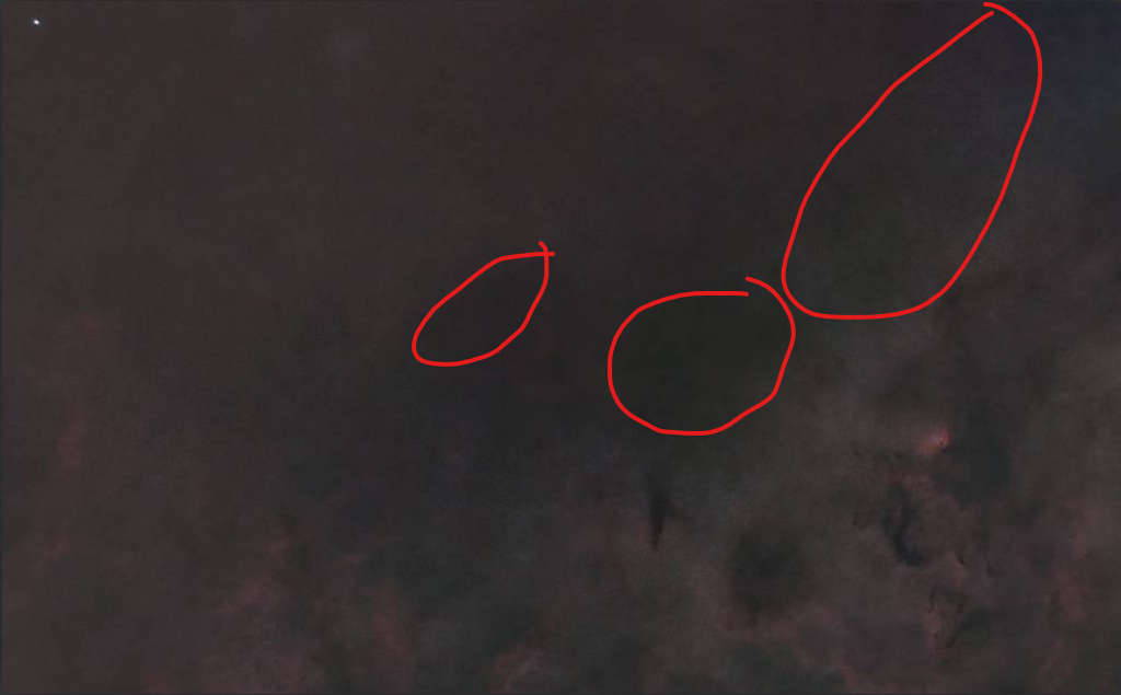

As for the background issue I mentioned, I am talking about these regions:
These regions are, as far as I can tell, darker than they are in the original image prior to star removal.
Also, even in the small preview region I used for the Drizzle 1x vs Drizzle 2x comparison, I can see a clear change in background color and brightness between both versions:
This indicates to me, that even slight changes in the image parameters drastically change the background estimation of SXT.
I will have to re-check this with StarNet V2.

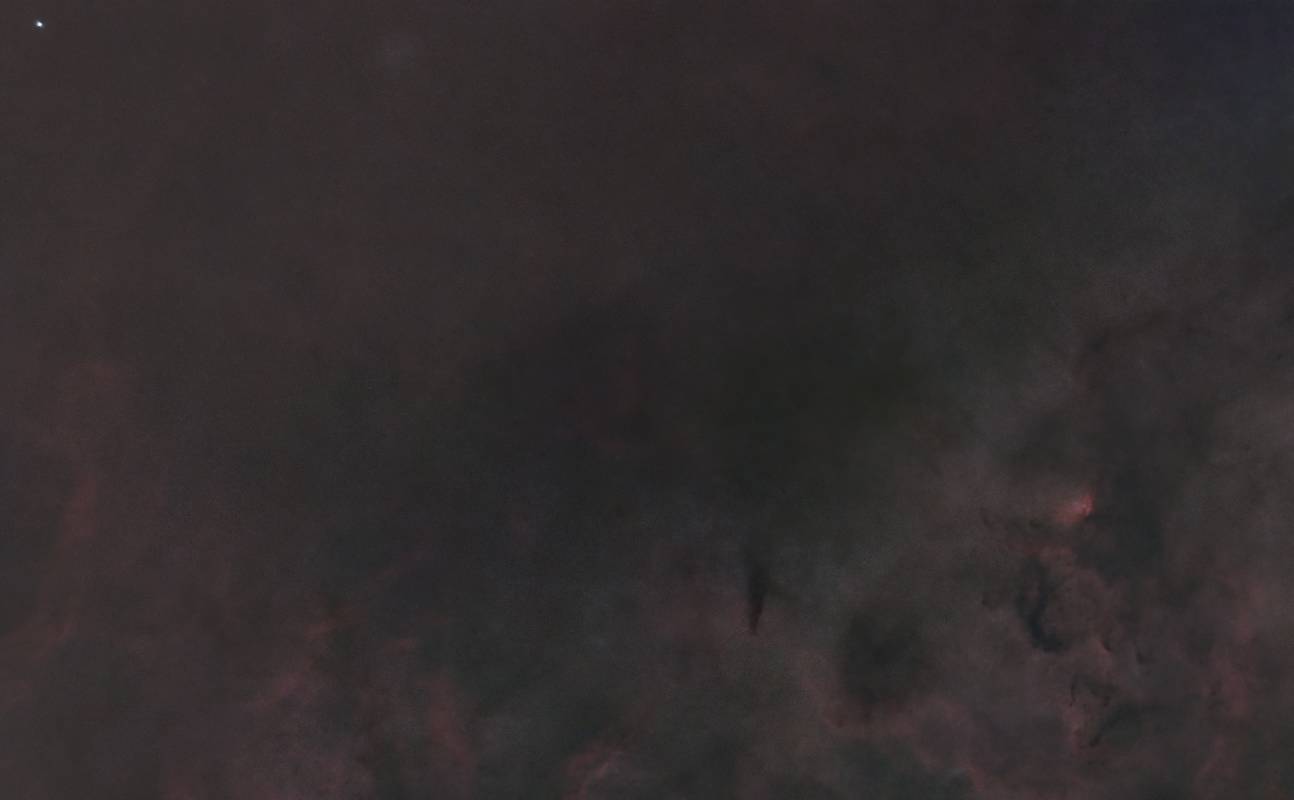

I agree with those who say that they don't see anything wrong with any of the starless images...
What I do see in the first image ("Image with stars") is a noticeable gradient that doesn't seem well corrected:
I set the vibrance and saturation to 100% in Photoshop to make it more evident: I see an green-bluish "cloud" going from the center to the top right of the field.
Before judging the StarX or StarNet performance, it would be good to see how does the final image look like, once the stars are brought back to the scene.

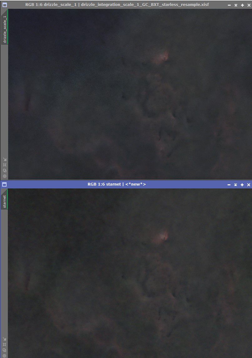

Ok, here is the comparison with StarNet v2:
Top image is Drizzle 2x, GradientCorrection, BXT, SXT.
Lower image is Drizzle 2x, GradienctCorrection, BXT, StarNet V2.
In my opinion, SXT has a much better brighness preservation, but leaves a more stained background.
Ideally, in my opinion again, would be a combination of the background preservation from SXT with the star removal capability of SXT.
Astrogerdt 0.90
Franco Grimoldi:
Allright, this could be indeed a problem. Sorry, I did not see your post before posting mine.
Maybe the gradient in your image could be due to using the JPG, but this seems unlikely to me.
To clear things up, here are the images I was talking about: https://drive.google.com/drive/folders/1lrJi0P09PkaKTK9TTmLRdEcN-fxLYkA7?usp=sharing
I am currently uploading all relevant files, it may take some time to finish.

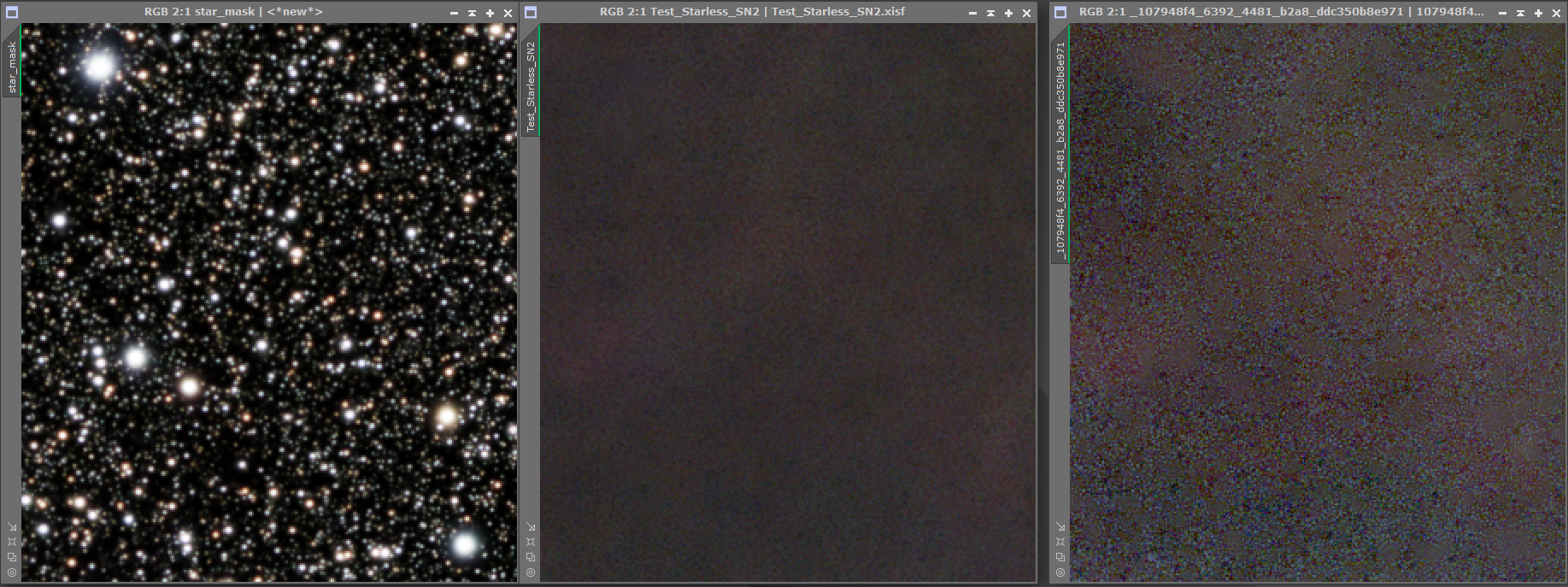

SXT applies a low-pass filter to the background (in a way similar to NXT but at a lower image scale I gather).
This with SXT (and Graxpert before), starting from the final drizzle integration with no other processing applied:
Note the squarish blocks spread all over the place and the green cast at the bottom and oversmoothed appearance.
Now with SN++ V2 (still with Graxpert to remove gradient):
This shows no block pattern and the distribution of color in the BG much more uniform and overall a LOT more realistic than the SXT results.
Now a pass with NXT and SCNR to remove the green cast:
Astrogerdt 0.90
Ok, I have to admit, in the larger scale, the blotchiness I initialized took as an error looks much more like actual nebula structure in the image.
Thanks guys!
