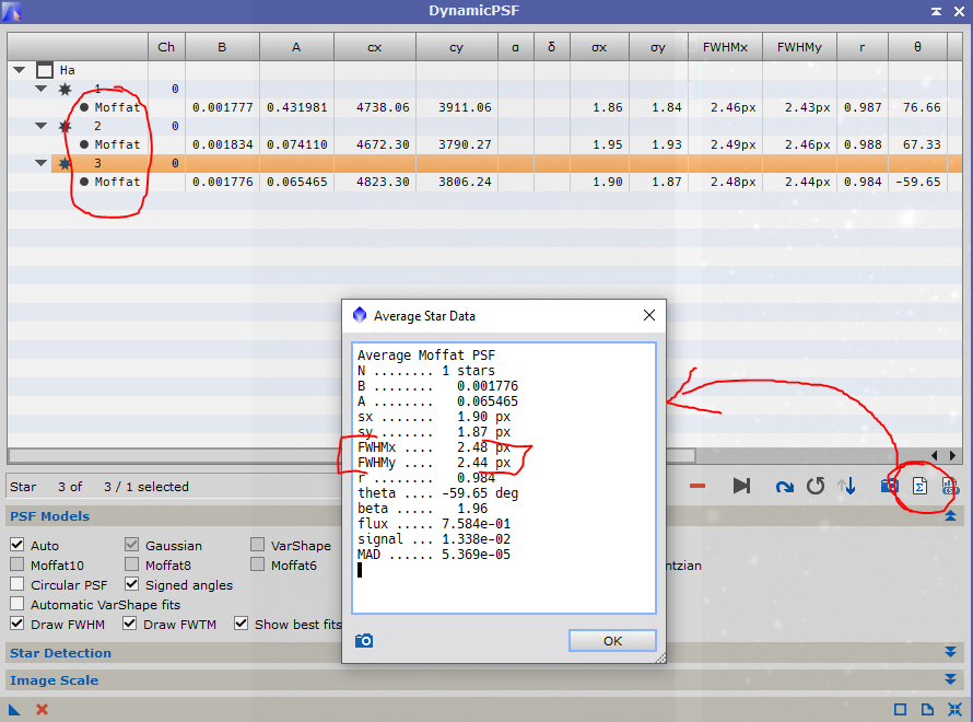

I'm also following the author advice because that's his program. What I usually do:
1- DynamicPSF - To calculate a more accurate PSF manually. BX yield better results for me since I started doing this instead of leaving it automatic.
2- StarXTerminator - After many experimentations, the cleanest star removal happen at this step for me. More noticeable with very bright massive stars.
3- DBE - Easier to work with without any star in the way and I almost always capture the stars at different exposures anyway.
4- BlurXTerminator - Non-stellar only (with stars removed) for the nebulosity using the manual PSF that was retrieved on step 1.
5- NoiseXTerminator - Just enough to make it workable for now while mixing colors (0.6 to 0.7). Will run it a last time at the very end.
The result is very sharp gas without artifacts.

I am intrigued by using a dynamic PSF instead of an automatic one. How do you find the value of the dynamic PSF to use for BXT?
Select ~40 stars well distributed around the center of the image. Pick them round, well delimited, not too big, not too small. Make sure they're all Moffat and make an average of the FWHM numbers you get for X and Y. PSF in BX will be global instead of locally adapted but I'm assuming this isn't a problem for folks with good optic with little to no tilt or aberation.

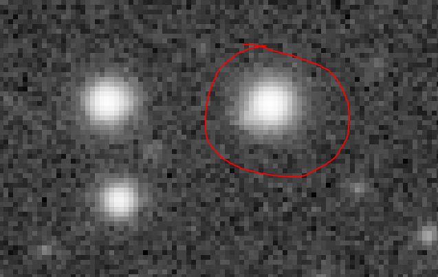

Yes I am strictly talking about non-stellar. I cannot explain exactly why but I could for example see how the automatic algorithm could pick egg shaped stars that were actually two stars not separated due to the Rayleigh limit of my optic as reference while a human or another script would avoid them.
See this star? My eyes tell me to avoid it:
While automatic PSF was already doing a very good job, after months I've stumbled into a live processing stream where the guy was using DynamicPSF and I've ran comparisons on my side and noticed slightly sharper results. I cannot guaranteed that what work with my setup will be better for everyone else. I'm absorbing information from everyone, experimenting and adjusting month by month.
