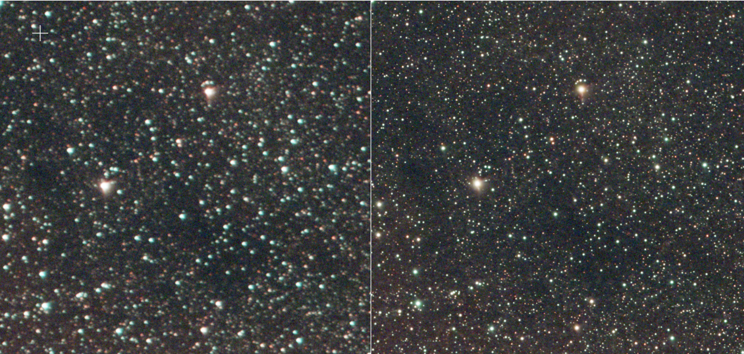

I gave my M16 data another shot. It showed misshapen stars all over the field due to the less than great reducer as well as bad seeing due to the low altitude of the nebula. BXT2AI4 did really well and corrected the stars.

I confirm that it works well also on coma sometimes present in short and fast focals.
This example below is a small field extracted in the corner of a Samyang 135 image processed by BX with the "correct only" option.

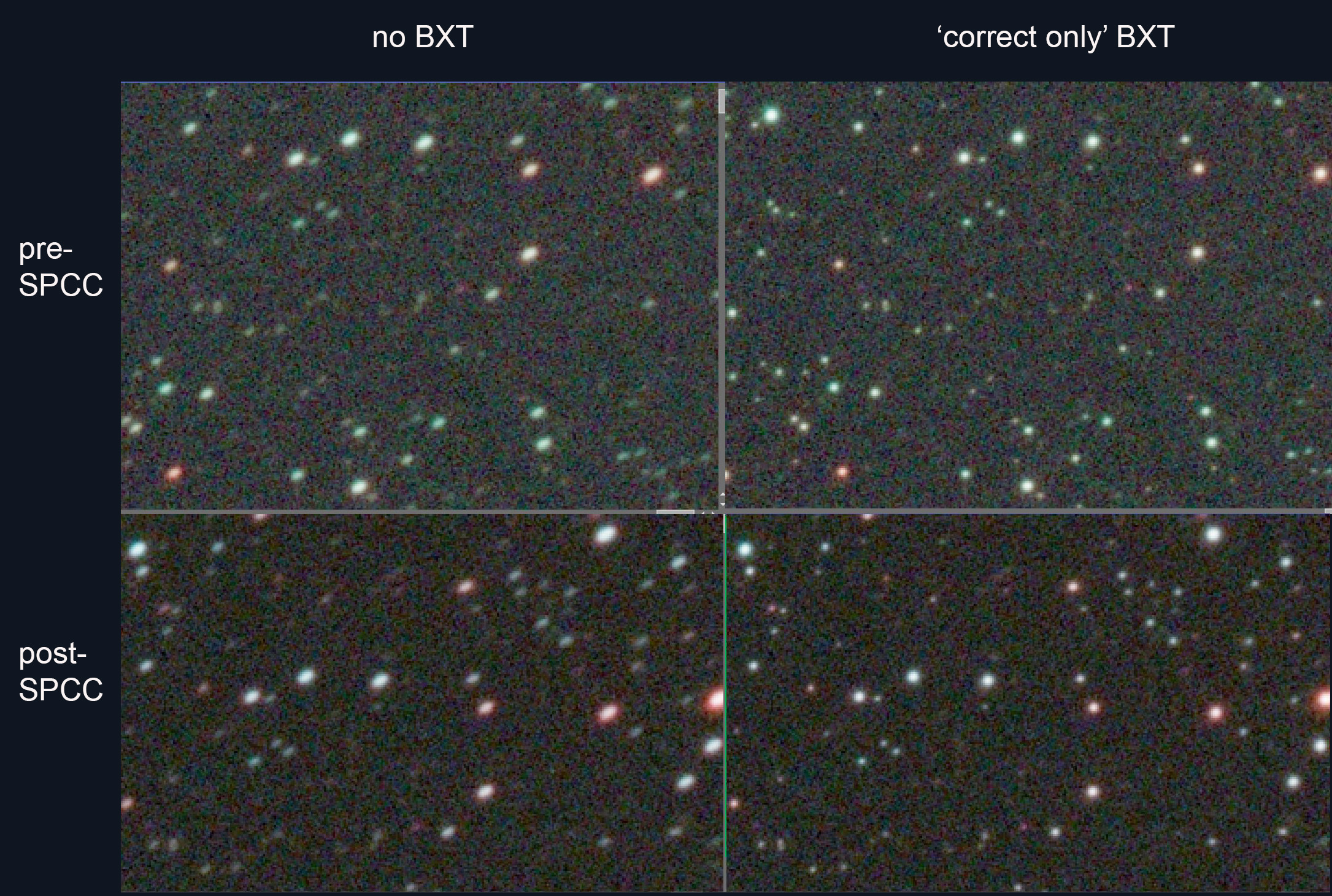

Wow!! this is really something.
Here is an extreme corner of a recent image showing some horribly eggy stars. Look what a run of 'correct only' does for it! (recommended workflow now is to run this before SPCC)

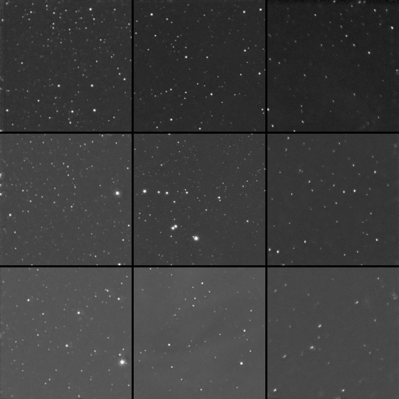

I'm in the process of setting up a FF camera with my old FSQ106N.  And I have yet to do any tilt adjustment to it, so I thought I'd compare the raw and BXT2 versions to see the level of improvement.  It is considerable.  I will still manually adjust the tilt to make the raw system better, but this is great.
https://astrob.in/6kfdfj/D/
