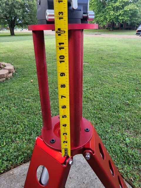

If anyone happens to end up with a RST-135(E), I have several risers left for the TPod 110 and TPod130 available for sale. It works reallt well. I had them made at a local shop since at the time I was unable to find the Rainbow Astro risers in stock. I couldn't have just one made so I had them make a batch and sold the others on the RST-135 group.io message board.  |
I have one of these risers Daniel had made and the clearance it affords is much more usable than the half pier Rainbow option. IMO. Tom
Daniel Carter: If anyone happens to end up with a RST-135(E), I have several risers left for the TPod 110 and TPod130 available for sale. It works reallt well. I had them made at a local shop since at the time I was unable to find the Rainbow Astro risers in stock. I couldn't have just one made so I had them make a batch and sold the others on the RST-135 group.io message board.
