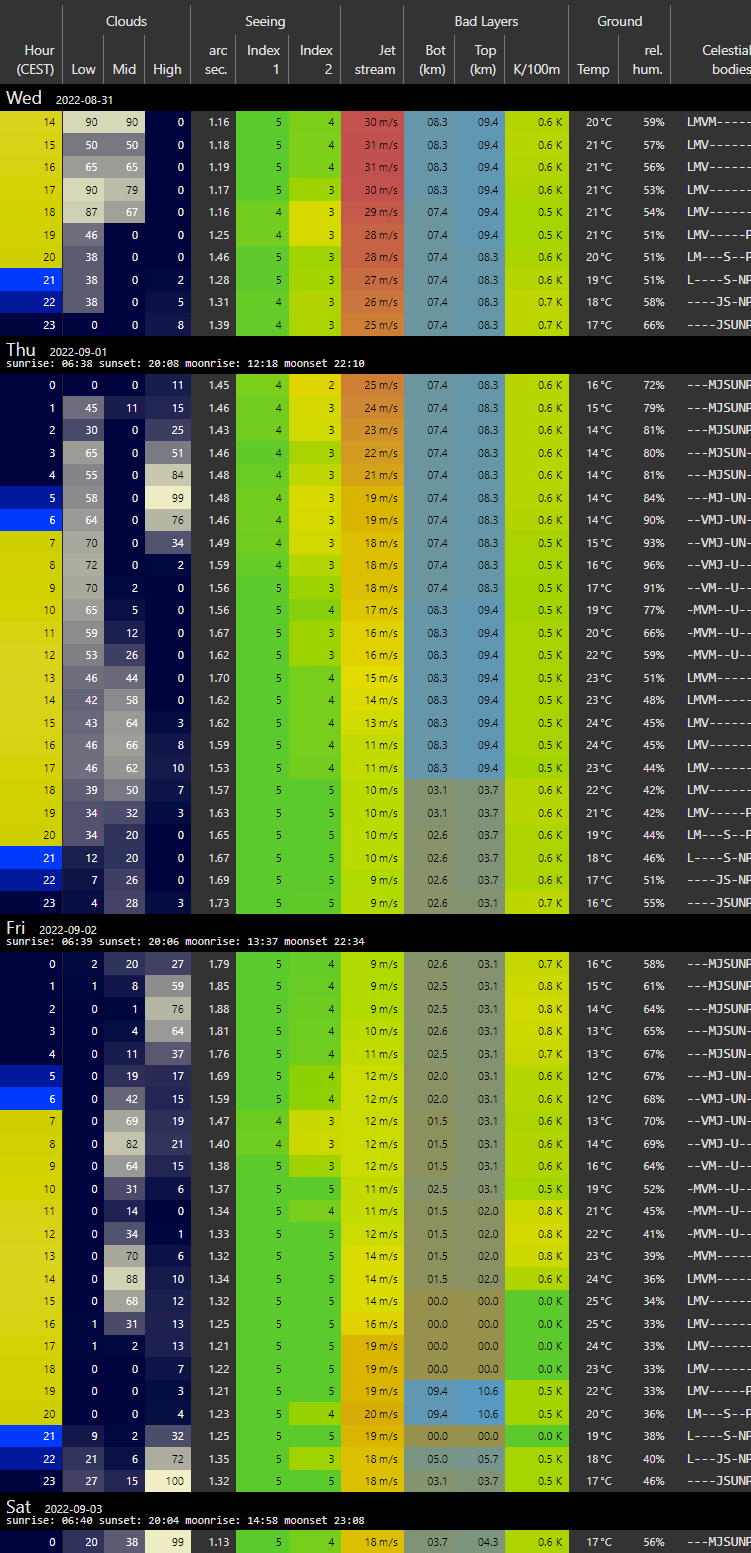

South of Germany, you're always welcome to join me in my public place. Maybe I'm missing something but that's what meteoblue seeing forecast tells me:
Sometimes it's a bit better, sometimes a bit worse.  I only do this since 1 year but so far I didn't have a session where the meteoblue values were worse than 2 arcsec, so something around 1.5 is fairly normal.
Always happy to learn about possible misconceptions.

Ah, THAT! Ok, I was thinking of something real. Like actual 1.5" seeing on average at the business end of a telescope all year long. THAT would be something to behold!
whwang 15.16
Meteoblue forecast constantly says my site has 0.3 to 0.5 arcsec of seeing, all the time.  And in reality my typical seeing is 1.4 to 2.0 arcsec.
So I wonder what the real seeing would be when meteoblue says 1.5 arcsec.
Wei-Hao Wang:
Easy enough: much worse!
