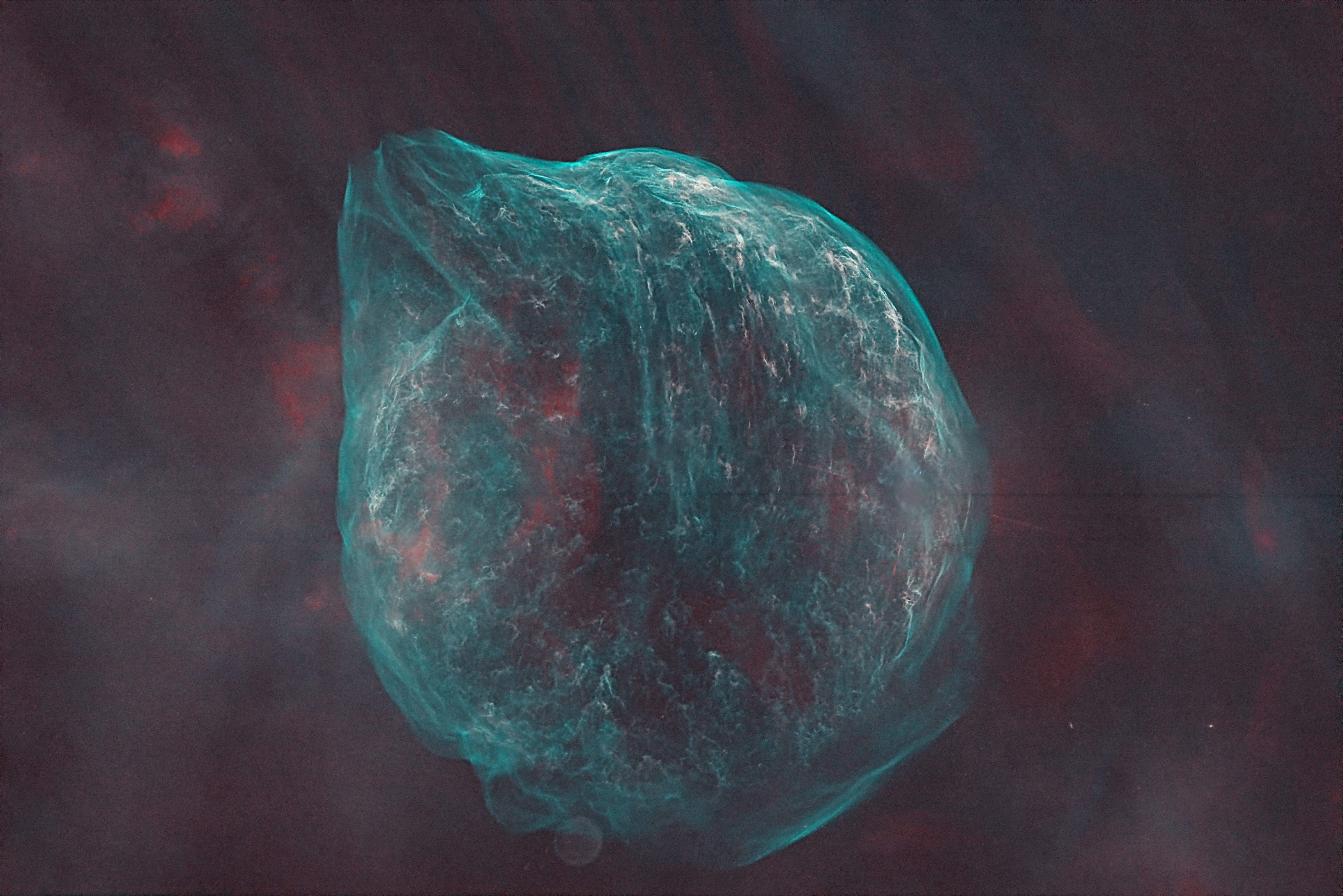

Hi all,
I've been running this camera for about a year, mostly in Mode 1 (High Gain) with Gain at 56, offset 30 and USB at 40 (this latter setting, after a lot of work getting horizontal banding down to an absolute minimum and achieving clean Bias).
This mode seems to be very effective for Nebula etc,. However, when there is a very large bright star (or stars) in the region, I get a horizontal dark band (like dark bloom?) from that star (or stars) that runs across the entire sensor and I cannot seem to calibrate that out. It is extremely feint in a single sub but gets accentuated on stacking.
Because of the above, and because I also wanted to shoot some brighter targets, I tried to find an alternative mode to see if I could avoid this issue. At the very least, a mode that offered maybe a larger Full Well capacity, to see if that helped mitigate it. (In fact, *any* set up that would avoid this problem!)
Well…in trying other modes, I cannot seem to get a usable setup. Whilst (I think) I can achieve a better result than the aforementioned "bloom", the horizontal banding noise in the various different modes is quite painful. Then, for each one, I'm trying different USB traffic settings, which does change the effect, but still does not give what I would call a desirable (or for me, a "usable") result. Once I got to something half decent, (Mode 3 EFW 2CMS, Gain 0, Offset, USB 3), it was still far to heavy in horizontal banding/noise. Another challenge is that the time needed to be spent on this is also painful.
The result, so far, is that I either live with my "working" mode and modify imaging and framing accordingly to compensate OR I test out every single other combination to find a compatible working setup for brighter targets.
My questions therefore are:
1: Have you experienced same or similar issues above and how did you mitigate the issues?
2: Are you also running different modes for dark or bright targets? If so, which ones? (Where should I focus my attention?)
3: Does excessive banding lean more towards external issues, power, cables etc.,? (This is remote, so not as easy to test).?
4: Or is this, "keep testing, you'll find something works" ???
Thanks in advance for sharing your experiences!

I'm having this same issue with our QHY600. See the dark band (2 actually) that coincide with bright stars. You can see the mouseover with stars in and out here https://astrob.in/seimui/0/
Keen to know if there are settings that might help. This is Mode 1(HG) Gain 56 offset 26
