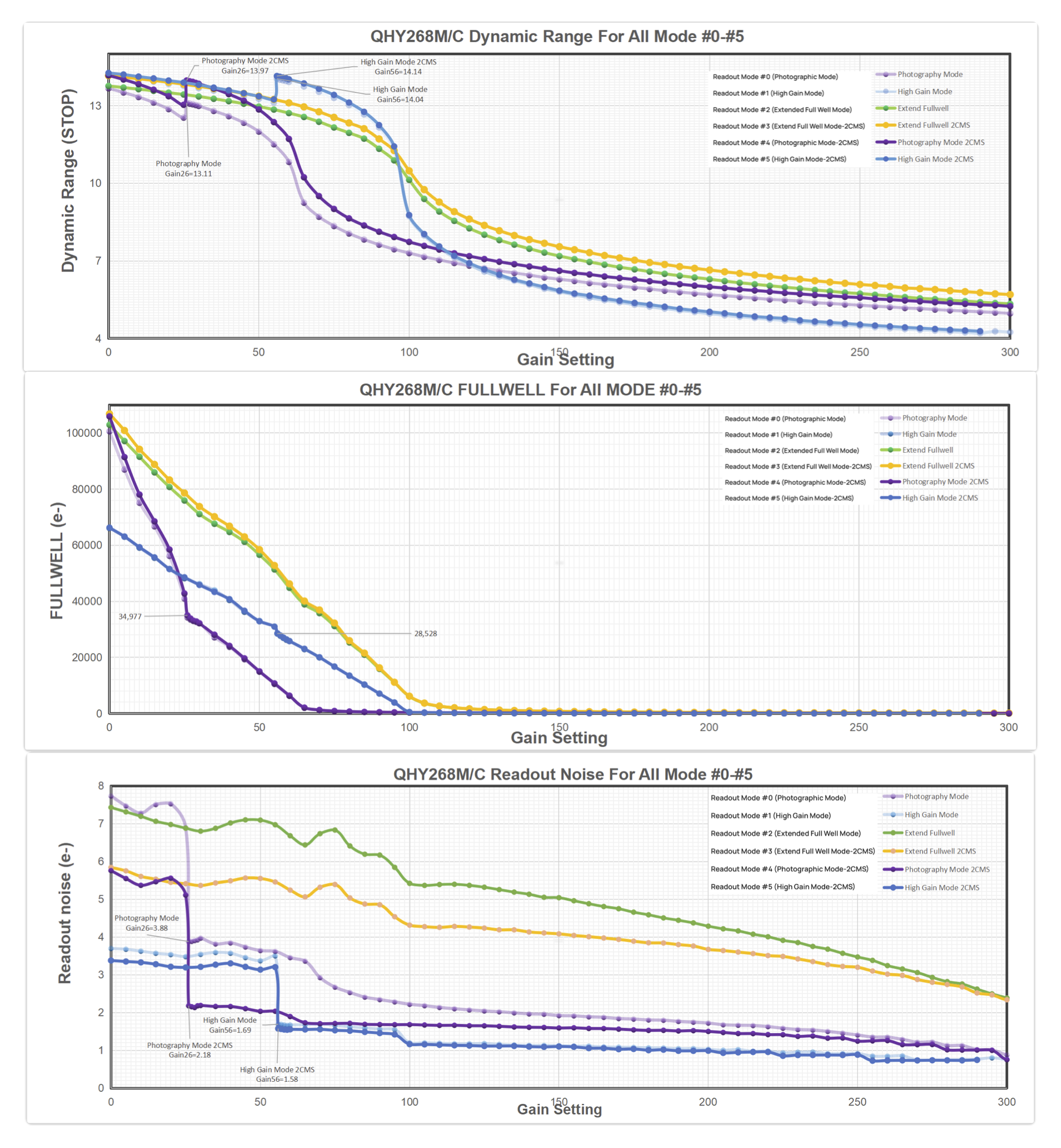

F3 DeltaRho: 120 Luminance, 300 RGB, 600 NB F3 FSQ106: 300 LRGB, 600 NB Kevin, What led you to settle on the extended full well mode 2CMS? Was it the greater well depth for shooting at F3? I started using the 268 about 3 years ago. At the time, it seemed that high gain mode, gain 56 for NB and gain 0 for BB was the most commonly used mode/gain settings. Since settling on these settings, I haven't paid much attention to the other modes and the subsequent new modes. Looking at QHY's graphs, it looks like the 2 biggest things that stand out between extended full well 2CMS mode (gain 25) and high gain mode (gain 56) are: 1. 2.8 times the well depth (80k vs. 28.5k) 2. 3.7 more readout noise (~5.5 vs. ~1.5) Is the increase in readout noise even a concern if you're piling up dozens of hours on an image? I've recently moved my TOA130 and 1100GTO-AE to a remote observatory, and I'm looking to make any mode/gain changes that are better suited for the dark skies. My only change so far has been to increase my Ha exposures from 5 min to 20 min.  |
 I originally used the high gain mode when I first got the QHY600. My goal was to maximize dynamic range. But I had a lot of issues with horizontal dark bands emanating from the saturated cores of bright stars. I switched to the extended full well to minimize these dark bands. This is mostly worked. Only extremely bright stars exhibit that banding now. The trade of was read noise. But I also was able to lengthen the exposure times which means fewer total subs and thus fewer reads. It also means less storage required, which is nice. Rather the get too pedantic about these decisions (remember you don't even have these choices with other manufacturers), I picked this and stuck with it. That meant using the same settings on my DeltaRho when that came along. Of course, this high full well settings are better suited to F3 than F7 anyway. Looking at these most recent charts and the new HighGain 2CMS I might try that mode with Gain 57 and see how it works out. But that would cut my full well down considerably. Kevin

Kevin Morefield: Mode 3, Gain 25, Offset 20. I use that for all filters. Looking at those latest charts, wouldnt you want gain 26? it looks like that is where read noise takes a nosedive. We are spoiled indeed with these BSI sony chips...

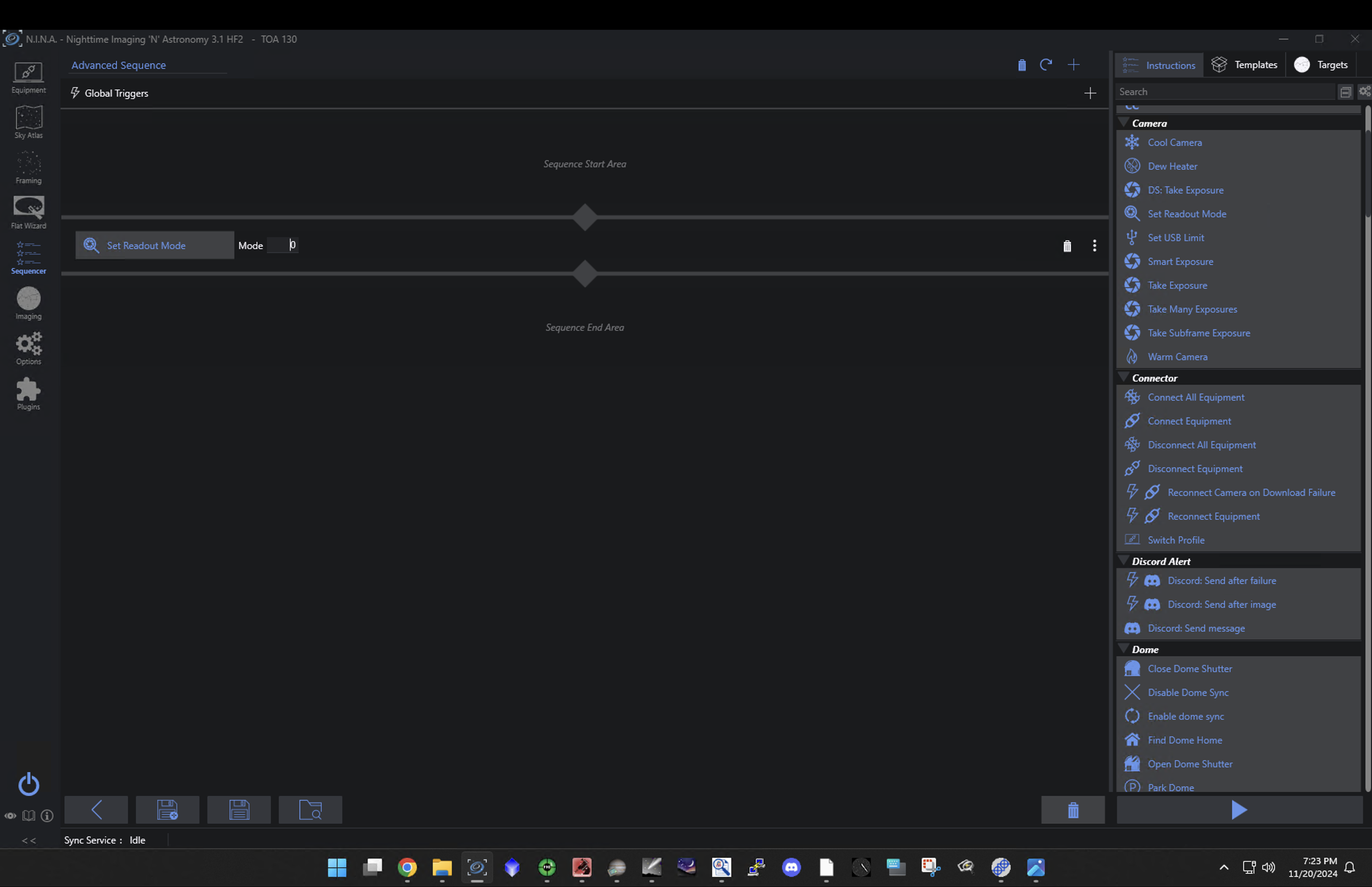

Chris White- Overcast Observatory: and this gives the ability to shoot broadband and narrowband on the same night (automated). Chris, Do you use NINA? I see that changing readout modes is available in the Advanced Sequencer but I'm still in the process of re-learning how to use the Advanced Sequencer. I have not tried that function yet.  |
 I'm using voyager. ill have to look to see if i can do this in dragscript. I do like the idea of just one setting though. Lol
We are spoiled indeed with these BSI sony chips... I’m looking at Mode 5 which I think has a gain 56 cutoff.
We are spoiled indeed with these BSI sony chips... I’m looking at Mode 5 which I think has a gain 56 cutoff. My bad, I got the modes confused. Too many to choose from and the names are similar.
Chris White- Overcast Observatory: Looking at those latest charts, wouldnt you want gain 26? it looks like that is where read noise takes a nosedive. Chris, The read noise in mode 3 is almost constant between gain values of 25 and 26. The reason that I use gain 25 is that's unity gain in mode 3. Using a gain other than one either reduces the well depth or sensitivity. Well depth is very important if you want to preserve star colors. And you are correct that this single setting works well for both broad and narrow band, which simplifies everything about using all of the filters at your disposal. John
