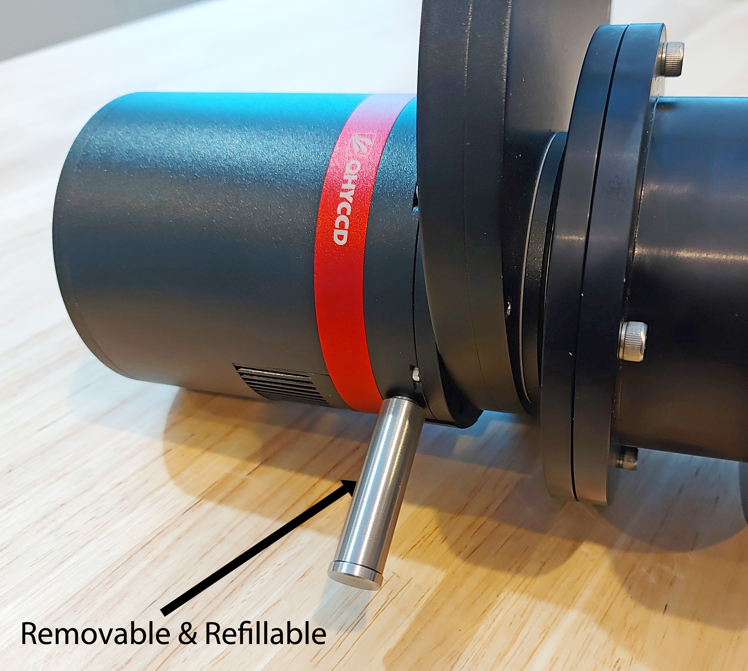

John The camera has no desiccant pellets inside of the chamber, just the desiccant tube you thread into the side of the camera body. If that isn't installed, I would get it installed. If it is instated, I would have the local team dump and fill the tube.
John HayesNow I'm really puzzled. The camera has worked just fine for the last two nights. If it weren't for the fact that the problem went away on the first night after we swapped cables, I would conclude that the camera window had frosted over. This camera might be old enough to require a new desiccant pellet and if the humidity were sufficiently high, frost could have formed. I don't know. I didn't mention that when I was first having the problem, I slewed over to the moon and took a few images, which were sharp enough to rule out frost. If it keeps working, I'm ok with that but this problem will be in the back of my mind going forward. Weird.
You'll need this plug and some desiccant pellets.
https://www.amazon.com/Wisedry-Rechargeable-Desiccant-Indicating-Reusable/dp/B01M7V19JE/ref=sr_1_11?crid=TANO8OCBM4MK&keywords=dessicant&qid=1667665432&sprefix=dessican%2Caps%2C148&sr=8-11
I use these and now the plug is on permanently. There is nothing inside the camera. My QHYs usually lasted 6 months before a recharge.

Also, I'm don't know about the imaging software you are using but with NINA, the chamber -Relative Humidity- is constantly displayed. I try to keep mine low, under 50%. The desiccant has recently been charged and its at 24% despite it being 80% outside.
–Rouz
The scope has been in Chile for a year and that camera is roughly 1.5 years old. The chamber has never been "dried out" so that's a good suggestion. Still, there's not enough evidence to suggests that frost was the problem.
