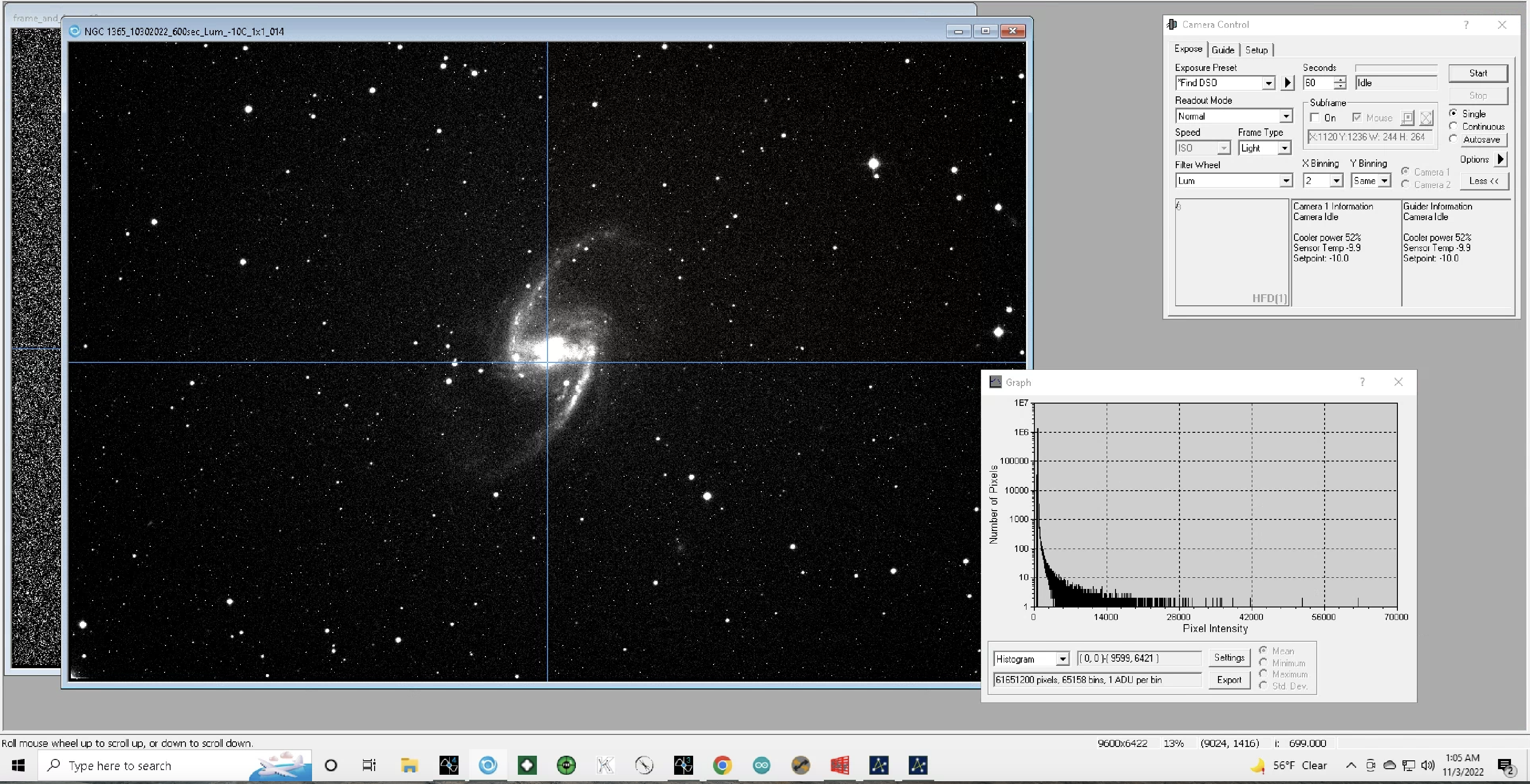

A couple of months ago my ATIK Horizon 2 guide camera started acting "wonky."  The background level suddenly went way up.  I mitigated it by subtracting a dark frame but it has screwed up the SNR of my guide signal.  Fortunately it still works well enough to guide.  Fortunately, I already have a replacement camera sitting at the observatory ready to be installed.  This is the second failure of a Horizon 2 in less than a year.

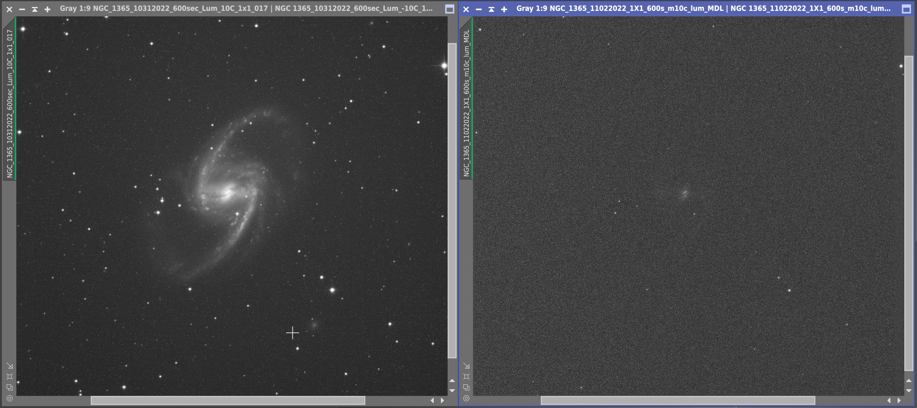

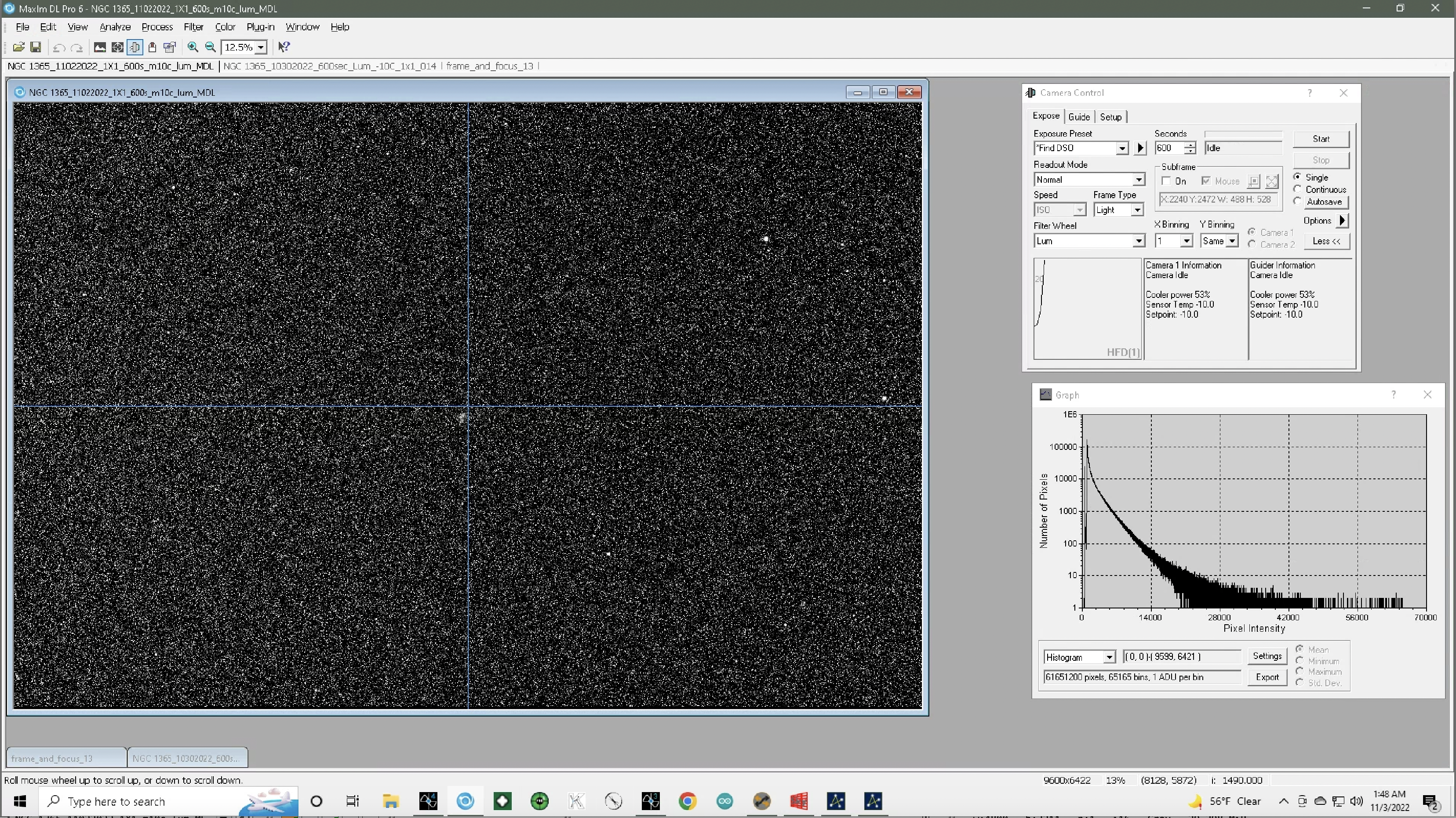

Just last night my main imaging camera, a QHY600PH M, went "wonky" in a different way.  It almost looks as if the 16 bit image data has been bit-shifted left by ~ 4-5 bits--but that's not what is happening. We fixed it last night by pulling and reconnecting cables but I'm out of luck tonight.  I can't get it to work correctly.  Here is a comparison of two images of the same object through a LUM filter at the same cooling temperature with the same exposure before and after the "glitch".
Here are histogram plots of both images.  First, before:
And second, after the failure:
There is no dew and the sky is clear.  This sure looks like a camera problem.  As I said, we fixed it last night by pulling cables and reconnecting them.  I've also tried a brand new USB3 cable with no improvement.  We haven't yet measured the voltage at the camera so that might be a problem.  This particular data was taken using MDL but I get the exact same results using SGP (my normal imaging program).
My question:  Has anyone else seen this problem and is there a simple fix?  I want to exhaust all possibilities before jumping on a plane to go to Chile with a replacement camera.  With two dead cameras, I'm already mentally packing my bags.

I can see that the first image set the binning at 2 while the second set at 1?
Regards,
Robin

4).  I tested the system using both 1x1 and 2x2 binning.  When I posted this data, I goofed and pulled up one of the 2x2 images to compare with a 1x1 image.  Binning makes no difference in the results and I apologize for the mistake.
