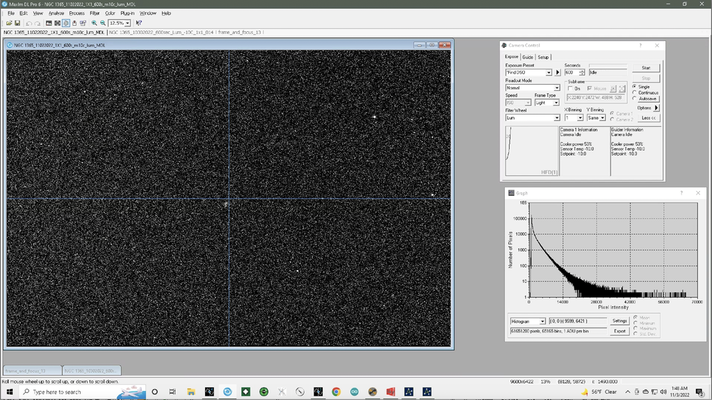

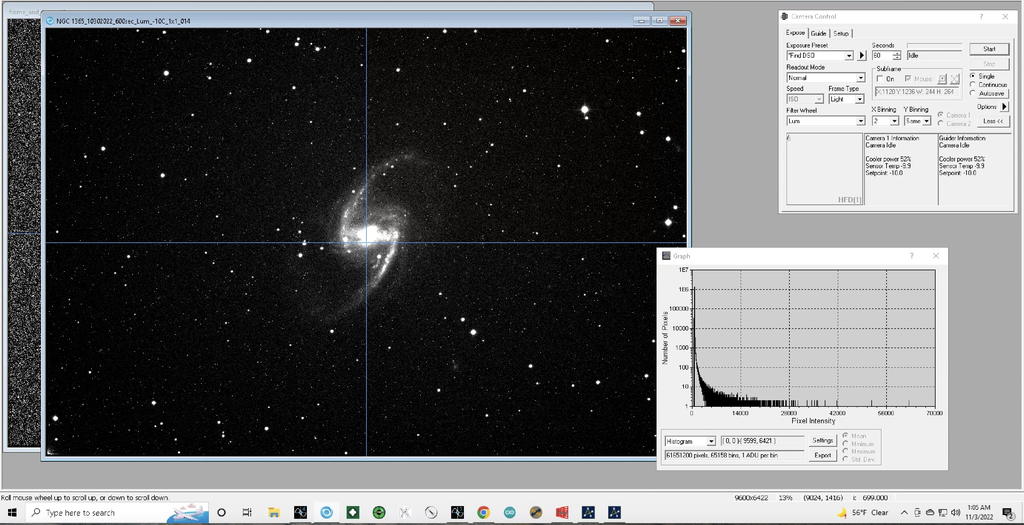

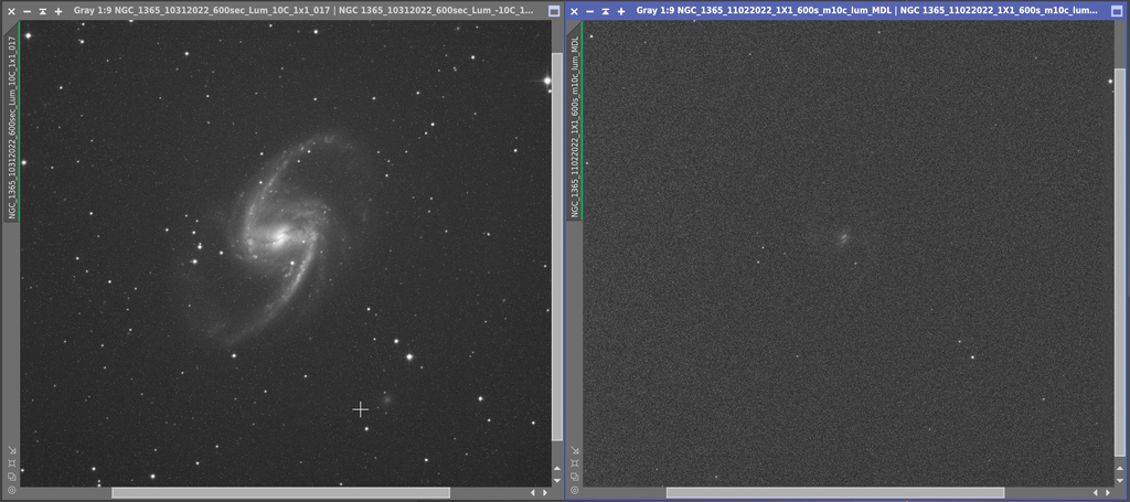

A couple of months ago my ATIK Horizon 2 guide camera started acting "wonky." The background level suddenly went way up. I mitigated it by subtracting a dark frame but it has screwed up the SNR of my guide signal. Fortunately it still works well enough to guide. Fortunately, I already have a replacement camera sitting at the observatory ready to be installed. This is the second failure of a Horizon 2 in less than a year. Just last night my main imaging camera, a QHY600PH M, went "wonky" in a different way. It almost looks as if the 16 bit image data has been bit-shifted left by ~ 4-5 bits--but that's not what is happening. We fixed it last night by pulling and reconnecting cables but I'm out of luck tonight. I can't get it to work correctly. Here is a comparison of two images of the same object through a LUM filter at the same cooling temperature with the same exposure before and after the "glitch".  Here are histogram plots of both images. First, before:  And second, after the failure:  There is no dew and the sky is clear. This sure looks like a camera problem. As I said, we fixed it last night by pulling cables and reconnecting them. I've also tried a brand new USB3 cable with no improvement. We haven't yet measured the voltage at the camera so that might be a problem. This particular data was taken using MDL but I get the exact same results using SGP (my normal imaging program). My question: Has anyone else seen this problem and is there a simple fix? I want to exhaust all possibilities before jumping on a plane to go to Chile with a replacement camera. With two dead cameras, I'm already mentally packing my bags. John
John,
I don't have a straight answer to your question. But maybe a test to make for checking the electronics: Can you capture a dark frame on your scope and do you have dark frames from previous sessions, when the camera worked ok? If you'd capture a new dark and it's characteristics match the "old" dark, it would point to the direction that the electronics is fine and the issue must be infront of the sensor.
EDIT: Ok… After giving it another thought, if plugging cables helped once, it could be electronics and doing this dark test won't probably help too much.
Björn
I can see that the first image set the binning at 2 while the second set at 1?
Regards, Robin

Thank you all for your feedback and thoughts. As usual, when I did this post, it’s easy to forget things so I didn’t supply quite enough background on what I’ve tried and how I operate. So, in no particular order, here is some additional background that will form a response to many of the good comments and suggestions here.
1). I’ve been running this scope in it’s current configuration every clear night for almost exactly one year. In Chile, that translates to around 300 nights. I always run the scope with SGP.
2). The power supply is one originally supplied by FLI for my FLI-ML16803. Before the scope went to Chile, I carefully checked the voltage against the QHY supplied power brick and they were within a few 10s of milli-volts of each other. The FLI power brick has more current capacity than the original QHY supply so it runs really cool. As I said in the original post, I haven’t yet asked the guys at the observatory to put a DVM on the power cable, but I will. It could be a supply problem but I personally put that as “low” likelihood.
3). One thing that I forgot to mention is that when this problem occurred, I homed the filter wheel and then defocused the scope to confirm that nothing was blocking the pupil.
4). I tested the system using both 1x1 and 2x2 binning. When I posted this data, I goofed and pulled up one of the 2x2 images to compare with a 1x1 image. Binning makes no difference in the results and I apologize for the mistake.
