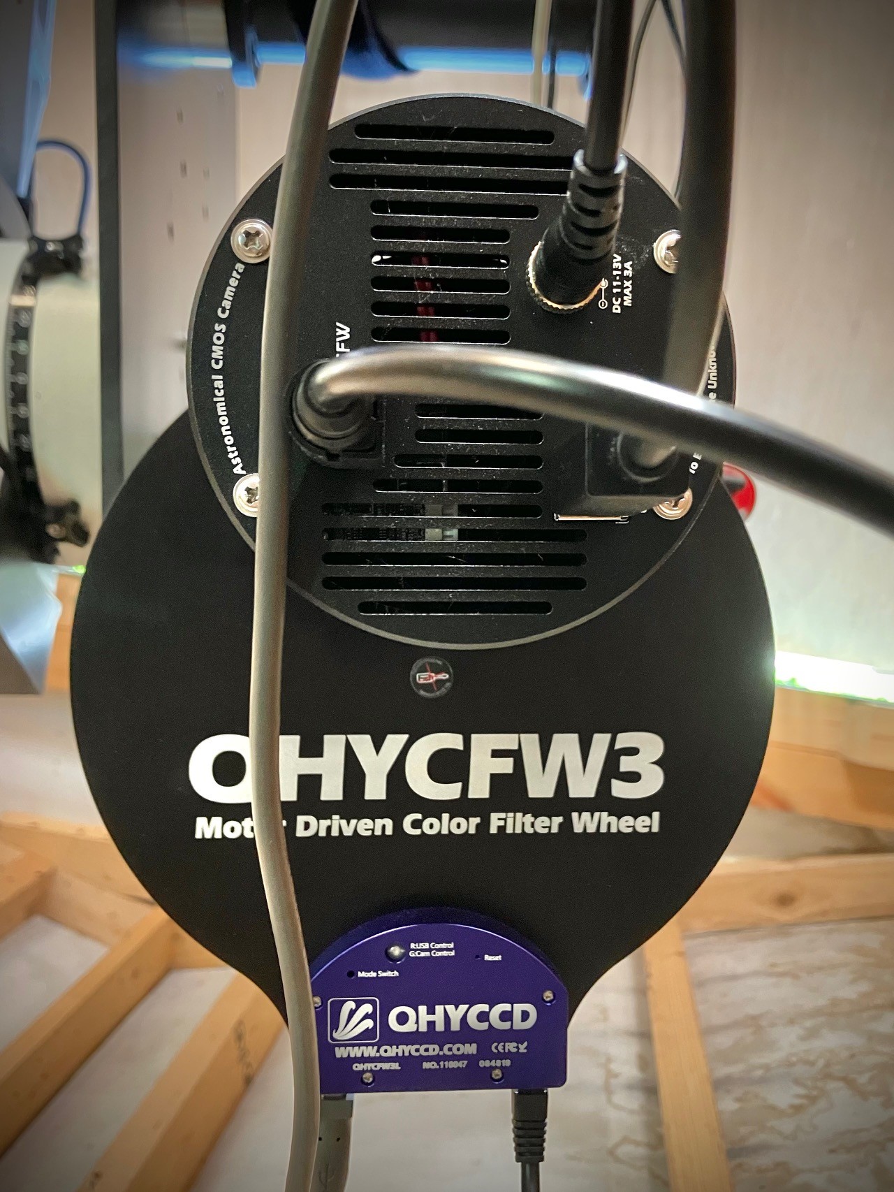

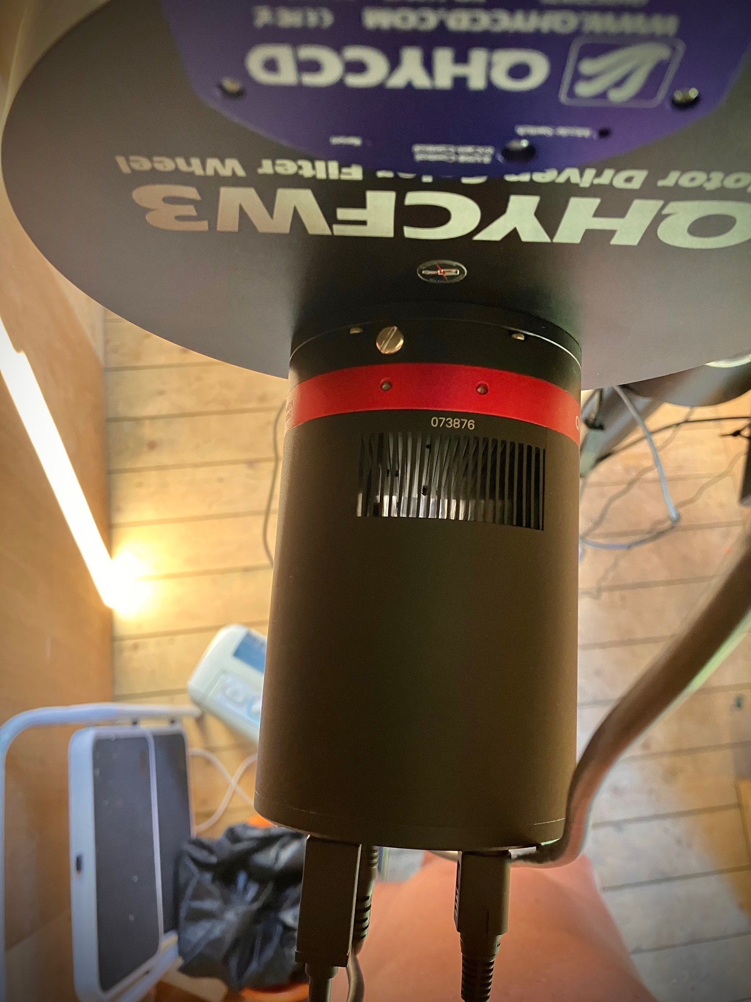

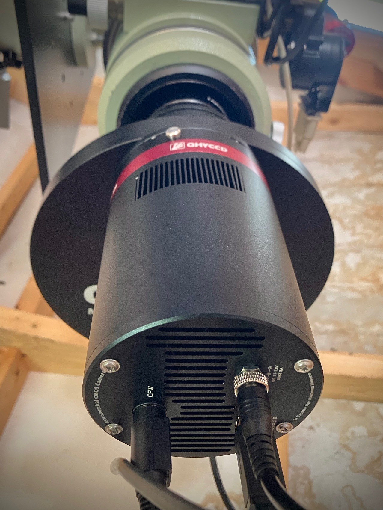

Just taken a few images of my QHY600 in the Obs. Mine is the SBFL.
Originally I got installed it upside down, well 180° plate solve
To summarise, for 0° plate solve the QHYCCD logo is the 'top' in landscape mode. Also the Chrome dessicant screw is upper. EFW port is to the left.
Hope this helps :-)

Thanks for the pics, Nigel!

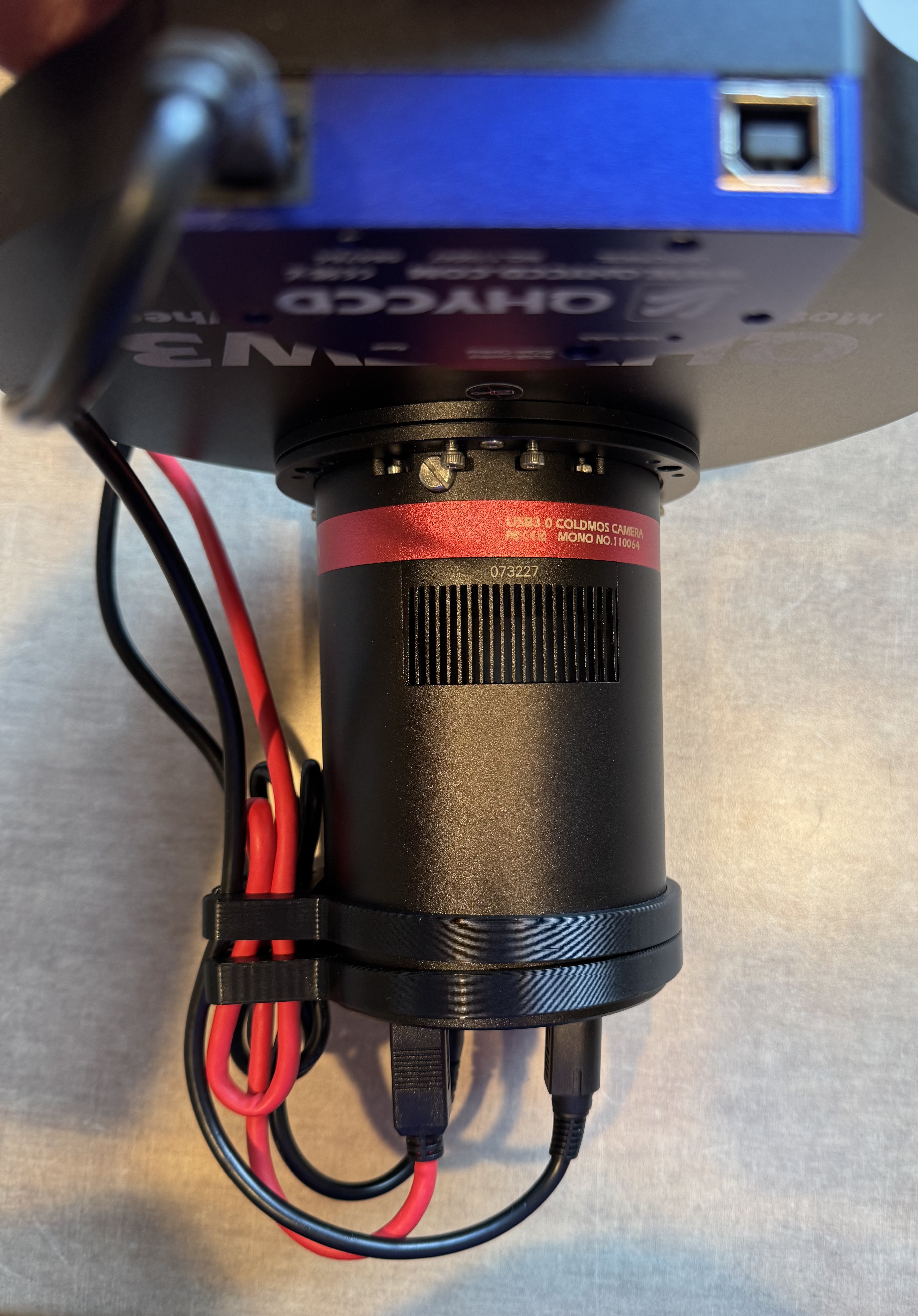

I also have a SBFL, but my camera has an inverted appearance compared to yours. I’m guessing that QHYCCD changed the orientation of the housing at some point.
I believe mine is upside down. This photo is looking from the “bottom” and I think it needs to be rotated to the “top”.
I’m going to reinstall it rotated 180°, with the screw for the desiccant port facing “up”. This will put the CFW port on the right side (when looking from the back), and the serial number “up”. I’ll the plate solve and see if I get 0°.

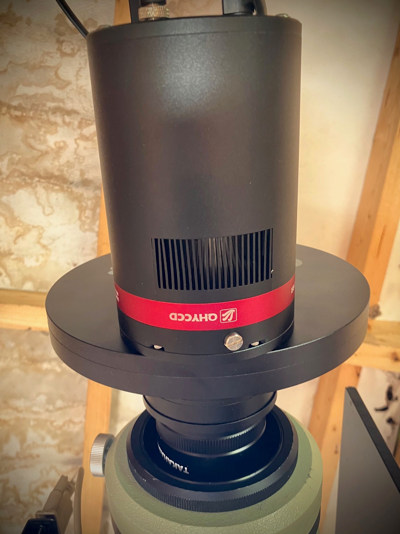

Here's a photo of the 'underside' of my camera for completion
Nigel, do images plate solve correctly in that configuration?  If so, then I’ll leave mine set as is (which is how yours is in the above photo). I think what’s been confusing me is that my camera has one screw for the desiccant tube (adjacent to the serial number), and yours has two. Plate solving an image would tell me right away, but it’s been so cloudy here I haven’t had a chance.

Yes, the configuration in the last image solved at 0.39° on NGC7000 last night.
Looks like you might be okay :-)
