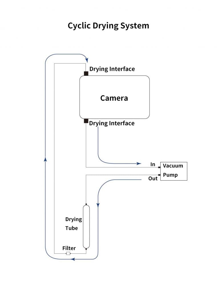

Did you fill up and install the desiccant tube into the side port on the camera? This is there to help in case you are having dew issues with the camera.
Hi Bill, thanks for responding.
I haven't been able to do it, since on the QHY website, it says that you have to use a vacuum pump, and I don't know where to get it from or how to connect it.
bdm201170 8.64
There should be a metal tube in the box. You fill that with desiccant and screw it into the port on the side of the camera that is currently covered with a screw. You might want to put some cotton in the tube first to prevent any possible spillage into the chamber.
And the vacuum pump?
darkmattersastro 11.95
I know nothing about the vacuum pump. The tube can be used on it's own.
