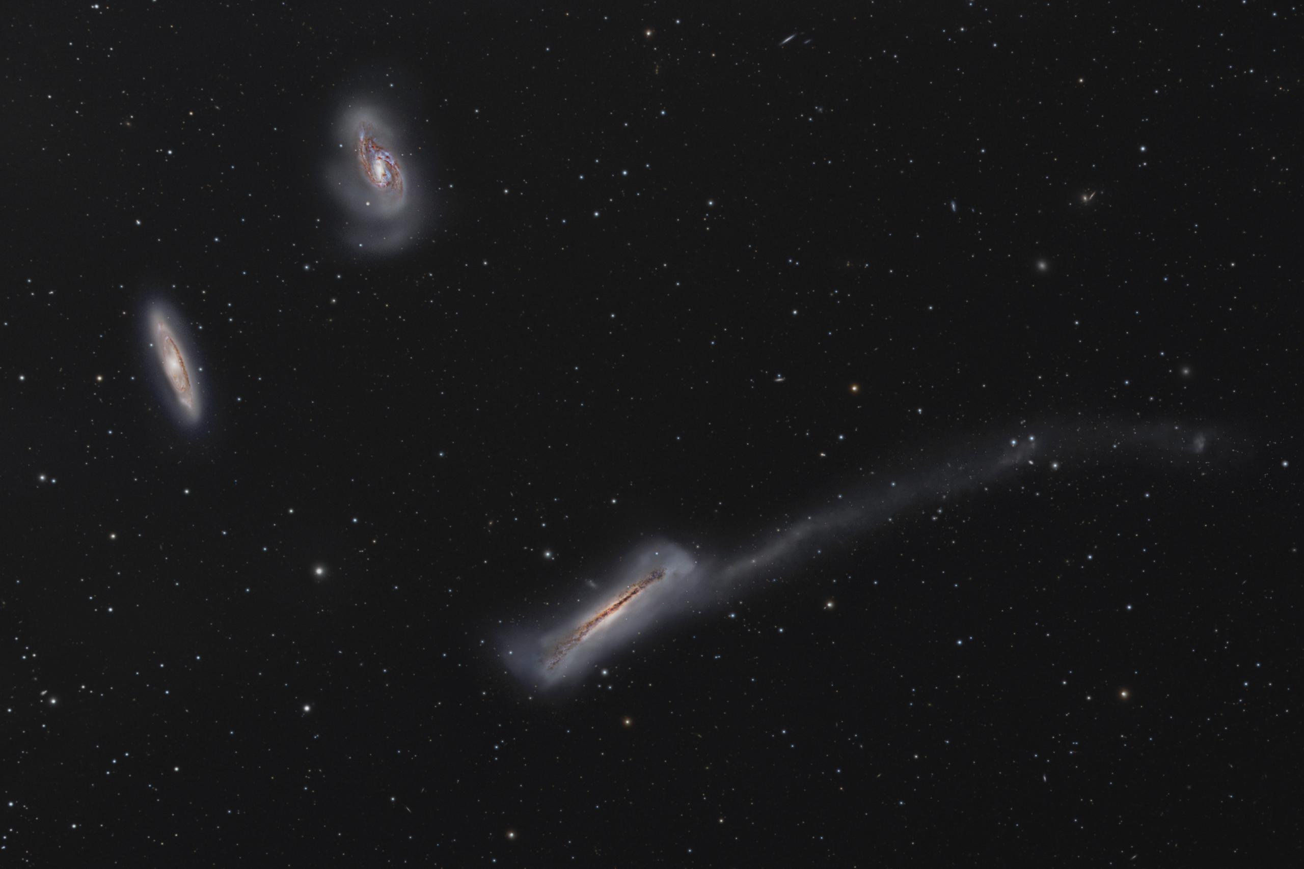

WhooptieDo 10.40
Hey Georg,
Andrea pretty much answered your question, but I did want to add:    You should consider shooting longer exposures.   You're at F/6.4 according to the image details, which is a bit on the slower side, but not horrible.   I'd recommend shooting 5 minute or more.   Bortle 4 is a respectable sky condition, I shoot from the same.   You should have no issue capturing the faint details.   Take a few test exposures to make sure your galaxies aren't blown out, but the depth on a camera like yours should be more than enough to handle 5 or 10 minute.  You will gain far more signal in a shorter amount of time.   The downside is building up enough images for rejection so plan accordingly.
The topic of exposure length comes up often, too many folks seem to live or die by a certain old 'exposure calculator/spreadsheet' that a certain individual came up with (that shall not be named).   I encourage you to push the boundaries.    And just to prove to some of those folks, I took a single, 1 hour exposure of Leo Triplet with my QHY268M and Esprit 100 at F/5.5
Some core details are blown, in the lower galaxies, but Hamburger as a whole is not blown at all.  And the entire tidal tail was captured in a single exposure.    This is an extreme case, for sure, and I only did it for science....     but too many folks kept argueing me that it would be a blown out, washed out image.
Anyways, try longer exposures

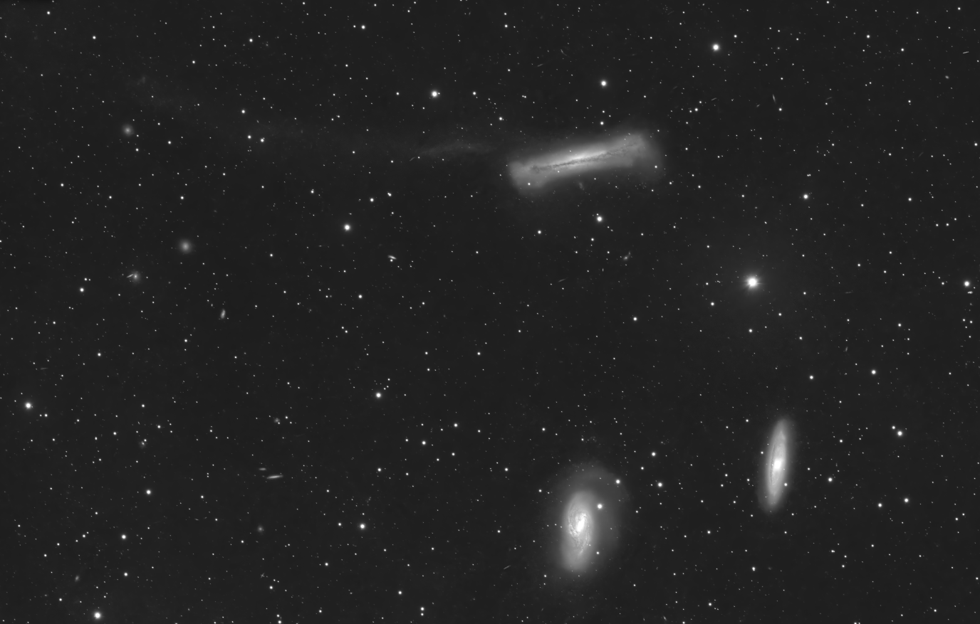

tonyhallas 1.81
Hi George,
    I would strongly concur with the above suggestion ... use longer exposures.   I go out to 20 minutes at f/7 when I want to record faint details ... I have made experiments to see if many short exposures are equal to longer exposures ... they're not.  Assuming you are doing some sort of averaging of your data with dithered exposures ... you benefit a lot with more depth to each exposure.  Conversely ... the average of crap ... is crap.
    I attached my Leo Trio using 2o minute subs RGB through an SVX 180 f/7.
      Best,

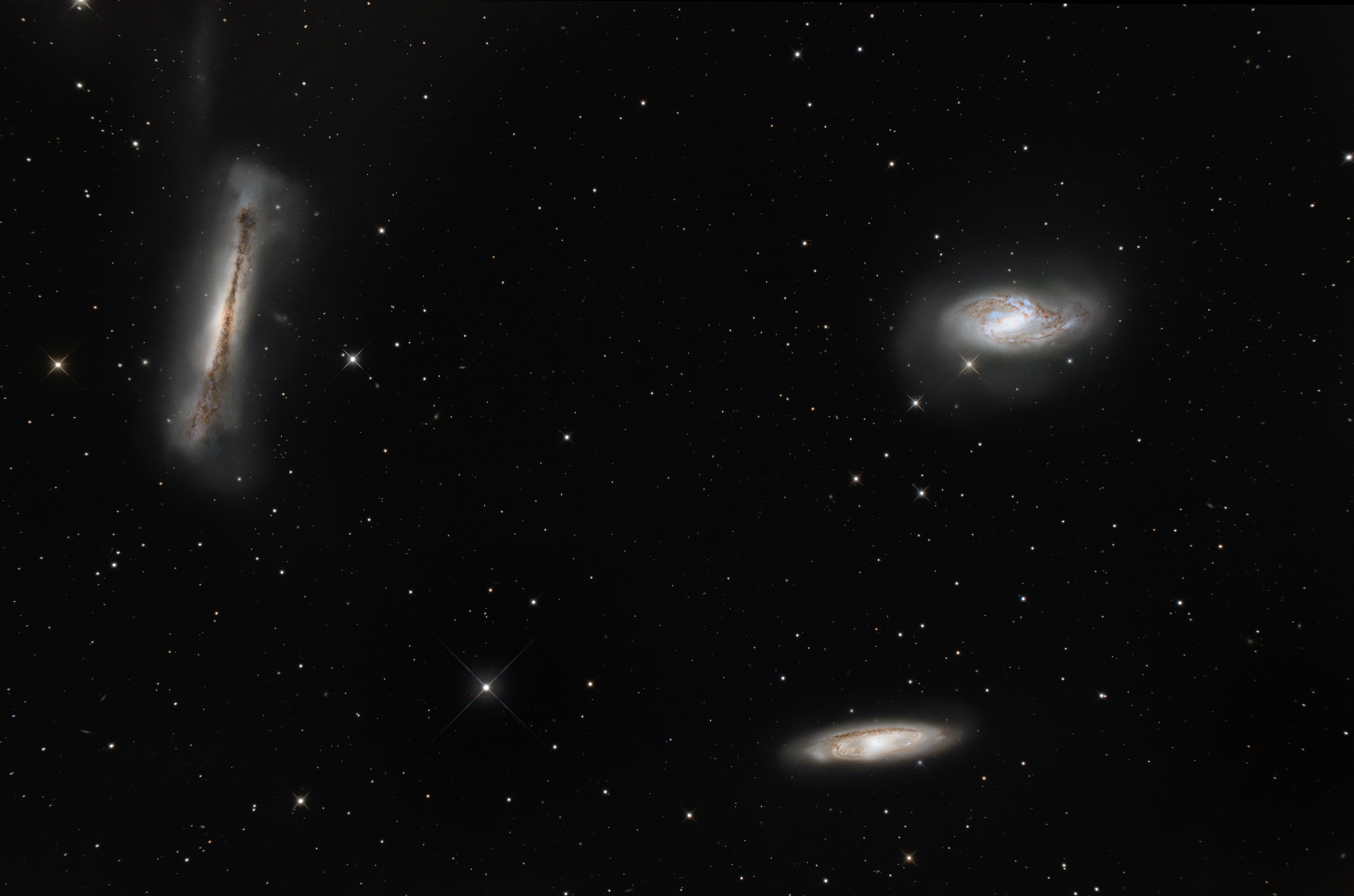

I processed the entire stack totally different - not in Siril with the precooked skripts but in PixInsight - here the result - much better, I think and even the faint dust trail is already almost visible...
Well, I learn every day something and regarding the longer exposure times for the subs, I shall definitely do it and get back with some results once the rain is over!
