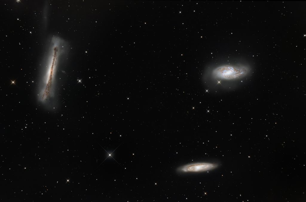

An offset is just a fixed DN added to the recorded image in order not to clip your black point. To verify it just take bias frame and see that no value is zero with your offset of 40 (which is what I use, by the way). That has nothing to do with not showing the faint dust tail of NGC3628, as long as you are not clipping you black point. I barely, just barely, captured it on this very poor image of mine with very humble equipment (80mm f/7.5 refractor with a DSLR) with a B7 site, so you must certainly be able to pick it up. Leo Triplet (M65, M66 & NGC3628) RGB (OSC) - AstroBin |

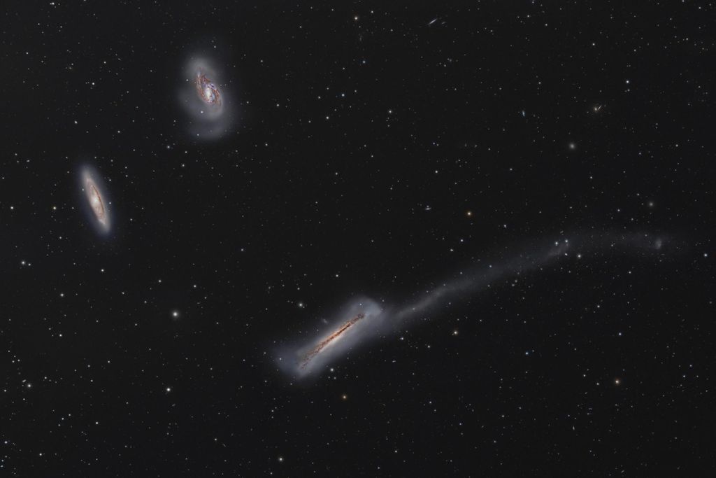

Hey Georg, Andrea pretty much answered your question, but I did want to add: You should consider shooting longer exposures. You're at F/6.4 according to the image details, which is a bit on the slower side, but not horrible. I'd recommend shooting 5 minute or more. Bortle 4 is a respectable sky condition, I shoot from the same. You should have no issue capturing the faint details. Take a few test exposures to make sure your galaxies aren't blown out, but the depth on a camera like yours should be more than enough to handle 5 or 10 minute. You will gain far more signal in a shorter amount of time. The downside is building up enough images for rejection so plan accordingly. The topic of exposure length comes up often, too many folks seem to live or die by a certain old 'exposure calculator/spreadsheet' that a certain individual came up with (that shall not be named). I encourage you to push the boundaries. And just to prove to some of those folks, I took a single, 1 hour exposure of Leo Triplet with my QHY268M and Esprit 100 at F/5.5  Some core details are blown, in the lower galaxies, but Hamburger as a whole is not blown at all. And the entire tidal tail was captured in a single exposure. This is an extreme case, for sure, and I only did it for science.... but too many folks kept argueing me that it would be a blown out, washed out image. Anyways, try longer exposures  |
Brian Puhl: Hey Georg,
Anyways, try longer exposures  Exposing to the Right of the histogram is the same in any photography discipline. I shoot in Bortle 8 and do 10 minutes routinely. If the whites are not blown, shoot as long as you can.

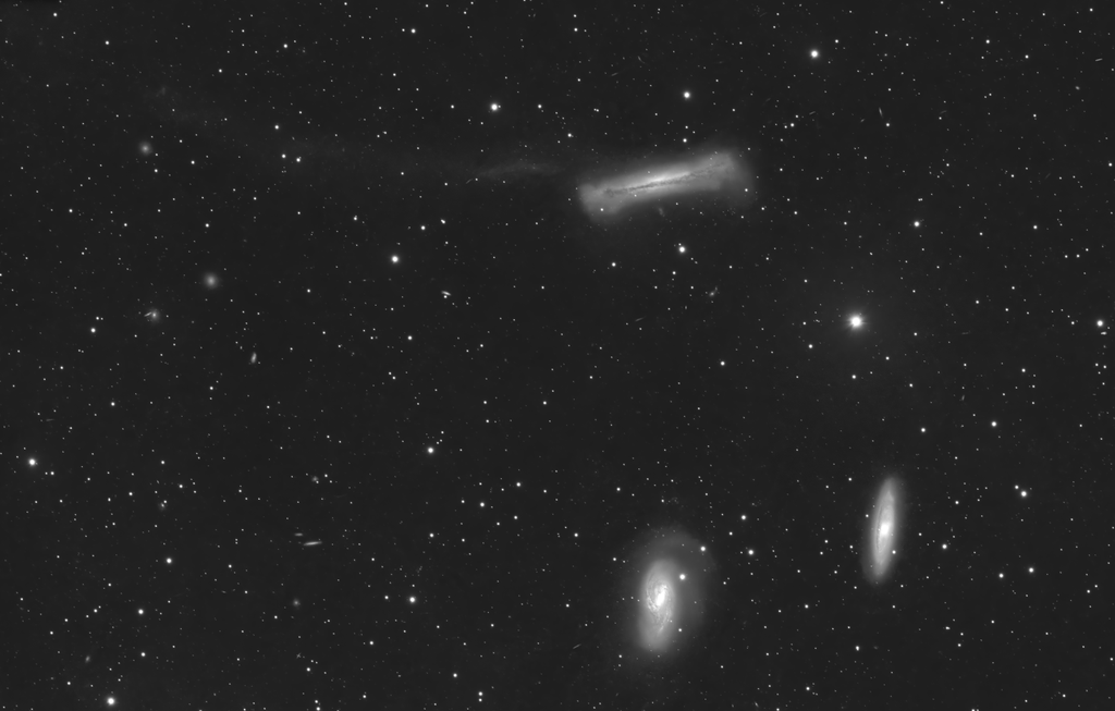

Hi George, I would strongly concur with the above suggestion ... use longer exposures. I go out to 20 minutes at f/7 when I want to record faint details ... I have made experiments to see if many short exposures are equal to longer exposures ... they're not. Assuming you are doing some sort of averaging of your data with dithered exposures ... you benefit a lot with more depth to each exposure. Conversely ... the average of crap ... is crap. I attached my Leo Trio using 2o minute subs RGB through an SVX 180 f/7. Best, Tony  |
