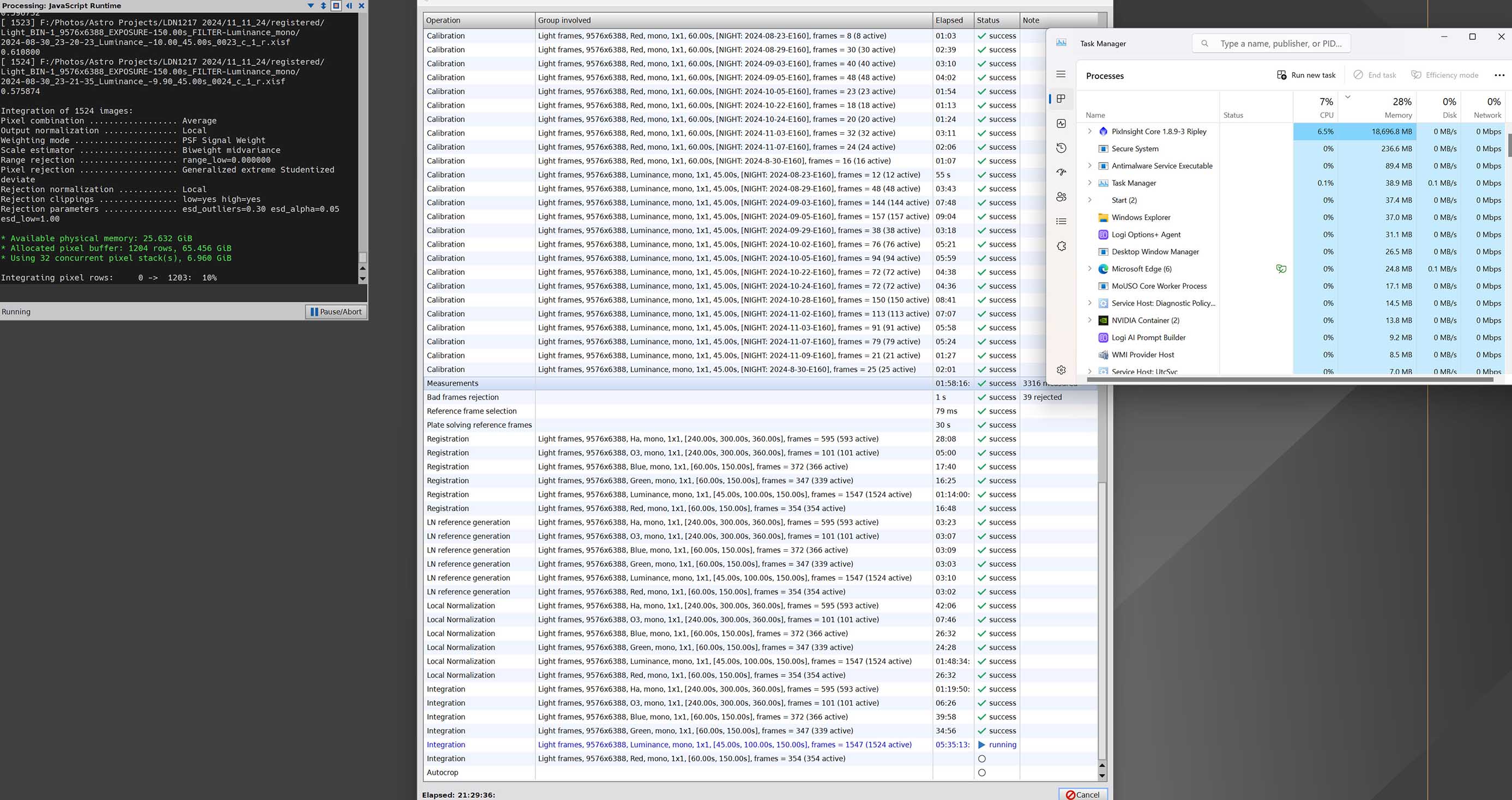

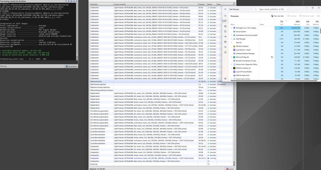

Hello all. I’ve just finished a large photo project, 102 hours. I also just built a new computer. I’m having an issue, WBPP won’t complete a stack of my 102 hours of data. It chugs along until it gets to the luminance integration and just stops proceeding. Task manager shows pixinsight using about 6% processor and 28-98% of ram but the status never advances from about 10%. This has happened twice now, the last time I waited 5 hours for some progress and then gave up and canceled WBPP, however pixinsight hung up at that point and I had to shut it down with task manager.Here are my computer specs, Ryzen 9950, 96 gig ram, 3 fast ssds, Windows 11 pro.Any help would be appreciated.

You have a large dataset and you are using LN and probably the ESD rejection algorithm. You can do a back-of-the-envelope calculation if 1547 9576 x 6388 XISF files can fit to RAM (even if you think 96 GB should suffice). And on top of that there is the memory footprint of the rejection algorithm used… plus the memory footprint of Local Normalization. You can switch off LN and choose a simpler rejection algorithm (Winsorized Sigma Clipping for example), or just use FastIntegration smile

I experienced a similar problem when stacked twice 1100 subs. I can advise you to restart the PC just before running the PI and WBPP and to avoid running anything else. Usually, I hibernate my system, but I found it ends with a much smaller amount of available RAM than I expected. I have 64GB RAM. Look at your screenshot, there is only 25(ish) GB RAM available!

Hi, have you checked the log that WBPP creates as it runs through its steps? It's in a sub folder of the WBPP folder where the images are being saved. There might be expanded data there on what exactly it is hanging up on. IMO if the CPU is just sitting at 7%, it is not thermal throttling, but WBPP just gave up/crashed at some point.

I just ran a small batch in WBPP and monitored my temps and task manager. The cpu is being utilized up to 100% and my ram was used up to 60%. The cpu cooler water temp kept rising for the first 10 minutes and after that my cpu temp reached 95c several times in 20 minutes. Do you think this could be an issue?

I don't think the temperature alone is the issue. Google "Ryzen 9950 95C", and the results show these chips are designed to hit that temperature and run fine. I have a 13700K, and even though benchmarks (Cinebench, 3DMark, etc.) don't get that hot, WBPP makes it ping at its limit of 100C during local normalization but it doesn't crash. I used to be concerned about the temperature, but research showed that modern CPUs are designed to hit these high temperatures without damage, they just thermally throttle unless you have an incredible liquid cooler. I am not familiar with your cooler, but if you expect better it might be worth making sure it's seated on the CPU properly.

I've run into this issue before. It's your pixel rejection algorithm. The Generalized Extreme Studentized pixel rejection will grind to a halt if you have too many images. Use any other pixel rejection method and you'll be able to process all in one go.
From the testing I've done, PixInsight will not utilize the CPU properly when using GES if the number of frames is too large.
