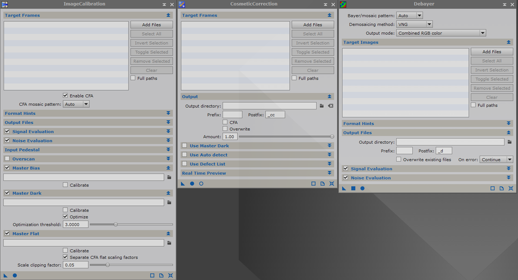

They can all be found in the Process<Preprocessing> submenu. To fill in the field I suggest you spend some time reading about them here:

In that order. Then:

michaelbroyles 0.00
Anthony,
The debayer process is what splits the calibrated, cosmetic corrected files into separate R, G, B files.  WBPP handles this automatically if the told it to split into separate RGB files.  There a advantages to splitting to get better star alignment of the individual channels.  I normally processed all my color camera data  by splitting the channel and recombining.
Andrea is correct that it makes no sense for you to Drizzle final data, if your not dithering during acquisition and your data is not under sampled.  Drizzle works best with dithered under sampled data.
You haven't really provided any information about when the frames are be rejected.  Are they being rejected in image registration or image integration.  If image registration is failing try adjusting the Image Registration parameters to get more of your individual frame accepted.
If images are being rejected during Image Integration, the Minimum Weight may be too high for you data.  Setting this value to zero will eliminate  Image Integration rejection that are caused by excessive PSF variations between you individual frames.
Unfortunately, the only way that you can determine your total integration time of you image is by knowing how many frames were actually integrated and calculating this time.  WBPP will provide the total integration time of all the frames but this number is not adjusted if frames are rejected during later in the process.

Michael Broyles:
Anthony,

There are a couple of places to find the number of rejected frames... If they are rejected before registration- you can literally go into your registered folder and count the number of frames there... these should be the successful ones. The execution monitor shows the information. The History in the headers of integrated images I believe shows the number of files used as well.
Concerning the tolerance of star quality. There is now a new method in PixInsight which you need to tune. There is a "minimum structure" size that affects the size it will accept as stars. You can also adjust the star "Distortion" parameter so that your elongated stars will be detected as real star sources. You can find these in the registration (Star ALignment) setup.
These two parameters (and maybe the SNR parameter) should allow you to use any star quality you have.
-adam

I'm not exactly sure where I might find those settings, and are they only in the newest update, which I didn't do cause I still use the EZ suite of scripts. I may update though if those setting are in the newest version. I know they also just posted even a newer update because of some bugs or something. I'm not seeing the setting in WBPP, but again they may only be in the newest update. I'm on the one that was just before the update last month. And I can't tell you enough how much I appreciate your help, you are my PI guru. ;) version that I have 1.8.9-1 I don't usually jump right on an update, I give it a couple of months.
michaelbroyles 0.00
Anthony,
The setting for Star Alignment can be found in WBPP on the Lights tab.  On the right hand panel Image Registration-> Registration parameters.  The Image Integration->Integration parameters is where you can find the Minimum weight setting.
Michael

I did and no not helpful. Reason being, with WBPP splitting one file into 3 channels RGB then calibrating and registering them as separate images it was giving different amount of rejected frames for each channel. So that’s my query. If I had taken a light sub through an R, B, G filter I’d have around 150 images per filter. Then rejecting frames would make sense. I’d know how many I had left in each channel. But splitting one file into three and then doing it’s thing and then recombining them I have no idea how many it rejected total. That’s what I’m looking for. What the final RGB image was the result of and what the integration time of that one file was. I get all the masters, one for red, cropped and not cropped, blue same, green same then I get drizzled files for each channel then I get an RGB image autocrop and not cropped. Bunch of finished files but no info. I guess I could take each channel subtract the number of rejected files and then total what’s left I might have an idea. For that I need to know did WBPP when it split each file into RGB did the total file count still be the same or was it divided by three or multiples by 3. See my problem. If I took 150 40sec images through each filter I’d start with 450 40sec images, and if it told me it rejected say 40, 65, 54 files respectively in each channel then because I started with 450 images, 150 for each channel, I could do the math because I would have a set number of images to start with, but with WBPP splitting each of 400 40sec images into 3 channels, do I have 1200 total images or just 400 or is it 400 divided by 3 and if that’s the case is the time divided by 3. Complicated isn’t it. And if I still only have 400 40sec images how many am I left with after it rejects images in each channel. I don’t know how to figure it. And in answer to your question, no they haven’t. Adam came the closes but I deleted those images and WBPP creates so many images after each process I don’t really have a clue which ones it’s using for the final stack. This has gotten way more complicated than I originally thought. Never doing that again, at least for images shot through my DSLR. If I seem to ramble it’s because I was up last night till 4 in the morning adding data to my IC5146 image so I’m very tired. Thanks to everyone who has replied. I appreciate the info on the other topics for sure.
michaelbroyles 0.00
Anthony,
Let me see if I can explain:
1) WBPP will split your RAW RGB images into separate R, G, and B file.  If you have 400 RAW file, you will have 400 R, 400 G, and 400 B files for a total of 1200 files.  If none of these files are rejected by WBPP and they are each 40 sec, your total integration time will be 400 * 40s = 16000s or 4.45 hours.
2) If WBPP Image Registration fail to being unable to file align some stars, registration files will not be generated by WBPP and these images will need to be subtracted from the image count.  So if R rejected 10 files, G reject 10 files, and B rejected 20 files the total integration time will be 400 - 40 = 360 * 40s = 14400s or 4 hours.
3) Image Integration now only has 360 files to integrate.  However, Image Integration may also reject files if the calculated weight of the file is lower than Minimum weigh value.  Let say that once again 10 R files are rejected, 10 G files are rejected, and 20 B files are rejected.  This means that the total integration time is not 360 - 40 = 320 * 40s = 12800s or 3.55 hours.
As Adam indicated, you can determine the number of images reject by image registration by counting registration XISF files that were created by WBPP of the pipeline will so the number of active images for each channel during the next step in the pipeline.
Images rejected during integration base of the weight is a little harder to determine.  But the process logs contain detail information stating the number of files integrated, so check the logs.  You can also count the number of XDRZ files that were update by the image integration.
The total integration time for RAW Color data the total number of split files divided by 3.  In other words, if you with 400 files, after splitting you have 1200 R, B, G files but the total integration is 1200 / 3 = 400 files.  This is because the RAW color data was capture is a single exposure unlike Mono images which acquire data in three separate exposure for each filter.
Hope this answers your question.
Michael
