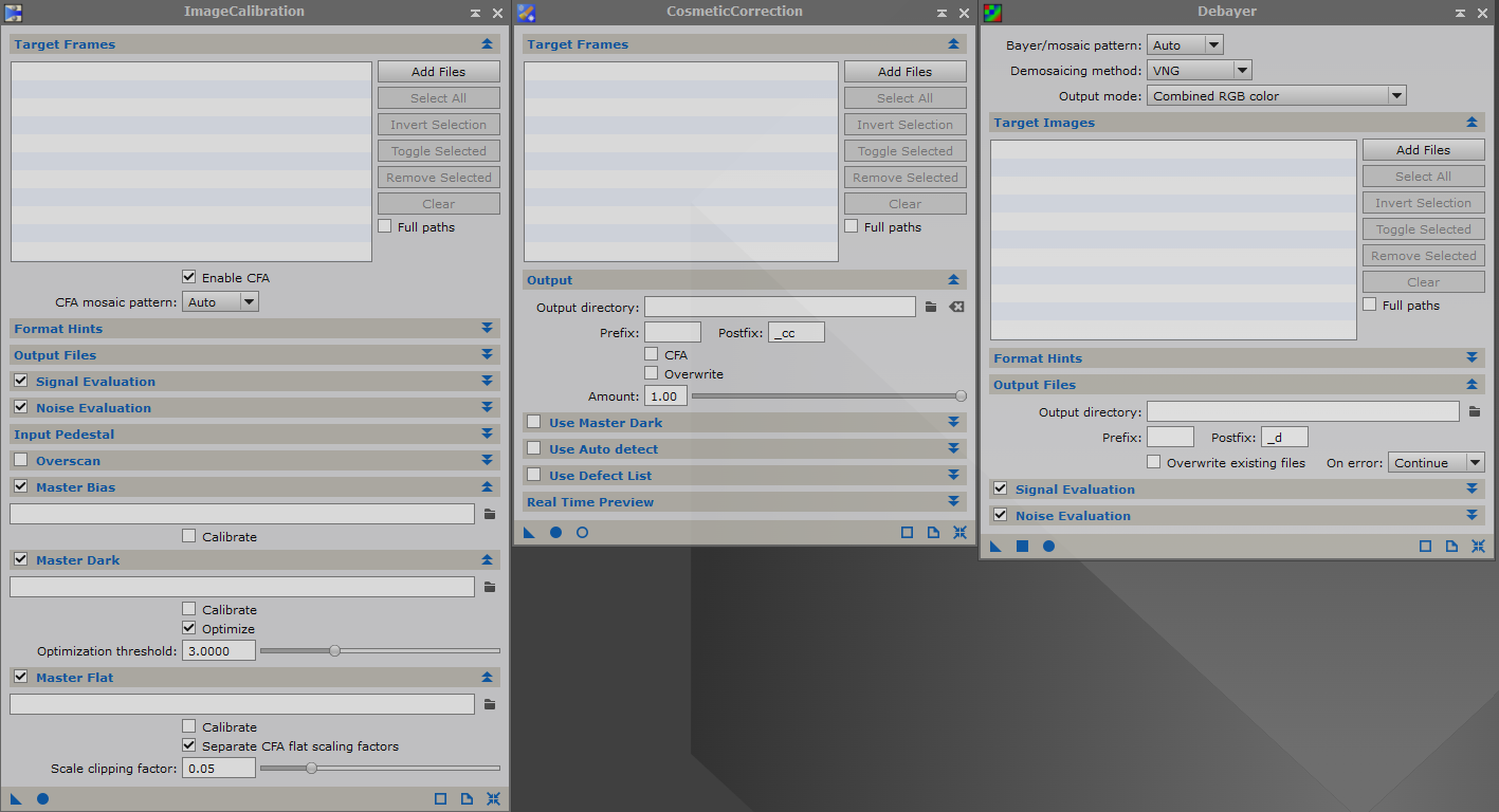

Anthony,
The debayer process is what splits the calibrated, cosmetic corrected files into separate R, G, B files. WBPP handles this automatically if the told it to split into separate RGB files. There a advantages to splitting to get better star alignment of the individual channels. I normally processed all my color camera data by splitting the channel and recombining.
Andrea is correct that it makes no sense for you to Drizzle final data, if your not dithering during acquisition and your data is not under sampled. Drizzle works best with dithered under sampled data.
You haven't really provided any information about when the frames are be rejected. Are they being rejected in image registration or image integration. If image registration is failing try adjusting the Image Registration parameters to get more of your individual frame accepted.
If images are being rejected during Image Integration, the Minimum Weight may be too high for you data. Setting this value to zero will eliminate Image Integration rejection that are caused by excessive PSF variations between you individual frames.
Unfortunately, the only way that you can determine your total integration time of you image is by knowing how many frames were actually integrated and calculating this time. WBPP will provide the total integration time of all the frames but this number is not adjusted if frames are rejected during later in the process.
Hope this helps, Michael

Anthony,
Let me see if I can explain:
1) WBPP will split your RAW RGB images into separate R, G, and B file. If you have 400 RAW file, you will have 400 R, 400 G, and 400 B files for a total of 1200 files. If none of these files are rejected by WBPP and they are each 40 sec, your total integration time will be 400 * 40s = 16000s or 4.45 hours.
2) If WBPP Image Registration fail to being unable to file align some stars, registration files will not be generated by WBPP and these images will need to be subtracted from the image count. So if R rejected 10 files, G reject 10 files, and B rejected 20 files the total integration time will be 400 - 40 = 360 * 40s = 14400s or 4 hours.
3) Image Integration now only has 360 files to integrate. However, Image Integration may also reject files if the calculated weight of the file is lower than Minimum weigh value. Let say that once again 10 R files are rejected, 10 G files are rejected, and 20 B files are rejected. This means that the total integration time is not 360 - 40 = 320 * 40s = 12800s or 3.55 hours.
As Adam indicated, you can determine the number of images reject by image registration by counting registration XISF files that were created by WBPP of the pipeline will so the number of active images for each channel during the next step in the pipeline.
Images rejected during integration base of the weight is a little harder to determine. But the process logs contain detail information stating the number of files integrated, so check the logs. You can also count the number of XDRZ files that were update by the image integration.
The total integration time for RAW Color data the total number of split files divided by 3. In other words, if you with 400 files, after splitting you have 1200 R, B, G files but the total integration is 1200 / 3 = 400 files. This is because the RAW color data was capture is a single exposure unlike Mono images which acquire data in three separate exposure for each filter.
Hope this answers your question.
