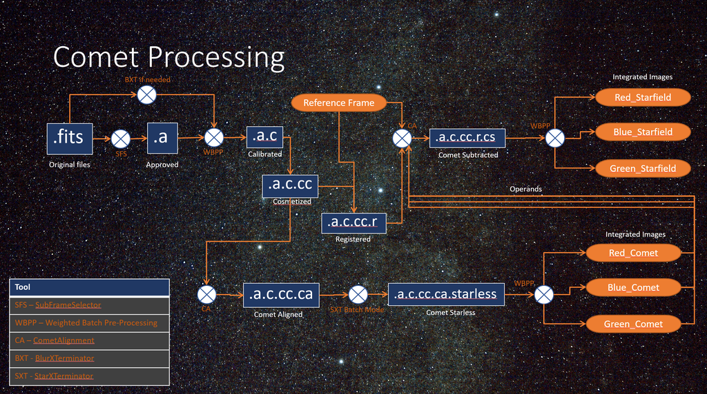

where in the process are these star trails being introduced? Are they an artifact left over in the comet-only images after star removal? Or are they coming from the star field images? Or are they there in the original files?
How many subexposures do you have.....LRGB or OSC?
You shouldn't need to use clonestamp for this - I think this is a processing issue.
Is this the process you are following? Comet Subtraction for the star field seems to work better than StarXTerminator IMO. If you use comet subtraction, then don't forget to add the WBPP registration reference frame into the CometAlignment file list. In my diagram below once you have created the integrated images for stars and comet, it's pretty much a regular RGB integration process after that.
