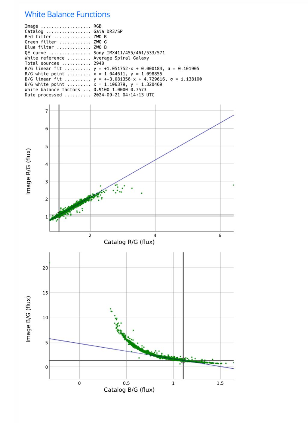

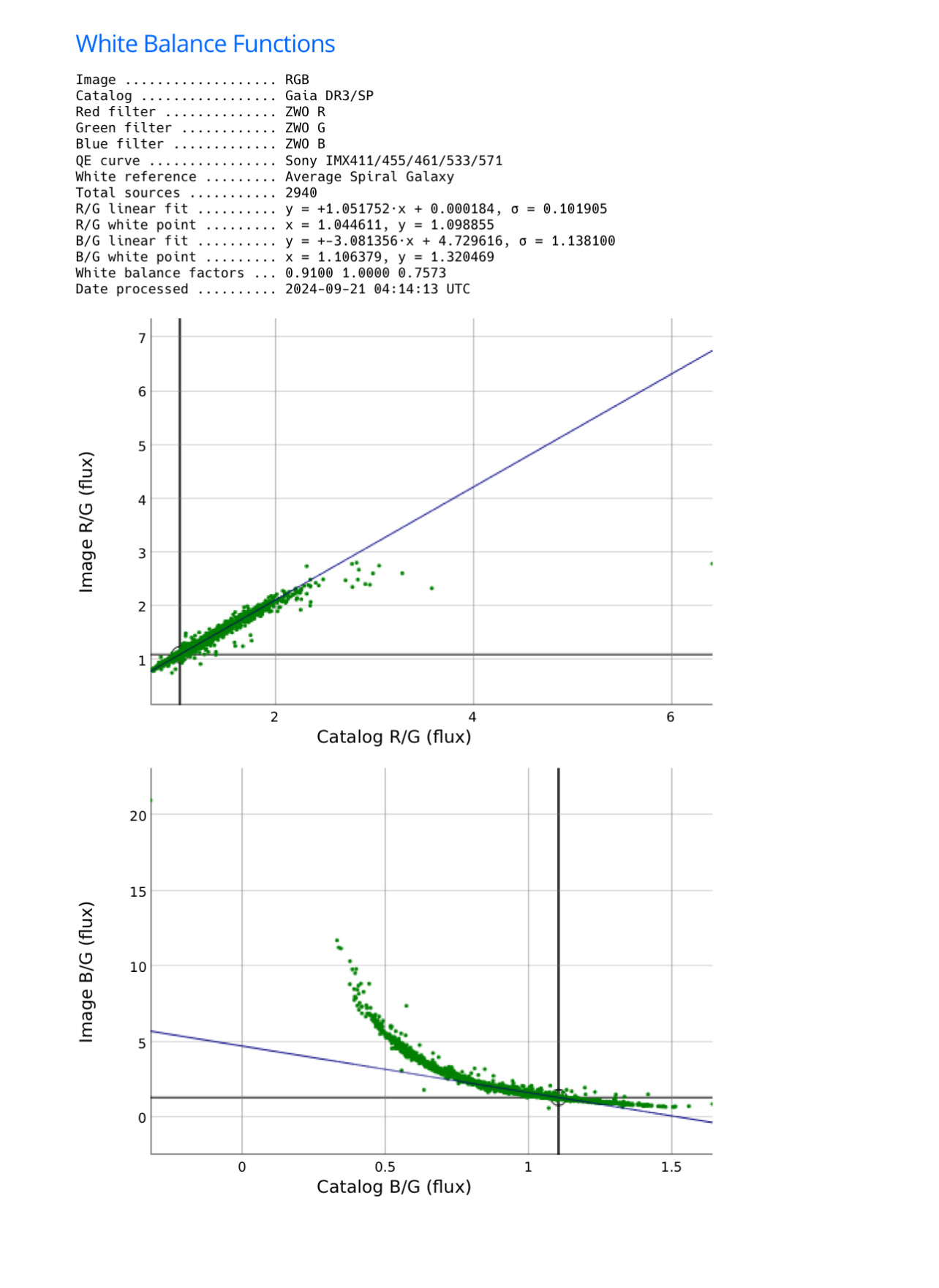

After running SPCCon Pixinsight, my combined RGB image is coming up purple-ish with some strong magenta stars, but not all stars have this color.   Some are yellow and some white and blue, as well.
The graph result shows this:
I generally understand from tutorials that both graphs should, in theory, show a linear trend, but my B/G chart looks a little wonky and doesn’t quite follow that linear path.
Any idea what’s happening / why I’m getting these results and what I can do to improve the color calibration process?

Your Blue/Green is very strange. Pretty sure slope shouldn't be negative. Here is a recent run of mine that I happened to have saved. ASI533MM and Antlia R/G/B filters. Didn't save a screenshot, but both graphs cluster on the line like your Red/Green.

Maybe you have a bad gradient or other artifact in your Blue channel? Don't know how you got a negative slope, though. Something went wrong in WBPP? How does the blue image look by itself?

It looks to me like you may have got your filters mixed up. If you are using a filter wheel double check the filters are in the right slots. If you are changing filters manually check you have the right filter in the right box!  Your second graph is basically saying that as blue gets stronger relative to green in the actual star your image has blue getting weaker relative to green. The non linear shape is odd - have you used one of your NB filters by mistake?

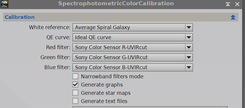

Thanks to all for replying so quickly!
White reference:  average spiral galaxy
qe curve:  I chose the one specific to my camera - Sony IMX 455 sensor (I shoot with zwo 6200 MM pro)
red filter:  zwo R
green filter:  zwo G
blue filter:  zwo B
narrowband filters:  unchecked
generate graphs:  checked
rest:  unchecked
I can try running again with ideal QE curve instead of my camera specific sensor, but if memory serves me correct I think I also tried that last night and still ended up with a similar graph showing massive B/G divergence.
