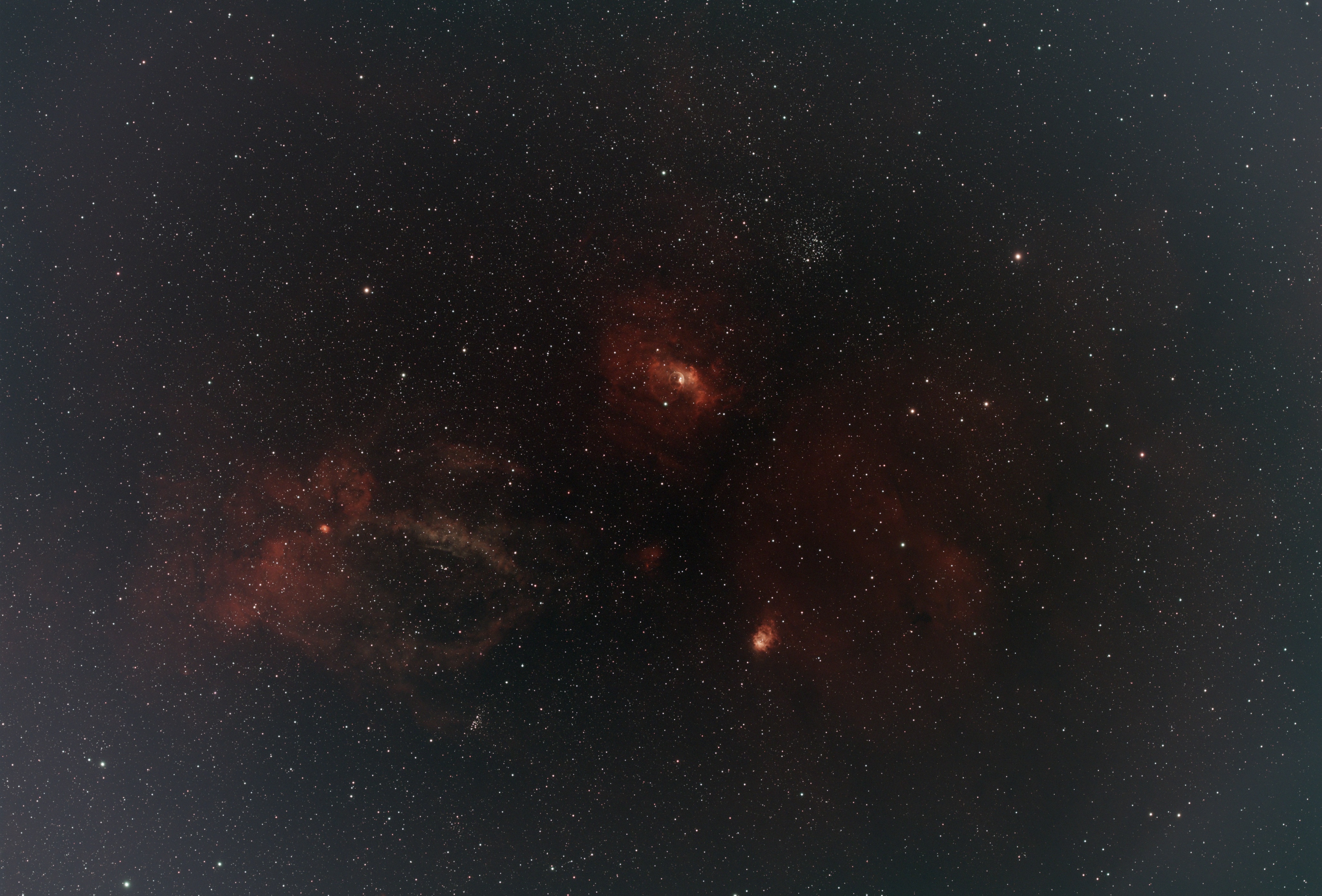

Issue: I receive the failure below when running WBPP. Results in what seems to be vignetting. The below image has had Graxpert, ABE, SPCC and stretched. Saved as jpg. I don't detect vignetting in the subs. Maybe my calibration frames are the problem.
masterLight_BIN_1_4144x2822_EXPOSURE_600_00s_FILTER_OPTU_RGB_autocrop_integration_autocrop_clone.jpg

I have had the same results with a 1600mmPro camera. My flats were the issue. I was taking very short duration flats (less than 1 sec). I dimmed my light source and expose between 5 and 10 sec flats. The levels were the same but it took longer to get there. Also are you normalizing your subs during the stacking process?
To verify, stack your lights without calibration frames and see if you have the same result…
To verify, stack your lights without calibration frames and see if you have the same result...
CS Tim
Good call! I stacked without the bias/flats... same result. Then I stacked without the darks/flats/bias, and although I had amp glow aplenty, I didn't have the vignetting. Found a masterdark used in a previous successful session and voila. Yep, using normalization. I am currently using sky flats for my OSC setup, so I have to whip them out pretty quickly to avoid a cloud changing the lighting. My mono setup is running NINA and I have a flat panel for it. Going to have to get the OSC rig on NINA.

Obviously these messages occur during calibration. They can be related to problematic calibration frames, but from time to time they appear even if the data is "good". To avoid these problems, you can set the offset for your camera. It adds some value to every pixel to ensure that the calculation results are not going to  be negative. If you use an offset, you may try to increase it a little bit. If you don't, just try it. If you are sure, you've done everything correctly, this may be the solution.
