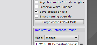

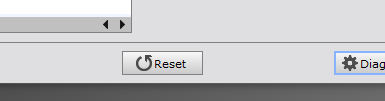

WhooptieDo 10.40
Try the reset and purge buttons, see if that helps.
