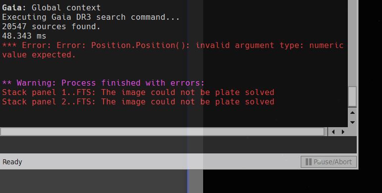

Now every time I want to plate solve the images, I get this error:
Every single time. I feel like I change every parameter that can be changed in the solver it always comes out to this.

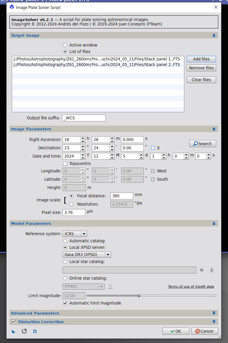

What is this error? how can I make it work? or are there other viable solutions on how to stitch panoramas together outside of Pixinsight?
I don't even know what it is trying to tell me

Shouldn't you check the box that says [ ] S(outh) ?
reggiej42 1.20
You may want to double check the coordinates you're using.  I show Rho Ophiuchi having RA = 16h 27' 3.43"  Dec = -23 deg 29' 21.2"
Per the previous comment, you may need to check the "S" box since the declination is negative.
I'm assuming your equipment focal length and camera pixel size is correct, but you should check those as well.  If you're using a focal reducer, that will affect the number you use for focal length.

Check fits header, there is some value not allowed ("Invalid argument type …").
You can always delete the fits header and regenerate it with plate solving (clone the file before).

Hello, I tend to plate solve one panel at a time.  I noticed that the date may be off as it shows 11/5/2024.
claytonostler 3.34
Michael Rushalko:
I'd bet this was supposed to be 5/11 instead of 11/5

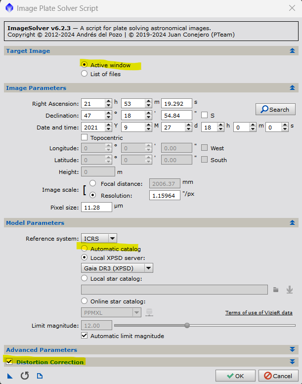

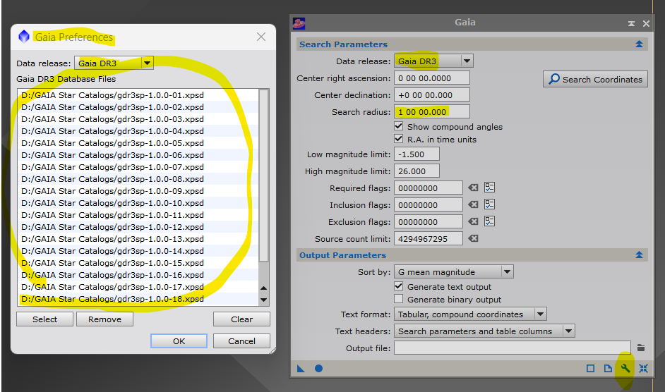

I use the PlateSolver script all the time to prep an image for SpectroPhotometricColorCalibration but I only use it for a single view at a time. You might want to try that but I did replicate your issue when you try to plate solve multiple images. See no reason why that shouldn't work as I could plate solve two images individually but when I tried them as a batch using list of files I get the same message you do. Think this is a bug in script.
Just the same I would make sure you have your parameters similar to my setup except of course for the image parameters. Make sure your GAIA Process parameters a correct and the DR3 files listed when you click on wrench icon. Yu can also increase the search radius as if your picking coordinates where your mosaic panels meet...especially at 300mm FL if that is what your using then you may want to increase this value to 2-3 degrees. Also, I found sometimes using "Automatic Catalog" works better than using local server. Always check distortion correction checkbox highlighted at bottom. My two cents...Good luck!

Just a tip.  When I have weird issues like this and I know my coordinates are right, I set my focal length to a little bit longer, or change my pixel scale to something a little bit tighter.  It usually works.
If I were you I'd solve one image at a time, however, particularly because it's a mosaic.   Also, Rho is definitely south of celestial equator, you need 'S' to be checked.    Validate the center position of each frame from your sequencer settings, or FITS header.   Solve accordingly.

So the "Active Window" feature does work better but I don't get the WCS file that I seemingly need for the next step. That is the whole reason I'm going through this, to get that platesolved wcs file I need for the Mosaic By Coodinates script. Thank you so much for showing this, and I'm glad I'm not the only one getting this error. On the Internet I can barely find anything about it.

I think you misunderstand…the WCS data is put into the Header of the Image file your plate solving and that is the data that the Mosaic by Coordinates script uses. There is not a separate file.
