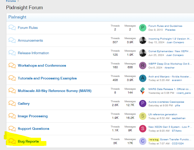

Regarding the problem you are raising, I have not been given the case but I think you should report this possible BUG to the PIXINSIGHT developers within the pix forum, I am sure you will receive a response regarding it.

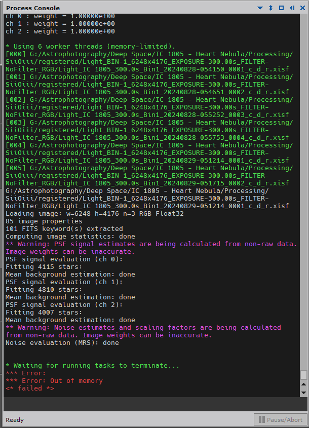

1. Looks like I don't have enough memory, at least for the HaOiii data (see #4 and screenshot below)
2. Looked at them in Blink. Looks like about half the data is super dark which I thought would have been an issue, but this didn't present any issues for the SiiOiii data, despite failing the first attempt.
3. No issues here
4. My SiiOiii data (193 frames) had no issues with ImageIntegration. My HaOiii data (271 frames) failed.
Is there a workaround for this? Or am I stuck using DSS until I get a new computer?

8 GBs is really few for PixInsight...I'm surprised you didn't have problems earlier, I have 16 and my Mac is close to dying every WBPP run.
You can look here and here for tips.
chroniclesofthecosmos 1.51
Thanks. Unfortunately my computer has soldered RAM, so I can't add more and a new computer is months away. But I'll try expanding the virtual memory.
Aside from WBPP/FBPP, PI works surprisingly well despite the lack of RAM.
