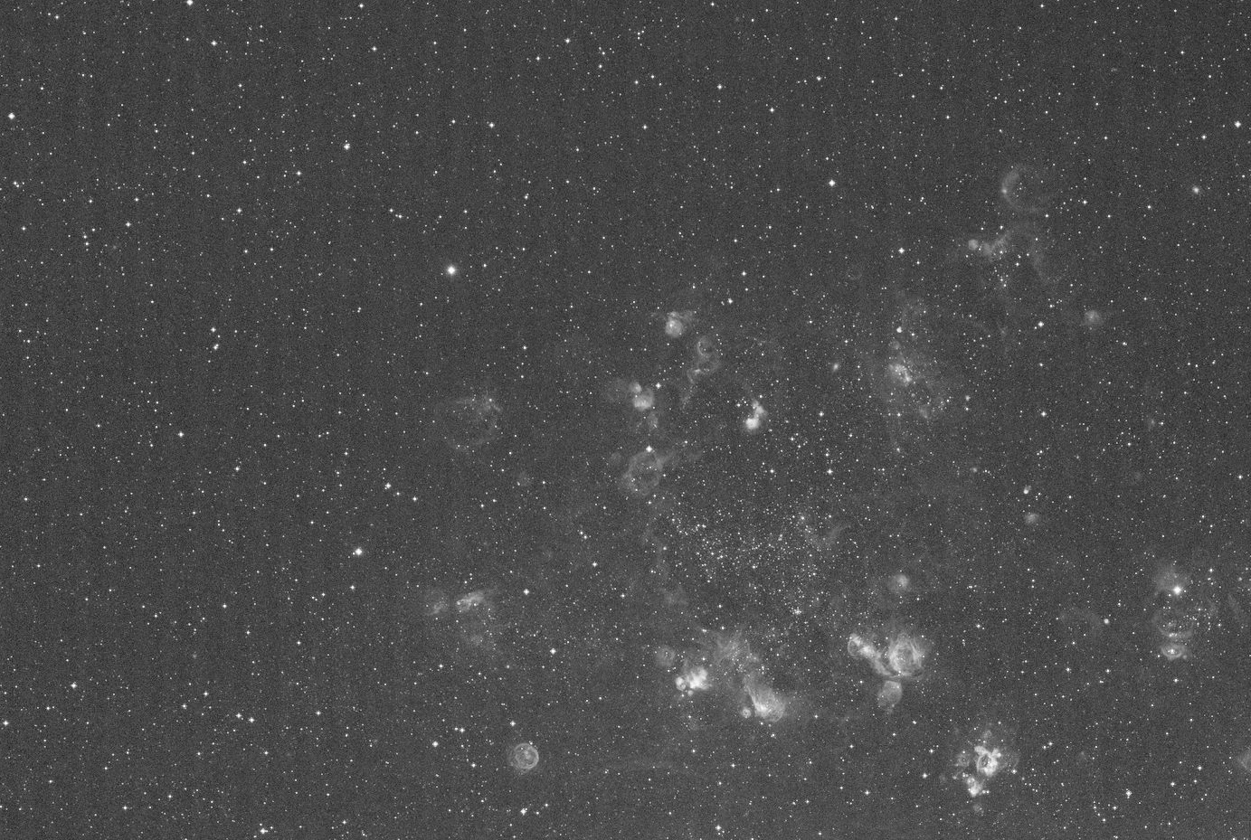

Okay...I have run into a wall and I cannot figure out why I am getting these bands in my integrated h-alpha light. It is not showing up on my broadband images - just my h-alpha. I have a sample posted below with and without stars.
I think it has to do with the calibration but I am not 100% certain. I have re-taken flats and darks and I still run into this issue. I am using WBPP with the defaults on registration and integration. I have tried different methods of registration and integration but the pattern is still present. This leads me to believe it has to do with the calibration. Any help would be appreciated.
Here is a link to Dropbox (Dropbox Link) with the master bias, dark and flat and the full size integrated file.
Images were taken with a STL-11000M CCD camera. I am stacking 20-180s H-alpha images. I've added 20 more and I still get the same pattern. I see some of that banding in the subframes which is another reason I think the calibration is not taking care of it and making it more prominent.

There is a fix you can Apply. Rotate the image so the pattern is horizontal. Then go to Scripts/Utilities/CanonBandingReduction and apply default options. As you see below I've edited your Ha image. Of course use ABE/DBE before or after because you might have problems with the gradient around the nebula.
You still have some linear pattern banding on the far right but that's something you can fix with Linear Defect detection and Cosmetic Correction. This will help: https://www.youtube.com/watch?v=YCIi8uBaXNM

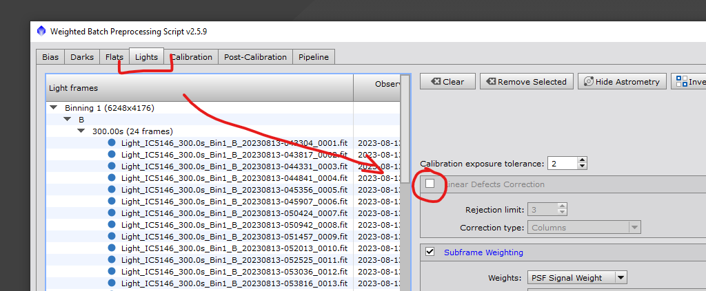

Davilovick 0.00
Neven Krcmarek:
I was facing similar issues in Pixinsight, and, as @Neven Krcmarek  said, it was caused by "Linear Defect detection" option in PixInsight (my thread in CN):
In my case, after disabling this feature, all issues were gone
NevenKrcmarek 0.00
David Ávila:
Yes, I think that option is turned off by default because it's reserved only for CCD cameras. But sometimes it does not get rid of all defects so PI has additional options to get rid of that nasty ones.
Scripts/PatternCorrection/LinearDefectDetection and LinearDefetcSubstraction and you can use the defect map in CosmicCorrection. That's how the guy from the YT video was able to get rid of the lines.
