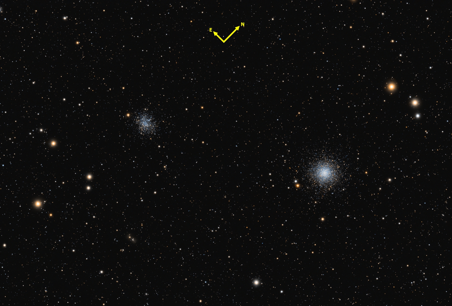

Hello everyone, I thought I'd share with you a new script that just come out about 3-4 weeks ago that allows you to add a North and or East arrow to your image in PixInsight. I had posted over on the PI's forum about whether PI had anything like that and a gentleman wrote one to do exactly that. I think its a very cool script. I know many of you use other means to add them but I thought it would be a handy thing to have in PI. I've uploaded a sample image with the arrows added AFTER IMAGE SOLVING! Here is the Repository URL for PI to use: https://www.cosmicphotons.com/pi-scripts/drawannotation/Once you installed the script you will find it under Script>Render>DrawAnnotaion. Once you start it there are many parameters that you can customize your arrows. For those of you that would like to see the actual thread on PI with more info on the script and its author, you can find it here. https://pixinsight.com/forum/index.php?threads/is-it-possible-to-add-north-in-annotation.23352/Full Disclosure, I'm not the author of the script or do I get anything from it. Its just a cool script that I thought others may like to know about. I hope some of you can find it useful. Thanks for reading! Dale  |

Call me a dope ~ I will not be offended, but isn't the "east" arrow (in the above image) pointing west?
Jay Hovnanian: Call me a dope ~ I will not be offended, but isn't the "east" arrow (in the above image) pointing west? Not really sure Jay I just ran the scrip after image solve and thats what come up. If thats the case then I’d want to bring that to the attention of the author of the script. And no I’d not call you a dope if that ends up being the case. Dale

Jay Hovnanian: Call me a dope ~ I will not be offended, but isn't the "east" arrow (in the above image) pointing west? I’m going to check on this in a bit. Need to make sure I did’t do something wrong on my end in the script. Dale
Jay Hovnanian: Call me a dope ~ I will not be offended, but isn't the "east" arrow (in the above image) pointing west? I think if you imagine looking up at the sky and seeing this image, the east arrow in the image is pointing east.

Jay Hovnanian: Call me a dope ~ I will not be offended, but isn't the "east" arrow (in the above image) pointing west? I think if you imagine looking up at the sky and seeing this image, the east arrow in the image is pointing east. Yes I think your right on this Tom. I just run it back through and it comes out the same. I think your correct you have to orientate North at zenith and its correct. Dale

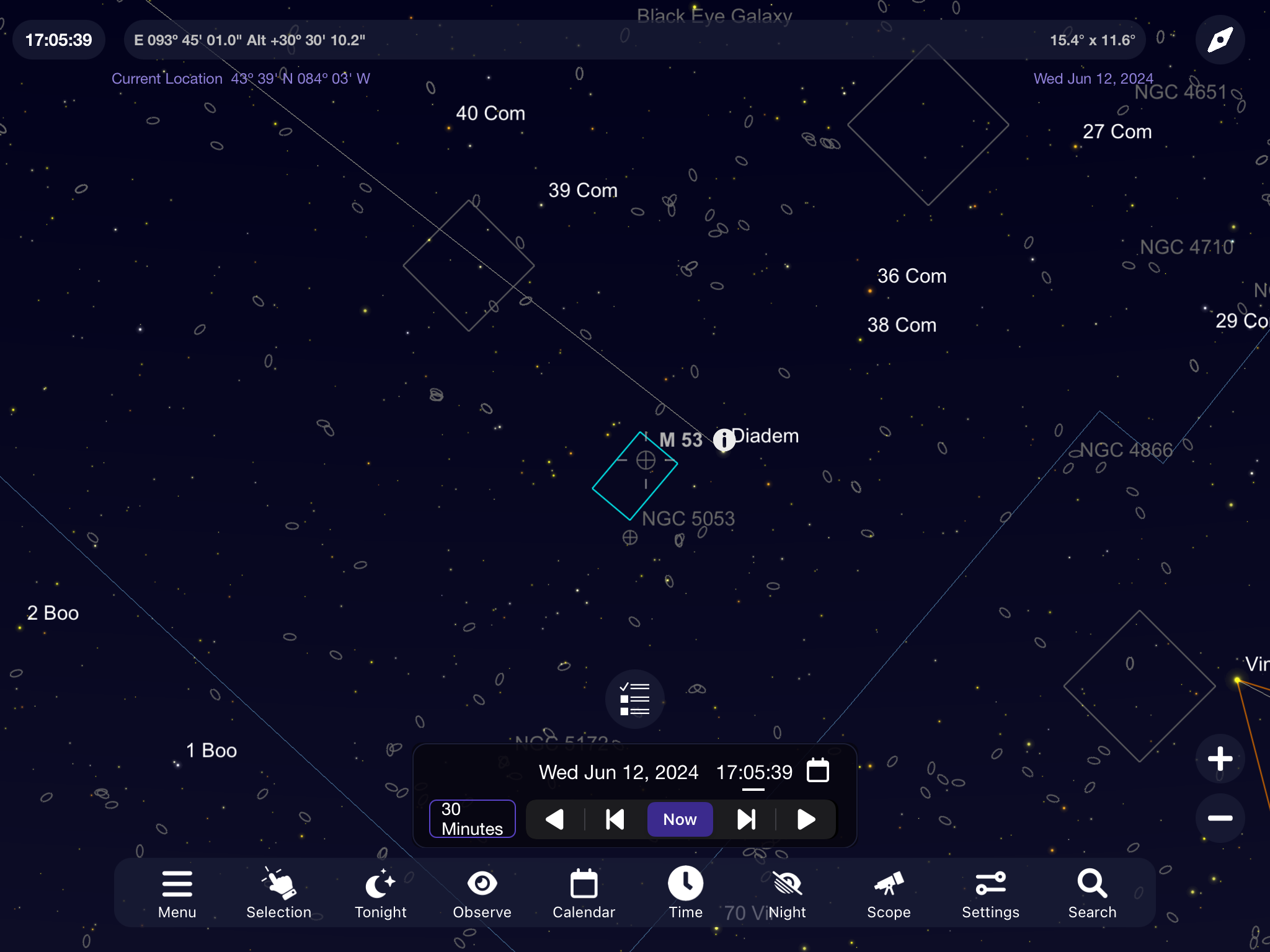

Dale Here is a screenshot from Sky Safari Pro of the field with the compass in the upper right corner.  |

Jay Hovnanian: Call me a dope ~ I will not be offended, but isn't the "east" arrow (in the above image) pointing west? I think if you imagine looking up at the sky and seeing this image, the east arrow in the image is pointing east. Tom is right: on the sky if North is up then East is Left.

And, yes, the E arrow is pointing correctly. We're used to looking at maps where we are looking down on the Earth. But to look into the sky, we have to turn our gaze through 180-deg., so that what was left, now becomes right! It's almost as non-intuitive as thinking 3-D spherical orientations.

Jay Hovnanian: Call me a dope ~ I will not be offended, but isn't the "east" arrow (in the above image) pointing west? Unless the image is mirrored.

Jay Hovnanian: Call me a dope ~ I will not be offended, but isn't the "east" arrow (in the above image) pointing west? Hi Jay, the arrows are in fact correct. The source of confusion is that we are dealing with two systems of coordinates: 1. the celestial equatorial for the sky, and 2. the local horizon (geographical, terrestrial) for earth orientation. When you are talking about directions in the sky, you use celestial equatorial coordinates, not the terrestrial geographical. In the sky you have by definition the north arrow pointing to the North Celestial Pole (not the Zenith!) and the east arrow points 90° left of north, wherever you are in the sky. If you happen look in direction of the geographical north, you have the celestial east arrow pointing to the terrestrial west, but you are talking two different things. Hope this helps. Ciao, Mau
