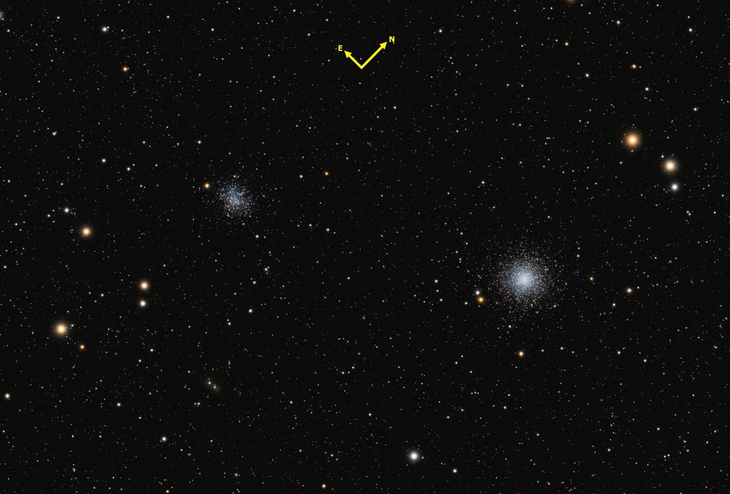

I've uploaded a sample image with the arrows added AFTER IMAGE SOLVING!

Call me a dope ~ I will not be offended, but isn't the "east" arrow (in the above image) pointing west?
DalePenkala 19.38
Jay Hovnanian:
Not really sure Jay I just ran the scrip after image solve and thats what come up. If thats the case then I’d want to bring that to the attention of the author of the script.
And no I’d not call you a dope if that ends up being the case.

tboyd1802 3.34
Jay Hovnanian:
I think if you imagine looking up at the sky and seeing this image, the east arrow in the image is pointing east.
Yes I think your right on this Tom. I just run it back through and it comes out the same. I think your correct you have to orientate North at zenith and its correct.

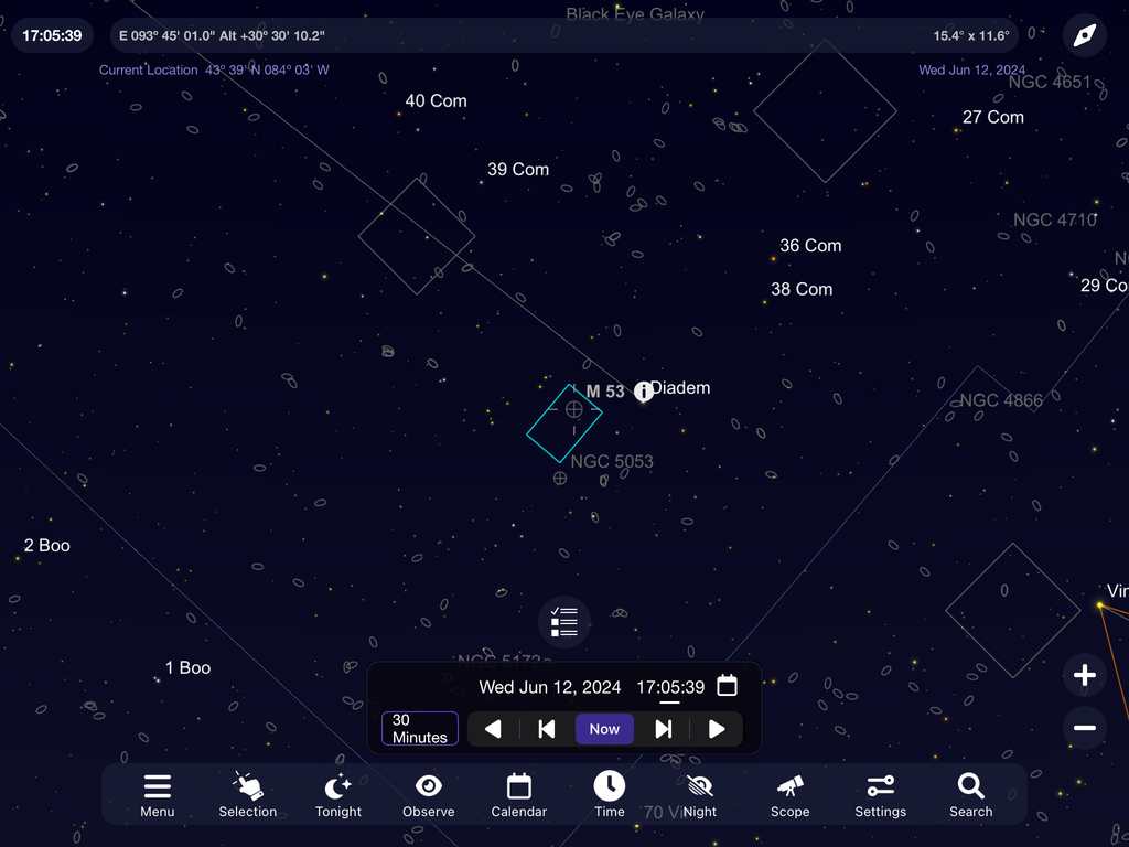

Here is a screenshot from Sky Safari Pro of the field with the compass in the upper right corner.

Tom is right: on the sky  if North is up then East is Left.

And, yes, the E arrow is pointing correctly. We're used to looking at maps where we are looking down on the Earth. But to look into the sky, we have to turn our gaze through 180-deg., so that what was left, now becomes right! It's almost as non-intuitive as thinking 3-D spherical orientations.

Mau_Bard 4.06
Jay Hovnanian:
Hi Jay, the arrows are in fact correct.
The source of confusion is that we are dealing with two systems of coordinates: 1. the celestial equatorial for the sky, and 2. the local horizon (geographical, terrestrial) for earth orientation.
When you are talking about directions in the sky, you use celestial equatorial coordinates, not the terrestrial geographical.
In the sky you have  by definition the north arrow pointing to the North Celestial Pole (not the Zenith!) and the east arrow points 90° left of north, wherever you are in the sky.
If you happen look in direction of the geographical north, you have the celestial east arrow pointing to the terrestrial west, but you are talking two different things.
Hope this helps.
