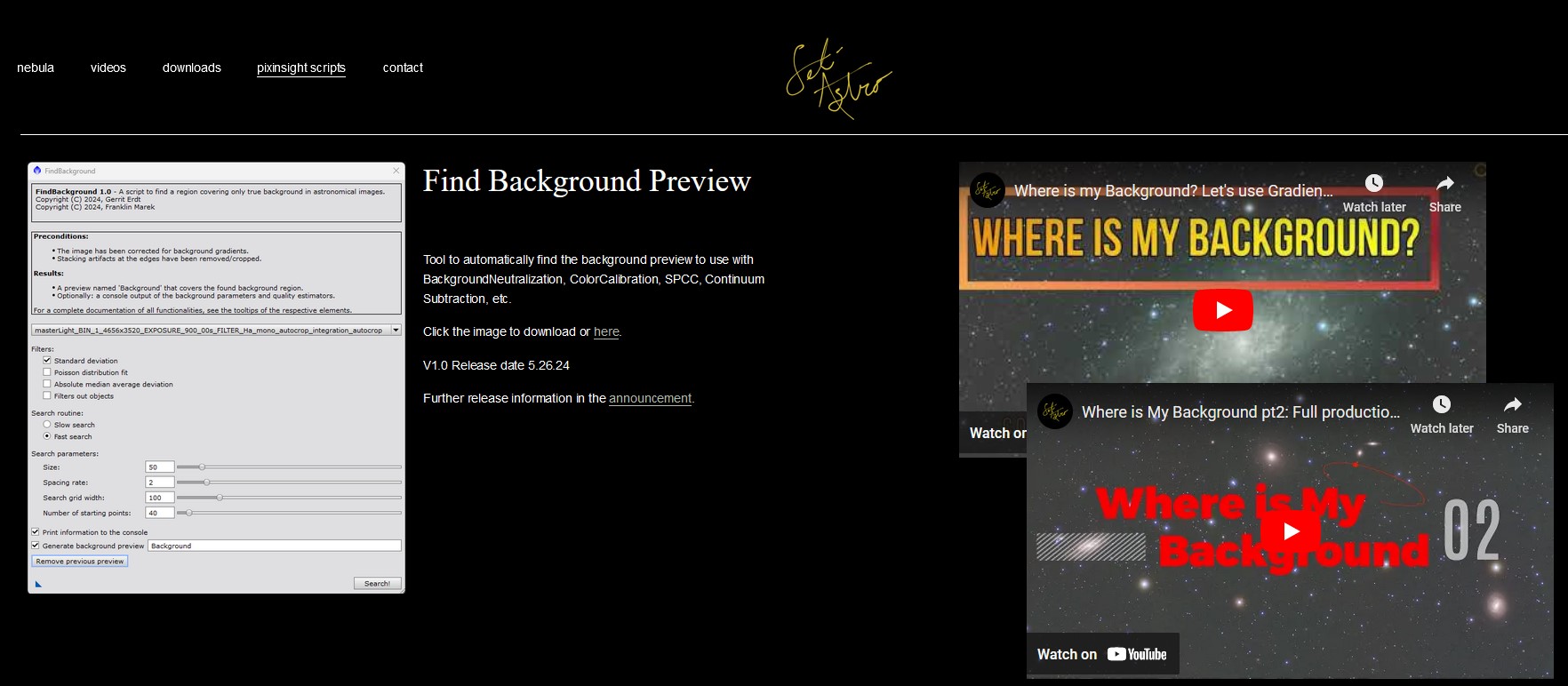

For a standalone download, you can use this link to my website: https://www.setiastro.com/pjsr-scripts

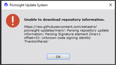

Hi Franklin,
I tried to install the script but Pixinsight gives this error:
Repository URL : https://raw.githubusercontent.com/setiastro/pixinsight-updates/main/
Signature : <* unavailable *>
Authorized : false
Available packages : 0
Selected packages : 0
Error log:
https://raw.githubusercontent.com/setiastro/pixinsight-updates/main/: Parsing repository update information: Parsing Signature element (line=1 offset=0): Unknown code signing identity 'FranklinMarek'
apo20232 0.90
Franklin,
Great script. I appreciate the effort to develop this, and your other recent scripts. They certainly help streamline my workflow.
Jim
MalcolmPark 0.00
repository doesnt work
seti_v2 19.05
If you havent upgraded to PixInsight build 1605 (which came out in March) I highly recommend you do that as all scripts are going to require signatures going forward.  You do this from the PixInsight download site. This will fix the error if you are trying to use the repository.
If you still run into a parsing error or signature error you can download the zip file directly from my website and then just extract the .js files (delete the .xsgn file).  You can then go to Scripts -> Feature Scripts -> Add Script and select the folder you extracted the .js file too.
Let me know if this helps

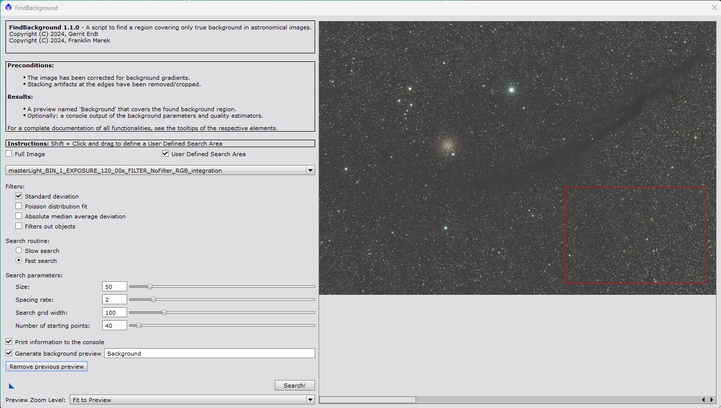

Pretty big update in the script.  I have added a User Defined Search Area.  Perfect for those times where you couldn't remove the gradient fully, want to avoid a dark dust mote, avoid a dark nebula, or any other reason the user may want to restrict the search area of the image.  If you have my repository link in PI you already have the update!  If using the User Defined Search Region, I recommend reducing the Number of Starting Points since you are now only looking at a smaller portion of the main image or doing a Slow Search in the new Defined Region.
I hope this will really help in those very complicated cases!

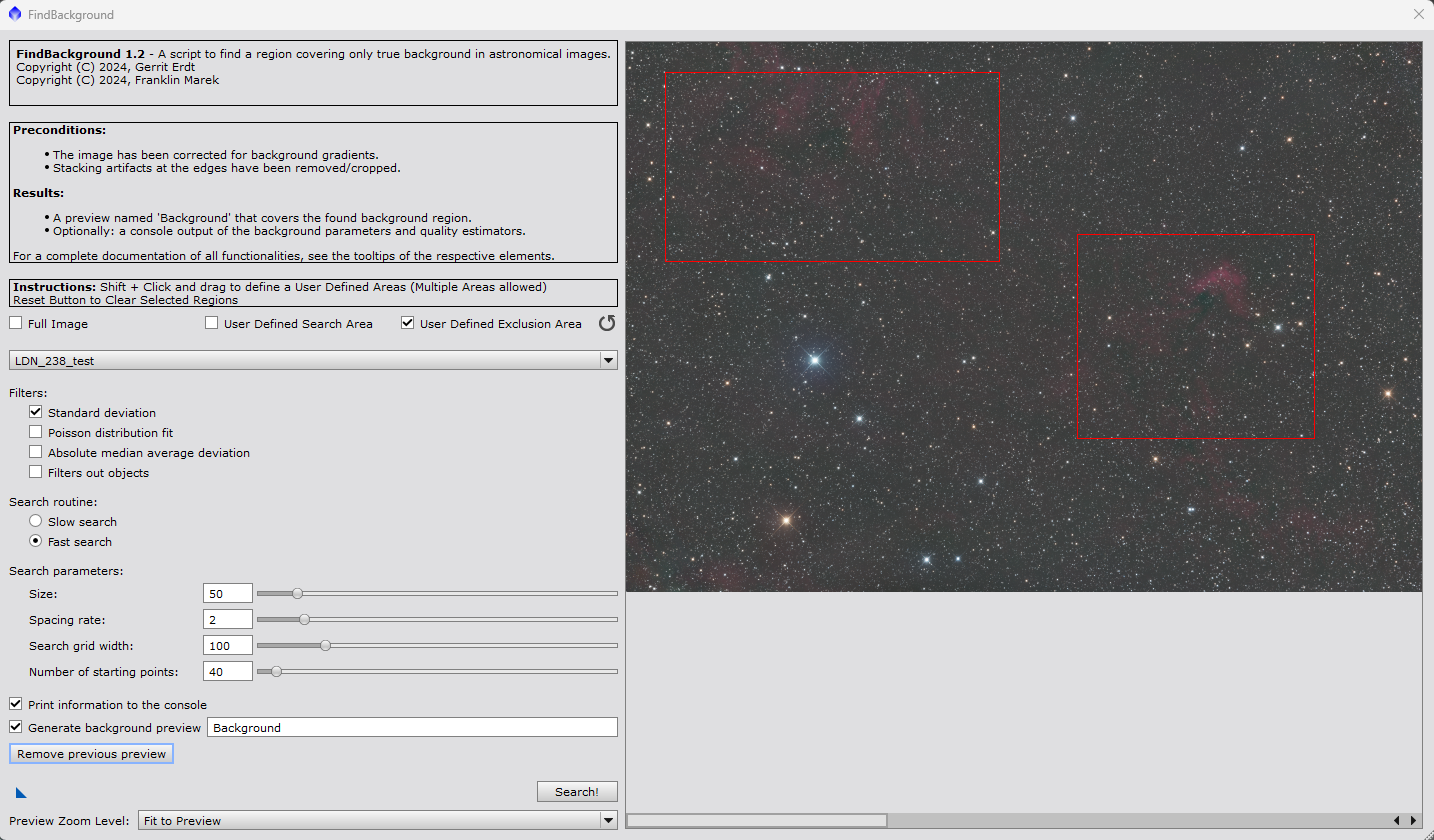

You asked for it!
MAJOR UPDATE: Now supports defining multiple user defined areas.  3 options now.  Full Image Search, User Defined Search Areas, User Defined Exclusion Areas.  Depending on your image you may find it easier to define a couple sections you want to exclude from the search or conversely define some sections you exclusively want to search.  There is a reset button next to the checkboxes to clear and reset your areas.

drmikevt 0.00
As long as you're at it - maybe make exclusion boxes red and inclusion boxes green?  I just tried it out and it looks like you can define both exclusion and inclusion areas on the same image.  However, all of the boxes are red and so there is no way to tell which is which.
Also, I think the instructions should say 'Shift+Click to define User Defined Areas in the preview image to the right (multiple inclusion and/or exclusion boxes allowed)….
Anyway, thanks for a lovely tool
Mike
seti_v2 19.05
The algorithm only uses the regions as either inclusion or exclusion strictly based on whether the checkbox is selected to User Defined Search Area or User Defined Exclusion Area.  It is either one or the other.  The areas are just that, areas you selected.  The choice of the checkbox is the determining factor.
I can code it if you switch to the other checkbox it just clears the areas.  I can also change the color based on the checkbox.  Doesnt change the function at all though.
Frank
drmikevt 0.00
I see - the way it behaves now, it SEEMS like you can add both kinds of boxes since the boxes persist when you change the checkbox.  So, maybe clearing the area if the checkbox is changed is best
Mike
seti_v2 19.05
Mike
Yes I can make that change.  Clearing it out will emphasize it is one or the other too.  Might as well make the colors green if you are drawing on one and red on the other too
The other things is drawing these areas should be the rarity.  You want the script searching as much of your image as you can
Frank
seti_v2 19.05
V1.2.1 updated.  Rectangles clear when switching between search modes.  Green color for inclusion and red for exclusion as a visual reminder for what mode you are in.  Now I need some sleep hahaha.
