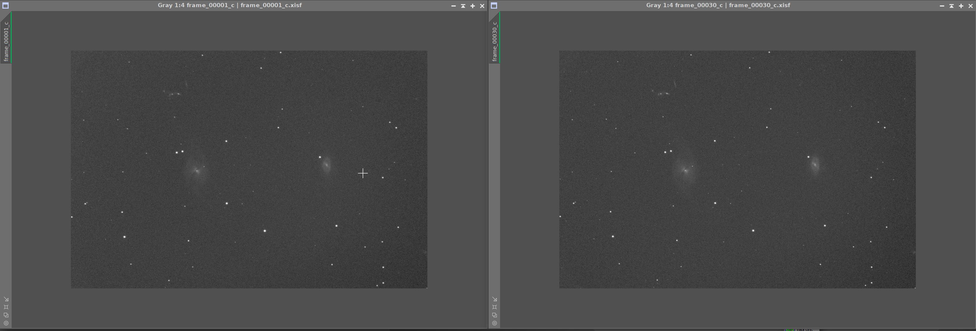

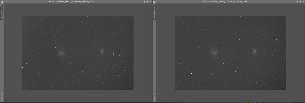

OK... the world does make sense, floating point math still makes sense.
Somehow, in image calibration using WBPP, I suspect the bias is being subtracted multiple times causing therefore, a division error. Here, I simply subtracted the bias from the flat, DID NOT SUBTRACT THIS BIAS FROM THE 300s DARK, and simply calibrated the lights using the raw 300 second dark, and the flat from which the bias was subtracted. Perfectly calibrated frames, no linear fit needed, no need to worry about sensor non linearity.  In thinking about Andrea's work, which motivated my effort here, what I realized is that his Linear Fit process is in effect either adding or subtracting a bias:
It think it really helps to understand how calibration works, rather than treating WBPP as a black box. For the longest time, I avoided WBPP for just this reason. Even now, there are parts of calibration I will do manually before feeding into WBPP.
Cal_Light= (Light - Master Dark)/Calibrated Flat
Where Master Dark does not have bias subtracted from it, calibrated flat has either bias or flat dark subtracted.
There are other forms of this equation, but understanding the fundamental math and science behind calibration avoids a lot of grief.
