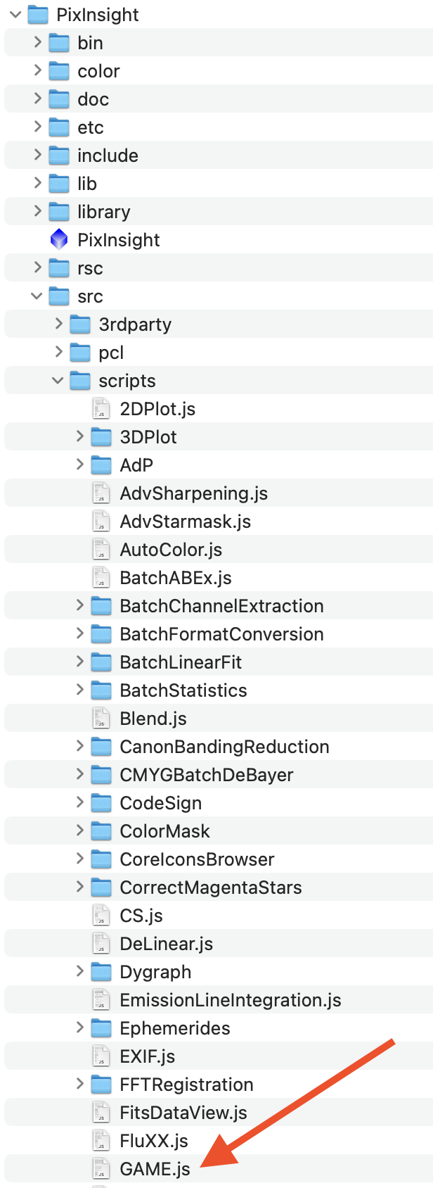

Is the GAME.js script really saved in the scripts folder in PixInsight?
ChemProf 0.00
Yup (to the installation location}.
Works very well for me (under Linux).
