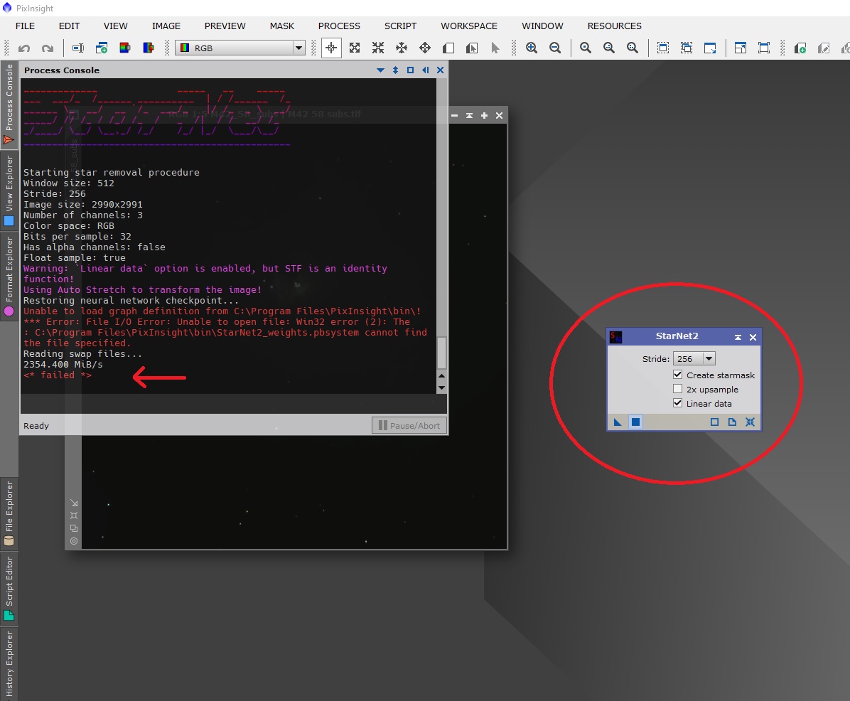

First of all, I need to say I bought PI yesterday, and I don't know too much about PI, especially when it comes to folders.
I press the "global" button on StarNet (the drag and drop button also does the same thing), and I get this "failed" prompt:
In my excitement, I probably put StarNet in the wrong folder
I have absolutely no experience with this, so can someone tell me what the problem is, and direct me as if they were talking to a 10 year old?

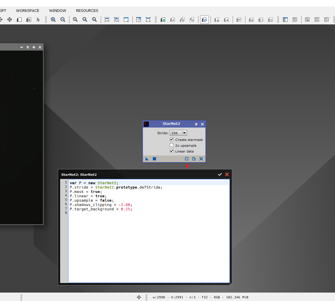

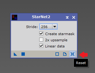

Hi, thank you, which bottom button to the right?
This is the middle one, on the right:
The left one (I'm guessing this is the one you're talking about? If so, can you tell me exactly how and where I should type? Does it need to start with "P."?):
And the right one, which just says "reset":
And what are the two files it needs?

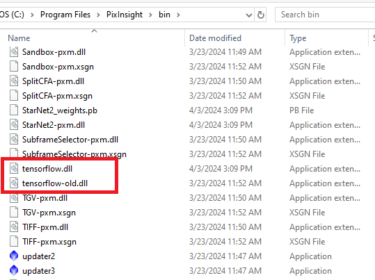

PROBLEM FIXED!
Thanks a lot, it finally works!
EDIT: Intead of "tensorflow.dll.old", I used "tensorflow-old.dll", for the old file, because the other way would change the file type to ".OLD".

I'm confused. If I move the newest Tensorflow file into Bin, it's gonna ask me if I want to replace the old one. Or do I need to replace it?
This what Bin looks like:
You need to replace the tensorflow from SN with the tensorflow from rc-astro. Just replace it (you still have the original in the downloaded file).
Oh, ok, thanks, will try it now.
Thanks a lot! BXT, and NXT, and Starnet all work without problems!
