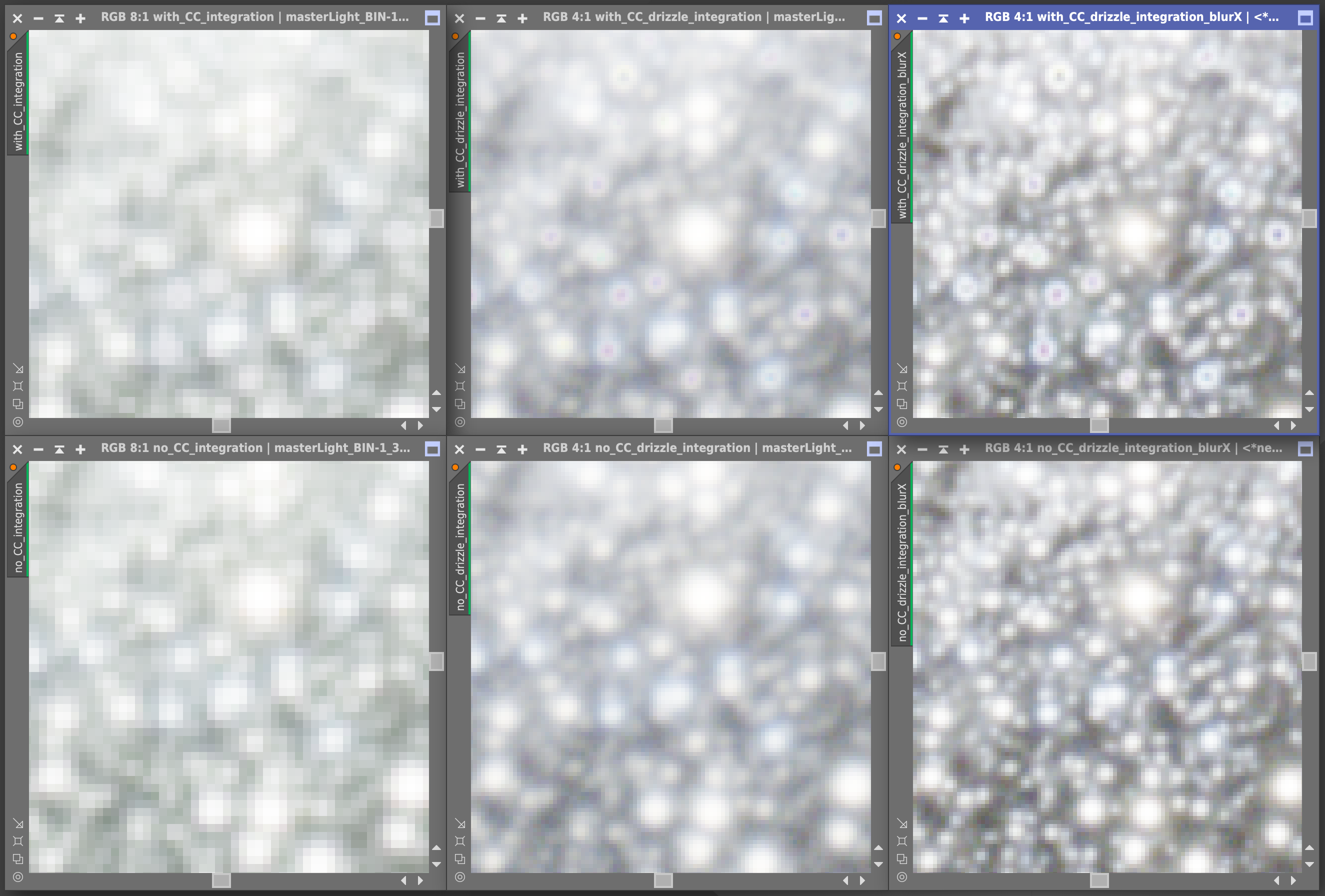

about a year ago, I tried my new telescope on the M13 star cluster and after WBPP script I noticed a strange shape of some stars within the cluster. As shown below, this issue is almost invisible on non-drizzled image. However, after 2x drizzle, some, but not all, stars are completely hollow. The issue is of course even more prominent after BlurX, and the whole picture is ruined quickly.
Last few nights I acquired some more data and encountered this problem again. Luckily, this time I was able to find some old post on stargazerslounge.com, indicating that my CosmeticCorrection settings might be the problem (original post: https://stargazerslounge.com/topic/305822-hollow-star-issue/). Indeed, it was a correct hint and I was able to finally process the image without this crazy issue. All what I did was disabling CosmeticCorrections.
Hope you find it useful.
Martin

What kind of telescope?  If it’s a Newtonian, SCT or RC, could you be slightly out of focus and it’s a central obstruction?

Old post of mine addresses the issue: It is really just one setting that needs to be unselected when you have serious undersampling (correctly sampled or oversampled images are not affected), that of automatic detection. If you use a master dark frame instead you'll get 99.99% of the benefits without any risk, as it really should be done anyway.

I don't think is has anything to do with focusing. Also, different stars are hollow for different channels. This somehow implies the CosmeticCorrection issue, which was proven by reprocessing wit and without it.

Todd, I think I encountered this before as well, and if memory serves, it had something to do within another area in WBPP setting having to do with interpolation mode and clamping threshold in StarAlignment; when I encountered this before, I changed up different pixel interpolation algorithms and it seemed to help.  I am not at my processing computer right now but will see if I can find those setting changes and pass them along.
Sounds like your CC fix did the job, but would be interesting to see if you restored CC but lowered the Clamping threshold in StarAlignment or choose another Pixel interpolation algorithm whether it would go away as well.

This can also happen if the stars are clipped. If that's the case then nit's in the original data, just hard to see. Processing simply makes it more visible. You might try a line contour plot on the original data and see what it looks like. If you get flat tops, the original data is clipped.

How did you stretch the image? I notice these same artifacts when I use masked stretch and Arcsihn stretch. I just posted images of M13 and M92 and had no issues with non-drizzled data stretching with just Histogram Transformation. In these particular instances I did use darks with the auto correction feature enabled in WBPP.
xxao 3.61
All the screenshots are just temporarily stretched using linked STF AutoStretch.
I went through some other posts showing the clipping, but it looked a bit different.
And yes, I used somewhat old darks. I definitely should redo my darks library.

Following up on Tony's point, HSV Repair Script can help if they are indeed clipped. I've gone that route as well! That was more of an issue with DSLR imaging than a cooled camera, but take a look at the stars in the linear state and see what the readout mode is showing for K value - anything over .8 is clipped and might benefit.   However, the universal finding of so may cored out samples makes me think it is more likely another setting in WBPP -

Yes it's CosmeticCorrection. The tiniest stars often have a single bright pixel in the centre - if you use auto detect CC can detect these as outliers and remove them!
Niels_L 2.39
Many suggestions here - I had the same issue. Read @andrea tasselli  answer, it is the correct way to do CC (on your masterdark)  Never had the issue again.

During my 6 year long astrophotography journey experimented with all common types of telescopes but never managed hollow stars from stacking, who introduced this weird algorithm 😆 ? From my perspective it looks like out of focus reflector showing the secondary mirror maybe with stacking process it amplified and became visible and further processing is just bringing out the real disaster behind the raw images? With 11” reflectors and Front Glass corrector plate the stable focus can be challenging over night!
Why drizzle shows “hollow stars” more clearly
  1. Drizzle (especially 2x) reconstructs the image at higher resolution:
    • It doesn’t invent detail but redistributes flux more precisely using sub-pixel shifts between frames.
    • If the stars are slightly out of focus, the star’s light is already slightly donut-shaped or flat-topped in the raw data — drizzle will magnify that profile, making the core appear “hollow”
  2. PSF behavior in slightly defocused systems:
    • When a star is out of focus, the point spread fNOunction (PSF) becomes a bowl or donut rather than a tight Gaussian.
    • Drizzle samples that more finely, so instead of a soft blur, you get a resolved dip in the center
  3. Large central obstruction of SCTs (like C11):
    • The Airy disk of SCTs already has a pronounced ring-like structure.
    • Combine that with minor defocus or seeing, and drizzle can visually amplify the central dip
  4. Undersampling before drizzle:
    • If the camera had undersampled stars before drizzle (e.g., large pixels or short focal length for the seeing), the original stellar profile was not properly recorded.
    • Drizzle tries to reconstruct sub-pixel information, but with poor input data (like flat-topped or too-small stars), it can produce artifacts

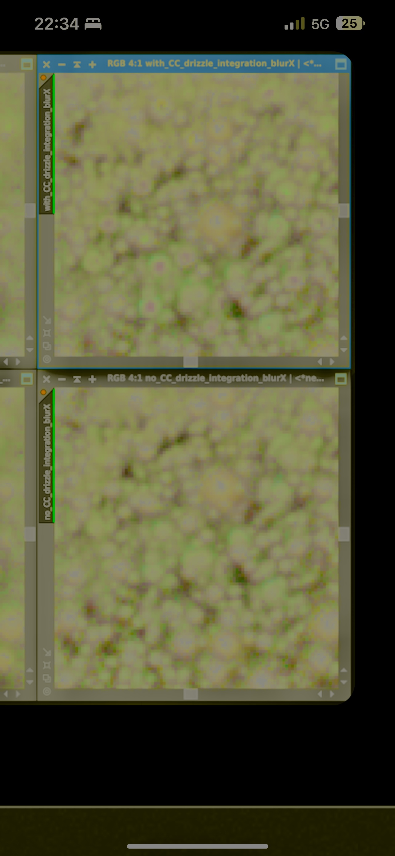

I have overprocessed your NOdrizzle Version and you can clearly see tiny black dots on the stars Center which have been amplified by drizzle process later.
And there are other issues with Autocorrection.  If you see a little line between two close but resolved stars, it may be created by the dark autocorrection in CC.  I use master darks always for CC.  3 sigma light and dark.  But I also use Autocorrect at 6 sigma just in case.  Probably useless but it seems to avoid artifacts at that level.
