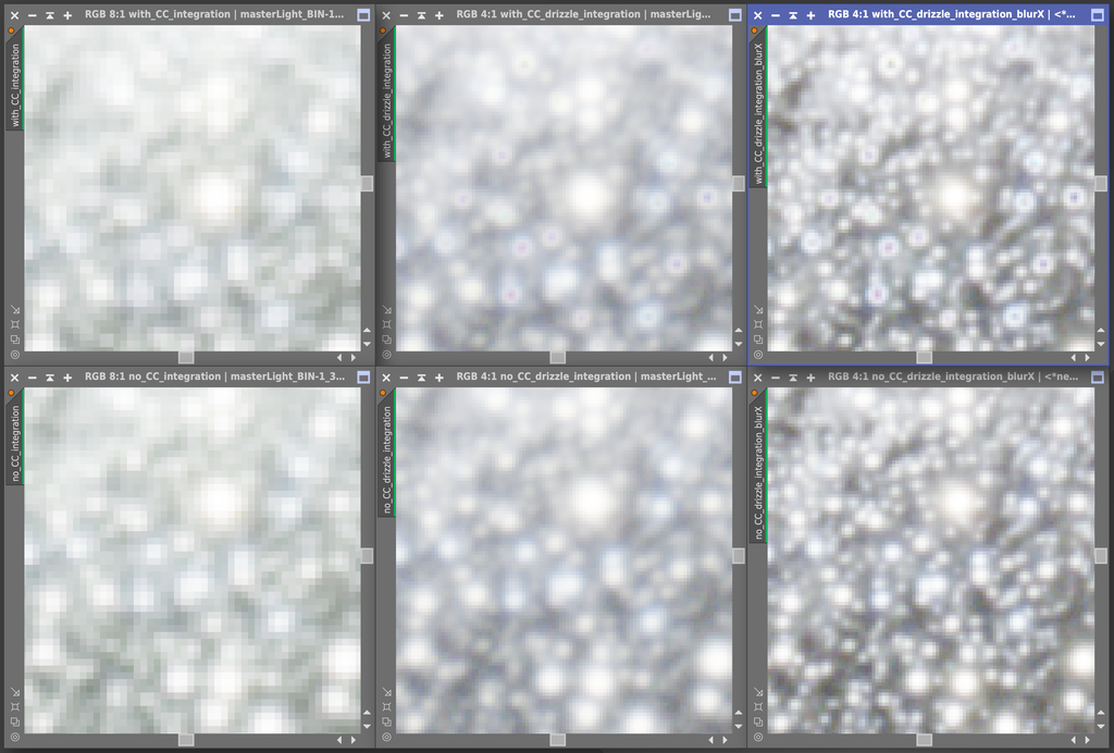

Hi, about a year ago, I tried my new telescope on the M13 star cluster and after WBPP script I noticed a strange shape of some stars within the cluster. As shown below, this issue is almost invisible on non-drizzled image. However, after 2x drizzle, some, but not all, stars are completely hollow. The issue is of course even more prominent after BlurX, and the whole picture is ruined quickly. Last few nights I acquired some more data and encountered this problem again. Luckily, this time I was able to find some old post on stargazerslounge.com, indicating that my CosmeticCorrection settings might be the problem (original post: https://stargazerslounge.com/topic/305822-hollow-star-issue/). Indeed, it was a correct hint and I was able to finally process the image without this crazy issue. All what I did was disabling CosmeticCorrections. Hope you find it useful. Martin  |

Thanks for response. I don't think is has anything to do with focusing. Also, different stars are hollow for different channels. This somehow implies the CosmeticCorrection issue, which was proven by reprocessing wit and without it.
Just to add some more details: Askar FRA500 ZWO ASI533MC Pro Optolong UV/IR cut About 10 hours of exposure (cca 300x120s)

Yes it's CosmeticCorrection. The tiniest stars often have a single bright pixel in the centre - if you use auto detect CC can detect these as outliers and remove them!
Many suggestions here - I had the same issue. Read @andrea tasselli answer, it is the correct way to do CC (on your masterdark)  Never had the issue again.

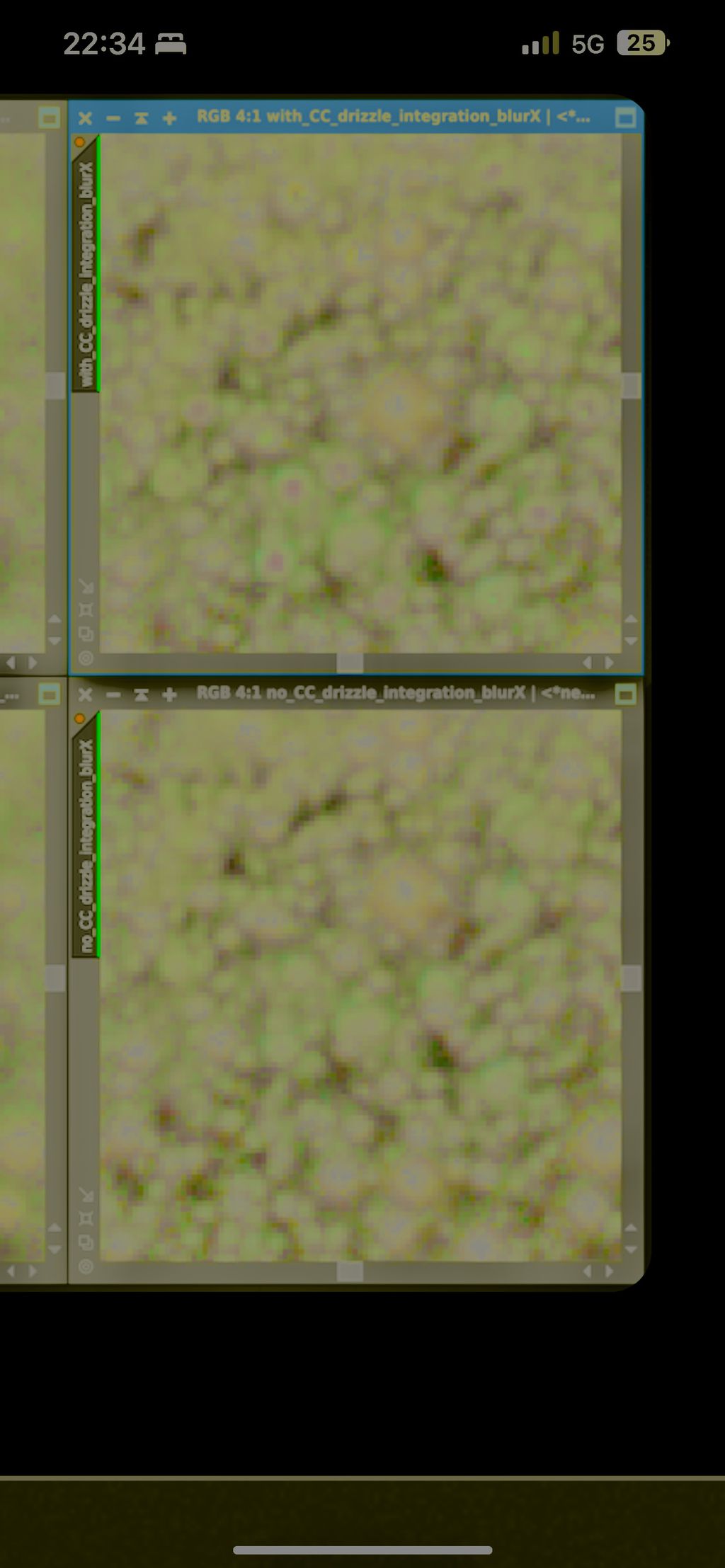

I have overprocessed your NOdrizzle Version and you can clearly see tiny black dots on the stars Center which have been amplified by drizzle process later.  |
