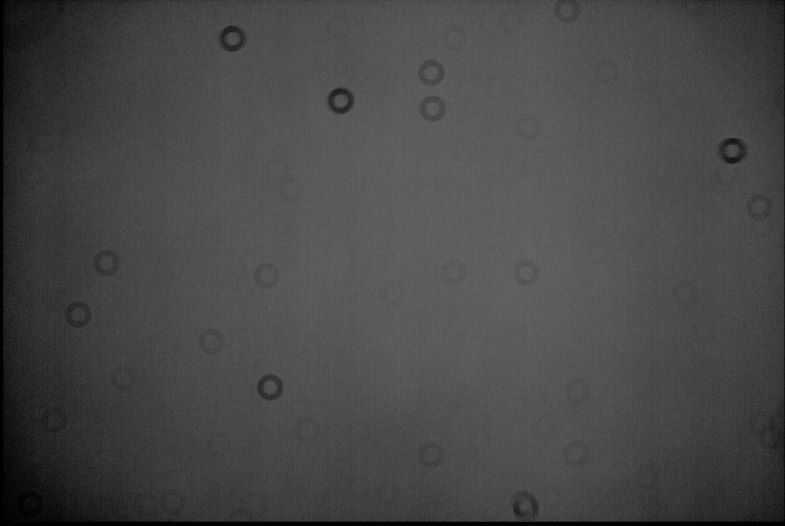

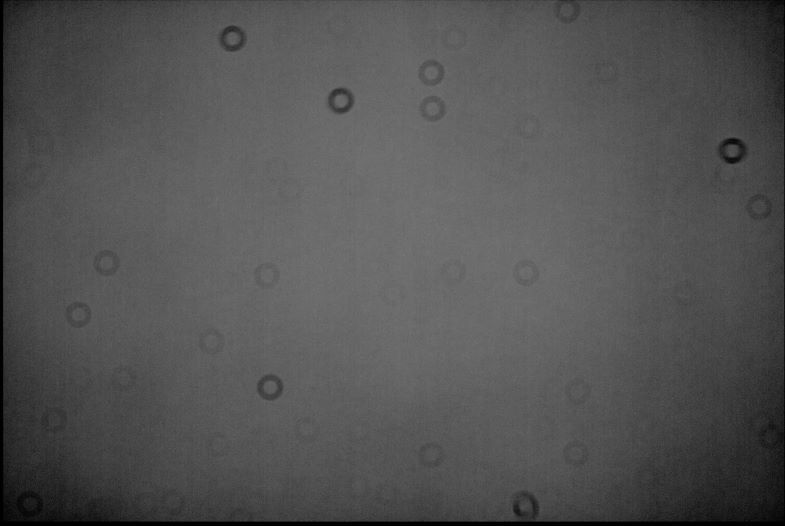

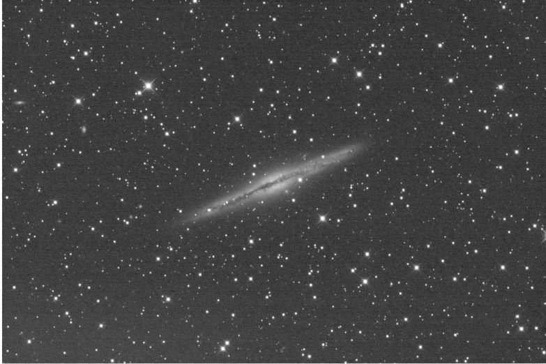

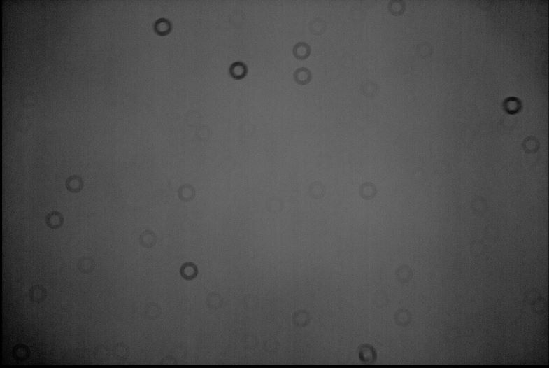

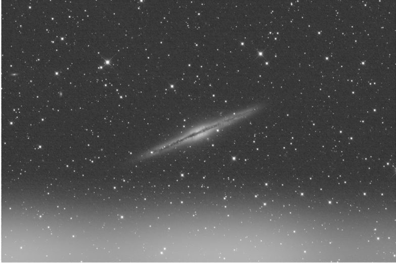

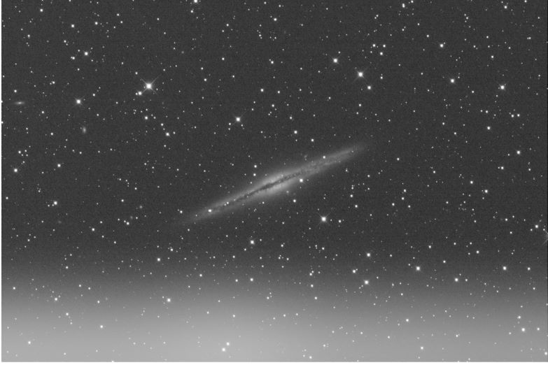

I have some simple RGB masters of NGC891 from about a month ago that ended up with an odd gradient on the green and red channel masters. I can't see anything in the individual frames that would point to this and the darks and flats look normal. The blue channel seems okay and all frames were taken on the same night. I'm including simple auto stretched versions of each channel's master light as well as each channel's master flat. The flats were processed with flat darks and the light with master dark and bias (all looked normal). Any thoughts or suggestions would be greatly appreciated.
Blue flat:
Blue master:
Red flat:

Green flat:
Green master:

Maybe, if red and green frames were taken before the blue ones, there was some kind of ligth pollution affecting those first frames. The flats doesn´t seem to be bad, so the reason for the gradients must be in the lights themselves.

cfbradshaw9373 0.90
In addition to the above, check for light leaks or reflections in your environment.  It does not look like sky produced light as it is too sharp and consistent between the two filters.  Your flats look fine.

Thanks all for the replies. I'll try and summarize and later today provide some uncalibrated lights. The camera is a QHY268M and I'm using Astrodon LRGB filters in the QHY3M wheel on an AG Optical 14.5" iDK (with shroud). The darks were taken at the temp and duration of the lights and the exact same calibration masters (except flats of course) were used for all three master lights so the blue, which came out okay, would have been effected as well if it was related to the darks or bias frames (at least that is what I assume would be the case).
I didn't notice anything unusual about the individual light frames in terms of a gradient but perhaps it is so light that it doesn't clearly show but when stacked it adds up enough to cause this problem. I'll try excessive stretching of the red and green individual frames to see if I can find anything.
I tried a simple GraXpert run using the newer AI version script in PI and it removed much of the gradient but nowhere near all of it.
Linwood 6.06
I really don't think that is a light pollution gradient.  That looks like some kind of light leak.  Unless that preview stretch is really odd, the boundary is just too sharp, and while not impossible a sky gradient would seem unlikely to align so perfectly with the frame.

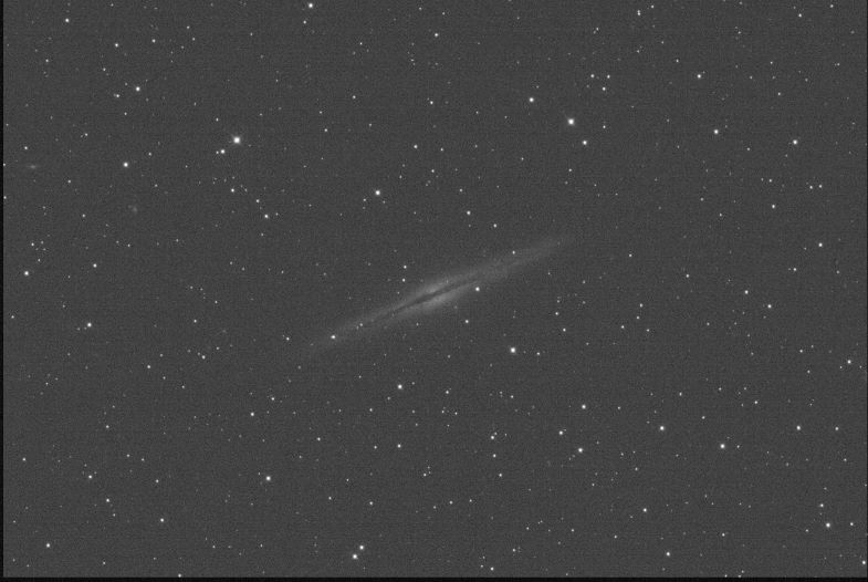

So here is an auto-stretched single red frame (30 sec exposure). I blinked through all the green and red frames and they are all very similar. I see nothing that would point to the gradient in my masters. Boosted auto-stretch also showed nothing unusual.

Your flats are very slightly offset - the vignetting is not symmetrical, which suggests your camera is not in the optical centre of your OTA.

My first suspect would be your flats - they are not symmetrical - something that has caused me a lot of grief in the past.
It would be pretty easy to confirm whether they're contributing to the problem - what happens if you stack your lights using an identical process, but without calibration frames - do you still see the gradient ?

Was that last posting a calibrated light?  Have you blinked through all the lights (in a bad stack) to make sure they all look similar, and in particular are they all reasonably centered?  One possible cause is if some of the imaging occurred with the frame shifted up (relative to the masters you show).  Star align would shift those up leaving no data in the bottom, which depending on stacking could show as too dark, or too light from noise.
bluemoon737 3.61
Linwood, that last image was a raw red channel image just auto-stretched. I did blink through all of the red channel images and all were essentially the same with no appreciable movement.
Linwood 6.06
Interesting, if that's the whole frame there's no visible vignetting on it despite the flats showing quite a bit.   Not that that is relevant, just surprised.
