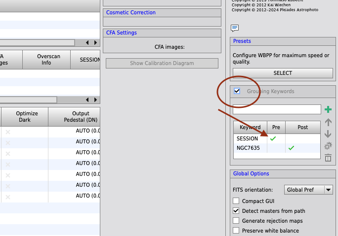

I'll typically handle this through the 'grouping keywords' option in WBPP or FBPP.
Put the lights and flats into different folders for each set that has their own flats to pair with. Then, name the folder <KEYWORD>_#. For example, I often use SESSION as my keyword and then use 1, 2, 3, etc. to represent the different lights & flats. WBPP will use the folder naming just before and after the underscore to determine if a keyword is in use.
So the full file path might be something like: Hard Drive > User Name > Pictures > Astro Stuff > M31 > Session_1
WBPP will recognize the SESSION keyword and group each set of lights and flats contained in each Session folder and then put them into the groups names for what comes after the underscore (in my example "1")

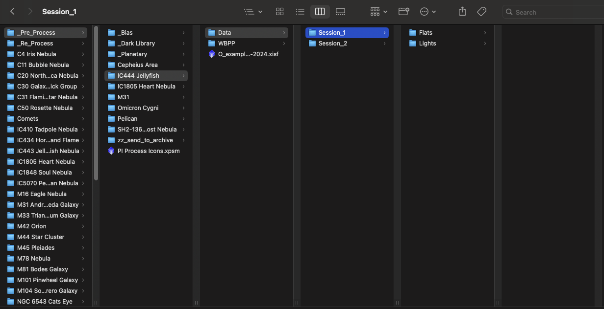

Yes, different Session_# for each pairing of lights and flats. For example, the folder layout may look like this:

thank you!
my gosh! it works! it's grouping them!
now I can calibrate them separately!
I just have one concern:
it will not make two separate stacks, right?

Check the Post Calibration tab for that. It will list the outcome of the stacking process.
If your "Session" keyword has the checkmark in only the PRE column (in the Session Keywords area), it will not separate into different stacks, only split by pre-processing files.
You can move the checkmark from PRE to POST or have both selected (click the gear icon in the Grouping Keywords area). The POST column is for splitting the stacks. There is a use case for that. If you are doing a mosaic and want to not register frames of different panels together, you can use the POST column for that.

THANK YOU SO MUCH
