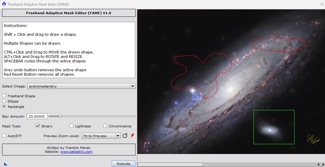

We can finally freehand draw our masks in PI! My new script allows you to freehand draw, draw ellipses, squares, along with moving the shapes, resize them, and rotate them. There are various mask types to use, a binary, lightness, and chrominance mask types too! I think this has been a feature sorely missing from PI. I hope this is a big help for everyone!!! Video I made covering the script: https://youtu.be/xASIu2tTL8sLink to my website for PI scripts: https://www.setiastro.com/pjsr-scriptsRepository link: https://raw.githubusercontent.com/setiastro/pixinsight-updates/main/Comments and Suggestions appreciated!   |

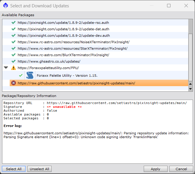

Why does the link return an 404 error?
andrea tasselli: Why does the link return an 404 error? You need to add that to your repository! In PixInsight go to Resources -> Updates -> Manage Repositories, then click Add. Copy the URL in there. Click ok. Then Resources -> Updates -> Check for Updates. After you install it you need to restart pixinsight.

I was referring to the link to the website but now it appears working. The script however does not:  |
andrea tasselli: I was referring to the link to the website but now it appears working. The script however does not:
 You need build 1605 or higher to use the repository, what build do you have?

andrea tasselli: 1601 Time to update PI. You can stick with 1.8.9-2 if you don't want to go to 1.8.9-3 yet. The last release of 1.8.9-2 is build 1605.
Well, I'll pass. Thanks anyway.

andrea tasselli: Well, I'll pass. Thanks anyway. You can get the standalone version via zip on my site too. You can add it as a feature script if you don't want to use the repository: https://www.setiastro.com/s/FAMEv111.zip |
Very kind. I'll give it a go.

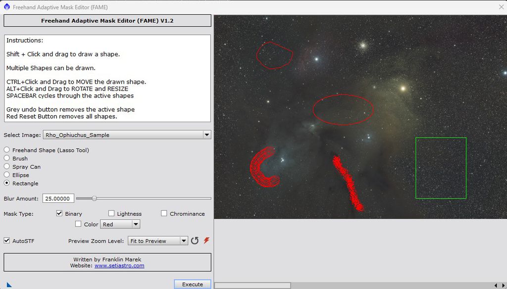

V1.2 now has a brush and spraycan tool! When using the brush tool is shows the skeleton of it in the preview so you can still see what you are doing but fills in when you hit execute.  |
