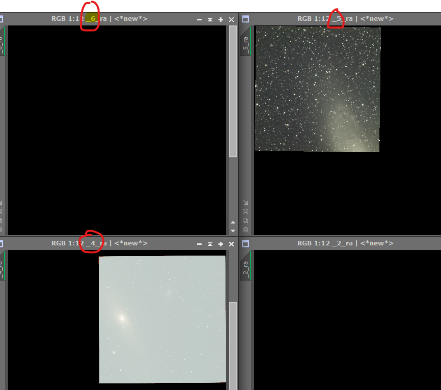

I am currently working on a 6 panel mosaic of M31
I have all the data I wanted, stacked and ready to begin the stitching.
I am following this tutotial https://www.youtube.com/watch?v=FkJKE-IWwTI&list=PLDNYZeyHBIFMGQ3-NWu9ek8C9yXuyA1ob&index=2
And panel #5 and 6, after running the DNALinearFit Scrip instead of the result being the image processed by the scrip I only get a black image with nothing on it.
All other 4 panels have no issues, after running the scrip I do get some image processed results.
After DNALinear, I do a GradientMergeMosaic as per the tutorial above, only panels 1 to 4 will stitch in the mosaic but not 5 and 6
Below you can see panel 6 result after running the DNA Scrip  (not good) Panel 4 shows a good result, and panel 5 has not run through the scrip yet
Any ideas/suggestions?

I think today there are far better tools for mosaics. Search for MosaicByCoordinates or the tools from John Murphy (PhotometricMosaic and NormalizeScaleGradient). If I were you, I  wouldn't invest time on older workflows based on DNALinearFit.

Thank you very much to all of you for your recommendations, following the video above gave me amazing results! I will make sure to try some of the other recommendations and maybe I can find a better simpler solution.
