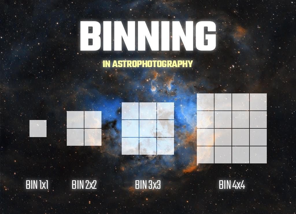

I found this pic explains Binning... Hope this helps  |
