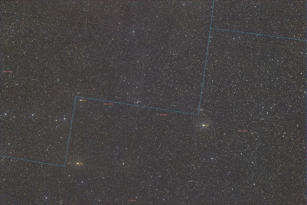

Hello,

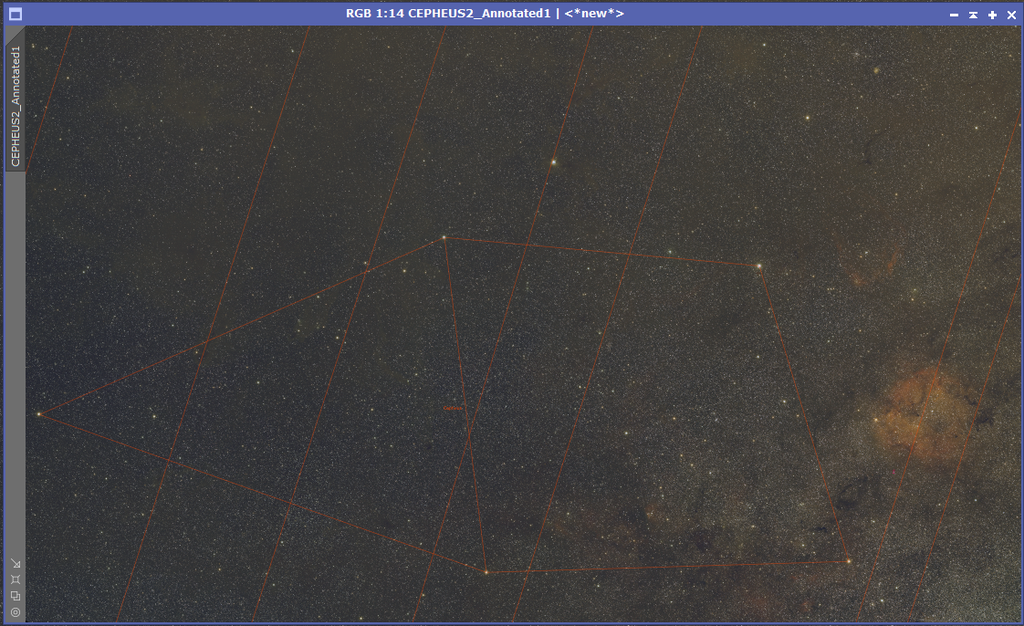

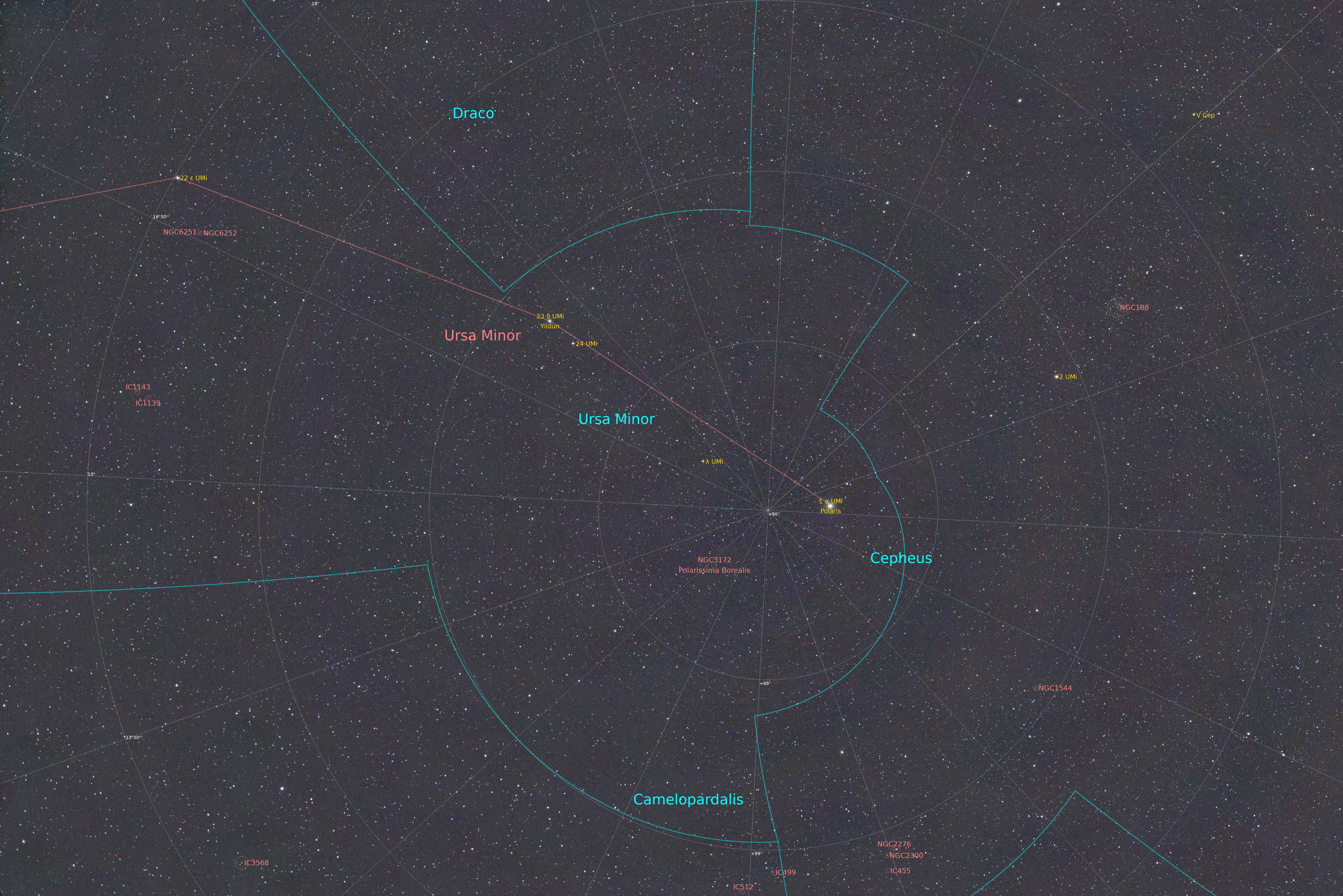

Has anyone figured out how to get the image annotation settings like  Astrobin uses for your home computer?
My results are crap. Ignore the gradients.
I get random diagonal lines across the whole image, top to bottom slanted in green and red, that have no obvious explanation.
All I want are the constellation lines and boundaries.
But I have these "bonus" lines that make no sense
Any help appreciated,
thanks,
Malcolm

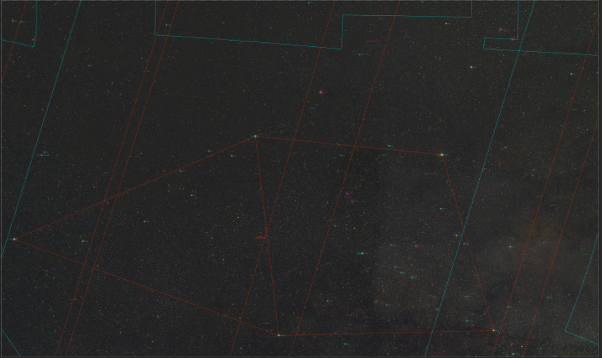

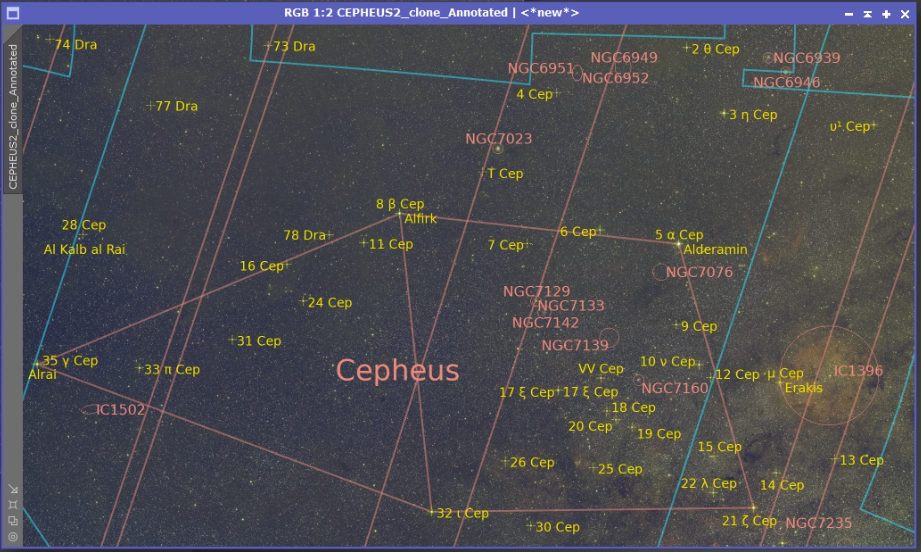

MalcolmPark 0.00
The image is from Pixinsight after image solver and Annotation.
The  diagonal lines crossing the image bottom to top  are not part of the constellation.
There is nothing selected in the script option that explains them.
Tom,
Seti Astro does not appear to have constellation boundaries and lines as an option as I have looked there.

MalcolmPark 0.00
the only selection in the annotation script is constellation lines.
This is the problem, the diagonal lines
jmfloater 0.00
What happens when you turn off the constellation lines option and then run it? Do the lines still appear?
MalcolmPark 0.00
I tried it with all options off first. you get nothing. There was no annotation added.
Then I added just constellation lines, and this demonstrates more clearly what t does. You get these random diagonal lines
jmfloater 0.00
So it only happens with constellations checked?
MalcolmPark 0.00
there are two options with constellations.
You can enable boundaries, or lines (or both) and you get these diagonal lines whichever you select.
They are there if selected by themselves, or with other selections made like IC's or NGC's.
The lines do not show up if you dont select the constellation lines or boundaries.

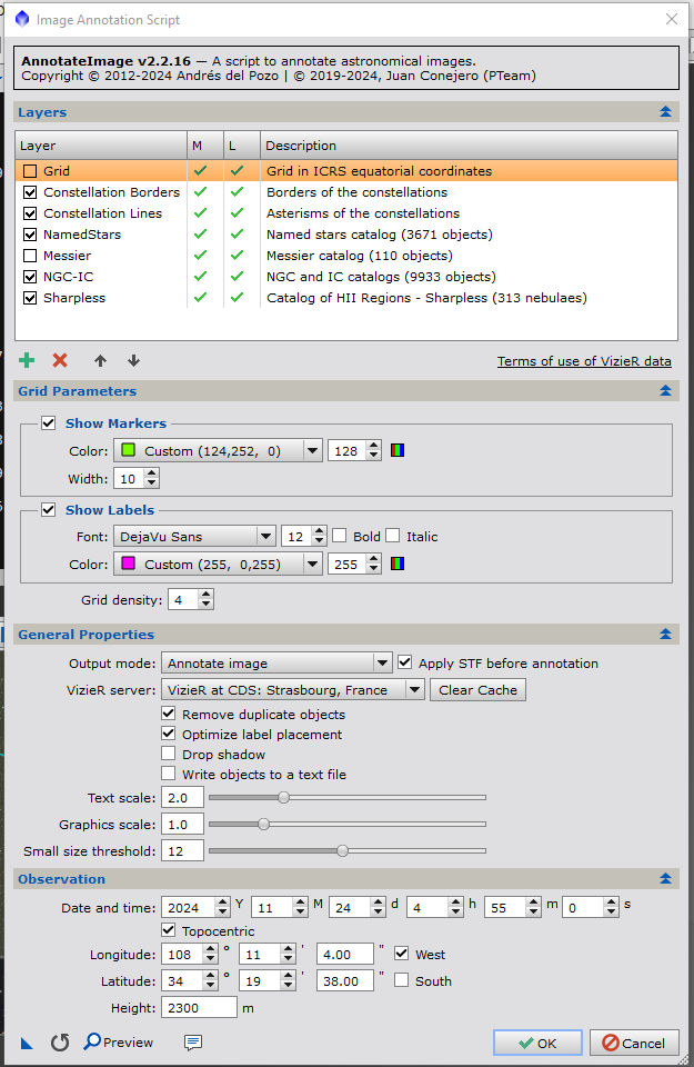

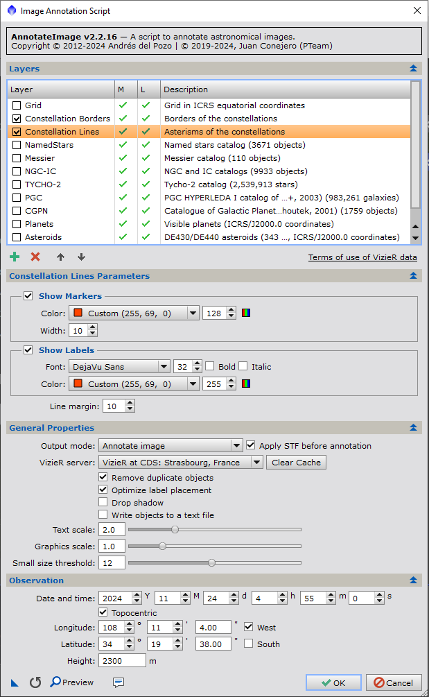

No one can read your mind.  If you want a good answer, be careful how you ask the question.  It's not that hard.
Sure, see below:
MalcolmPark 0.00
Sure, see below:
I see you have the grid enabled,  I will add that and see if it works, thanks

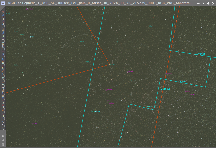

MalcolmPark 0.00

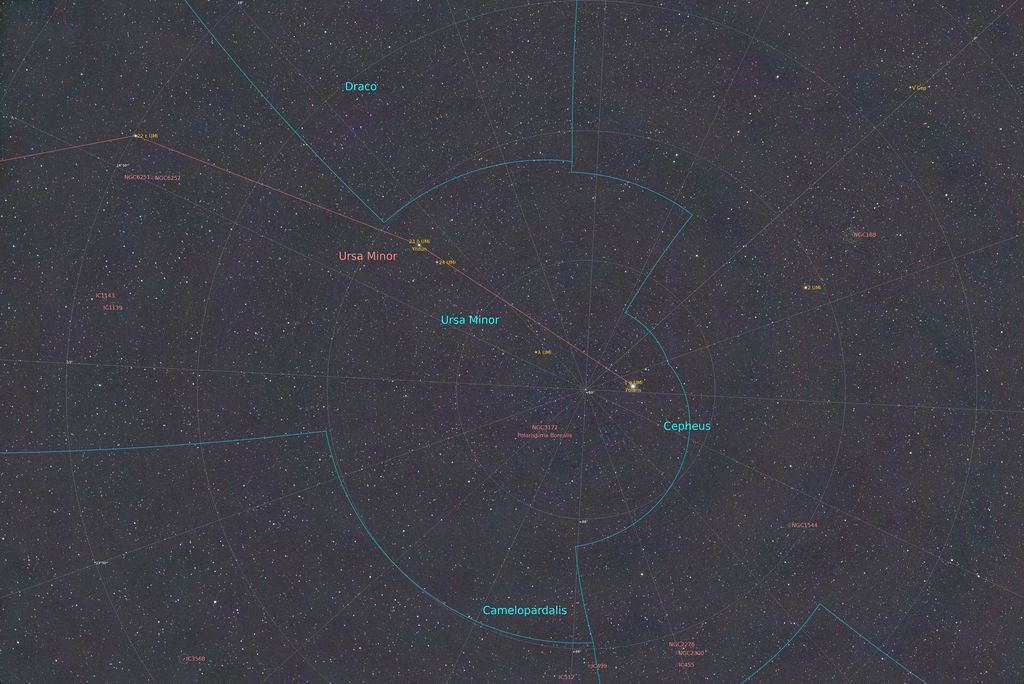

I sent the same image to a completely different pc, wondering if my installation was corrupted.
I got the same result  The diagonal lines again.
lunohodov 1.81
Malcolm, I found this to be really useful and I hope you'll find it too!
The AnnotateImage script has many options/settings. It will help people to know the ones you use. Maybe a screenshot of the process window itself?
