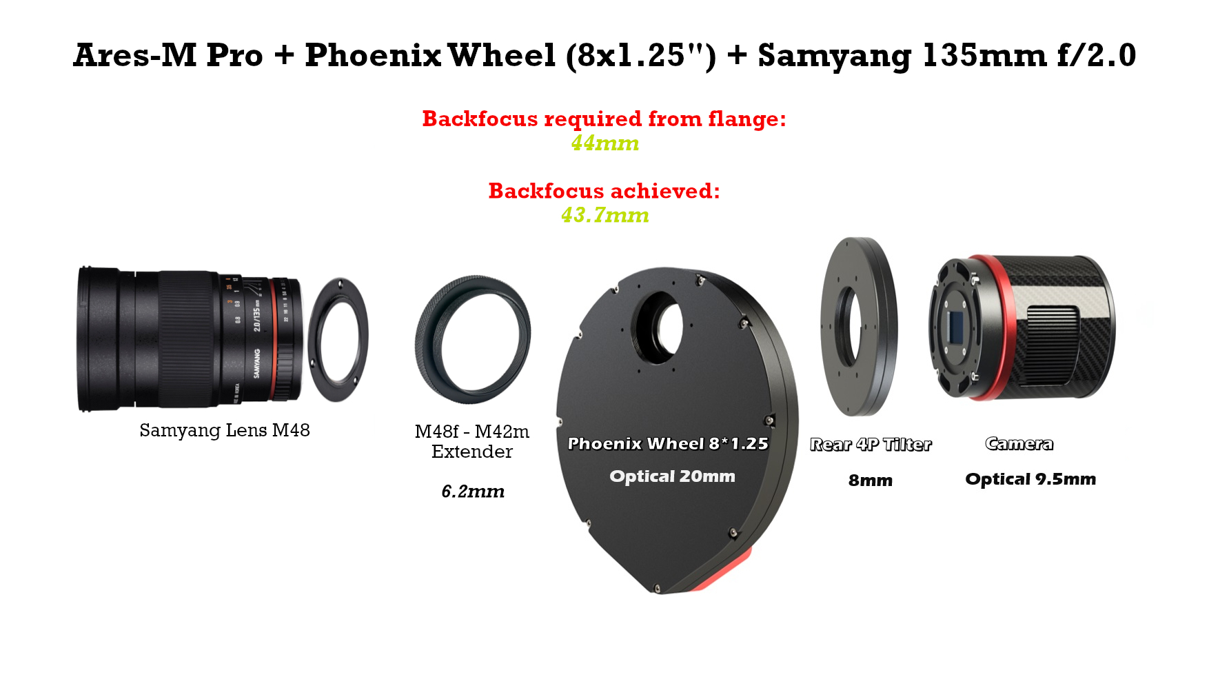

I would like to stay on the IMX533 sensor, so the Player One Ares-M Pro seems like a great option. I would also replace the Canon EOS bayonet with the M48 adapter from Astro Essentials (instead of goin with the ZWO EOS-EFW adapter) to reduce tilt and get extra backfocus space to work with.
This is the optical path I think should work (the remaining 0.3mm + 1/3 of the filters' thickness can be easily added with shims):
What do you think about it? Is there anyone who has a similar setup that can share his experience?
