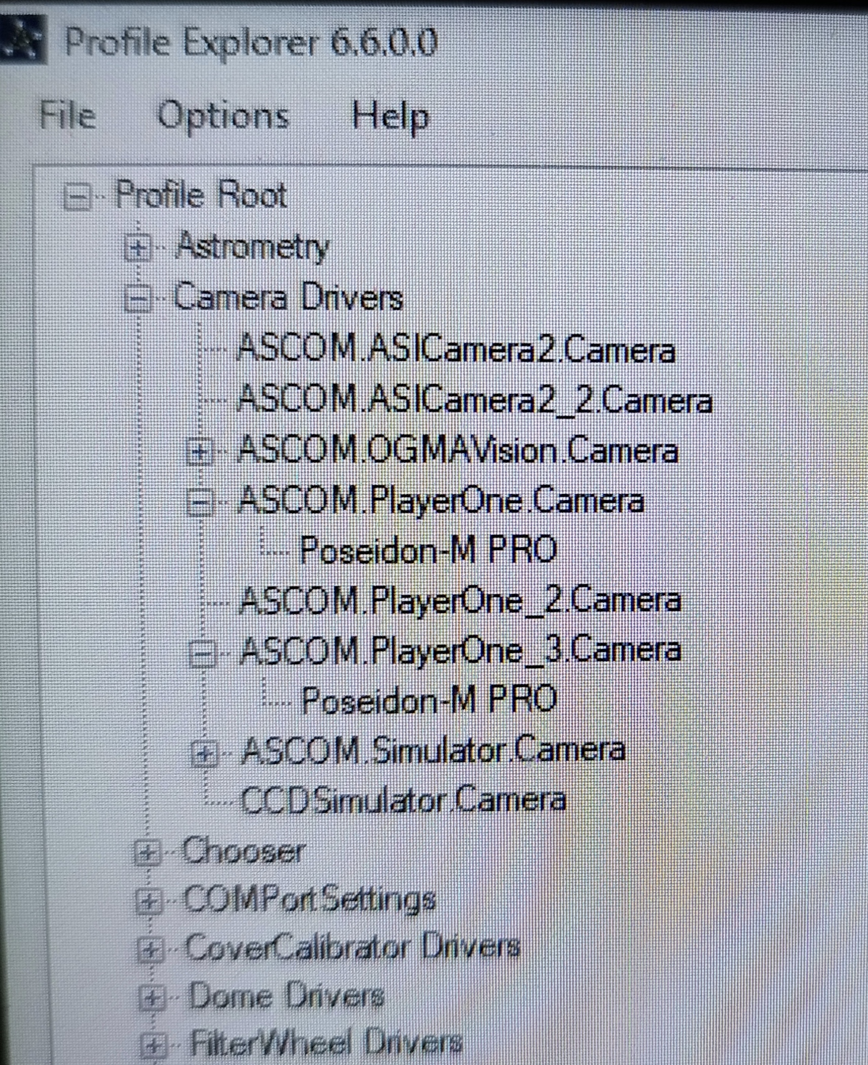

NicoMartino 1.20
It seems that the 2 cameras are not under the same driver if I understand my screenshot below ?
I can also try to connect guiding cam and mount before the imaging camera.
SkyStory 0.90
I don't know anything about programming, but from my experience I would suggest getting rid of all those extra ASCOM drivers. Use the PO proprietary driver to operate the Poseidon and the ASCOM for your guide camera.  For whatever reason, PHD2 seems to get the ASCOM drivers confused.
