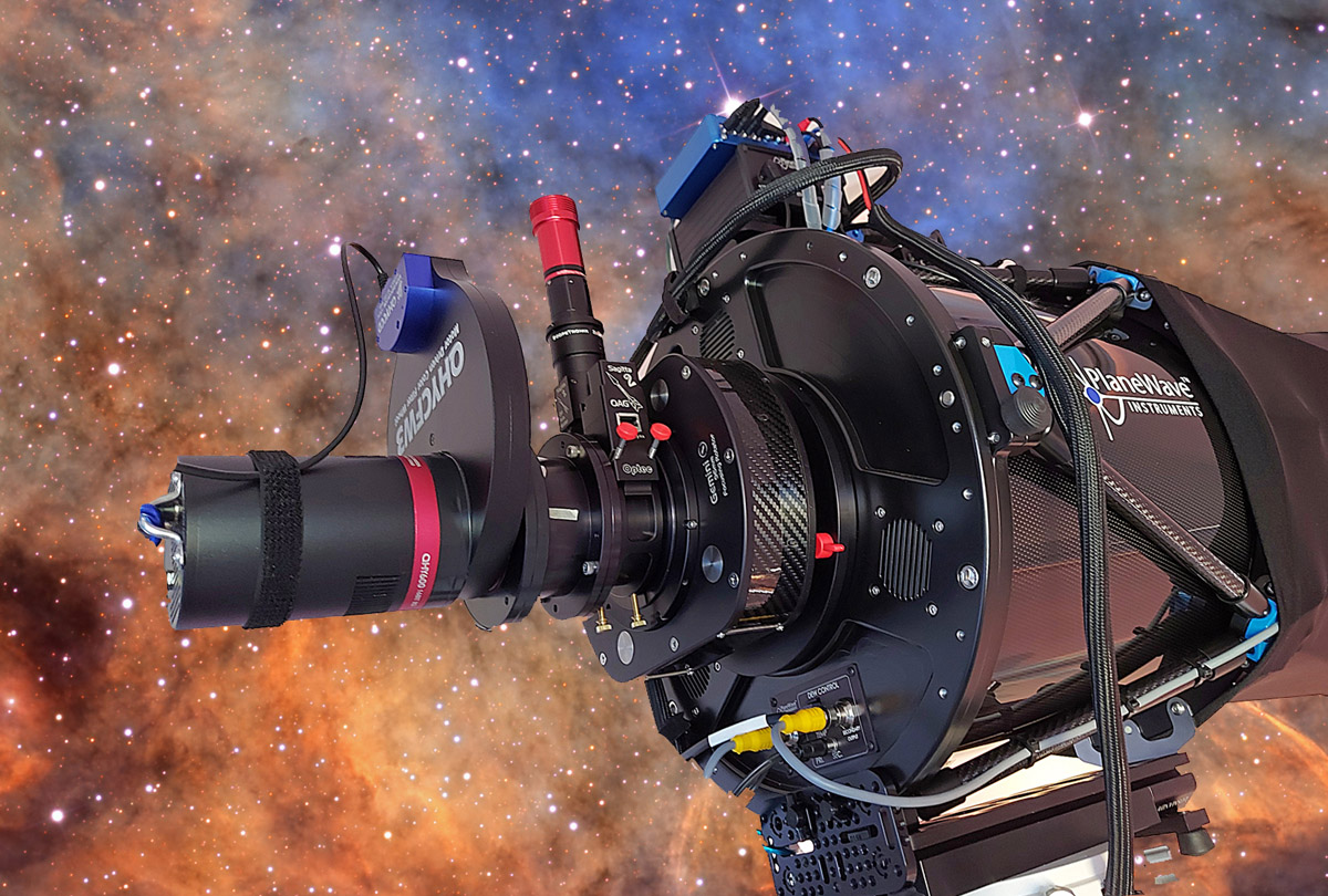

I have been chasing this for close to two years now and tested several iterations.
The finalized design is working very well and I'm extremely happy with it to the point that I doubt I'll switch back to native f/7.2.
Wrote a complete article with tests and results:
[b] [/b]https://rouzastro.com/reviews/
In its “fast” configuration, the system is now producing excellent results with the following features:
  • Fast focal ratio: f/4.76
  • Off-axis guiding (OAG)
  • Field of view: 1.5 degrees
  • High resolution – image scale of 0.46 arcseconds/pixel
  • Mono full frame camera with filter wheel support
  • Precision focus and instrument rotation
  • Switch back to native in minutes

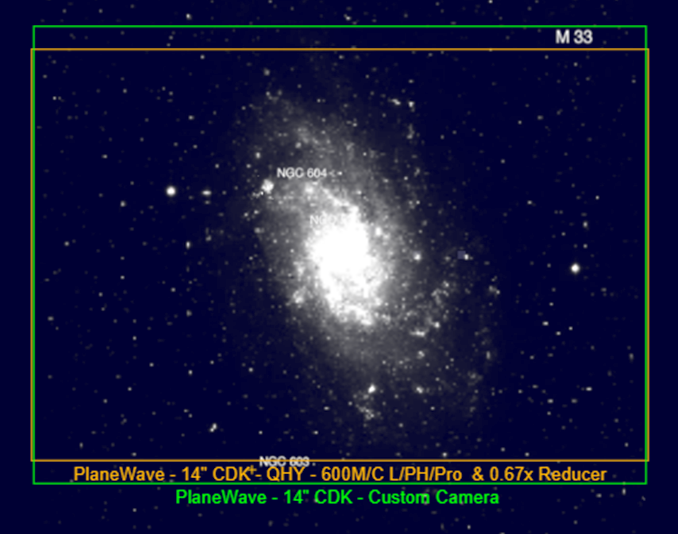

FOV gain:
Rouzbeh 8.95

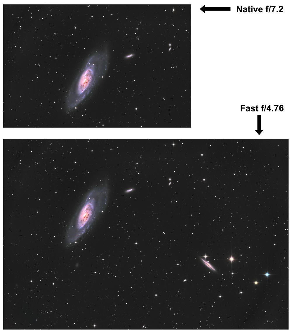

You get the same FOV as the $50k IMX411 at native f/7.2 (green) Plus you don't need 65x65 filters. There is no perceivable loss in image resolution as it will be over sampled at 0.46"/pixel in almost all cases. The best seeing I got this season was a 1.7", the reducer image scale was still 3.7x that of the sky.
jhayes_tucson 26.84
Rouz,
Congratulations…that is one of the better focal reducers that I've seen.  It looks like it works quite well!

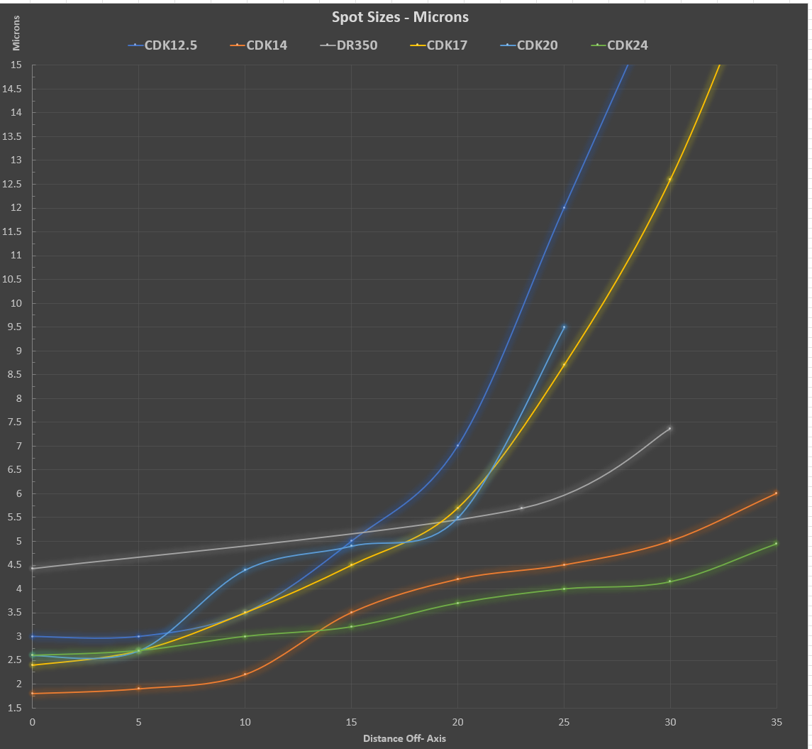

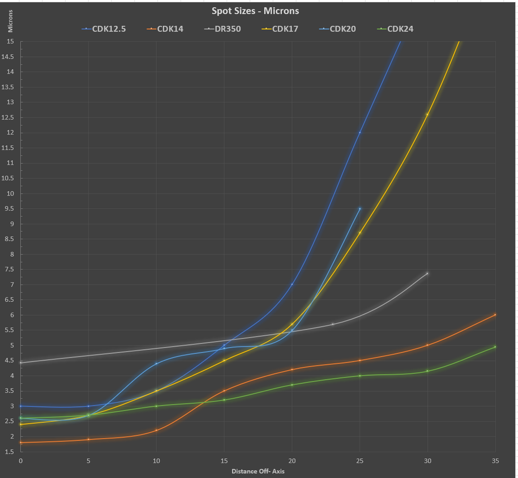

I also put this graph together from the little data available on the CDKs. These are the spot sizes of the CDKs scopes, you can see the CDK14 is better suited to work with a reducer.
I believe to get a 43mm field with 0.66x roughly translates to a 43/0.66 = 65mm.  If the native circle is 50mm, chances are the full frame corners will suffer.

jhayes_tucson 26.84
Wei-Hao Wang:
Hi John,
After the conversation with Rouz, I realize there is probably not an easy way to reduce our CDK20 and maintain good IQ over a large field.  Now my line of thinking is just to upgrade our 16803 CCD to a 44x33mm format low-noise CMOS camera.  Both 16803 and a 44x33mm CMOS have diagonals almost exactly the 52mm diameter of the image circle claimed by PlaneWave.  But the low read noise of CMOS allows to bin-down the pixels dramatically, making it almost equivalent to a focal reducer plus an FF camera that also fully occupies the reduced image circle.  This will be probably a lot easier than finding a suitable reducer.
Wei-Hao,
I think that's correct.  I've been using a QHY600M on my 20" and I'm pretty happy with it.  It has unit gain in Mode 3 at a gain setting of 25 and that give RN about 1/2 that of the 16803 with just about 65k well depth.  So if run in that mode and you bin 2x2, the RN will be about the same as the 16803--and the QE is significantly higher.  Overall, it is a VERY clean camera.  At first glance, the QHY461 appears to have similar numbers.  That looks like a great camera but it's roughly 5x the price of the 600M, which lies a bit outside of my "value-window".  I'll be interested to know what you think of it if you decide to take that path.  Under good seeing, the QHY600 is a better match than the 16803 on my F/6.8, 20" scope.  (I presented a moderately detailed analysis of this issue at AIC this year.  If you are interested, you can find that presentation here: https://www.advancedimagingconference.com/articles/secrets-long-focal-length-imaging-john-hayes.  The sensor discussion starts at about 22:45)
