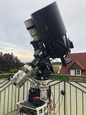

Here a low cost advise: some just rap (tin) foil around the truss. Also p\black gift wrapping paper works well. Lightweight, light tight and removable. And all by the price of a euro or less 😉
What I also used was a multipurpose 16” SCT dew cap wrap. Fits perfectly around the truss. Only a bit heavy. But works as good as the Aluminium shroud. 👍

this is exactly what I have done and described above. The „dew“ cab is held by Velcro. The only difference is, I have attached it outside. Inside has a huge danger you drop something on the mirrors when attaching and removing it. Moreover the risk of obstruction is immanent. And you have to remove it for cleaning and checking regularly.
Also a permanent “shroud” makes it impossible to put on the M1 cover. You need then an alternative - again tinkering….. keep it simple.

Hi Dale,
have a look on the photo above, this is exactly what you describe. I have used this: https://www.teleskop-express.de/en/telescope-accessories-5/dewcaps-and-heater-90/kendrick-2039-flexible-dew-cap-for-tube-diameter-535-mm-4586

Hi Dale,
Yes thats what I was just suggesting and wondered if anyone would be using this. I just didn’t remember anyone making a mention of it so thats why I decided to throw the idea out there is all.
