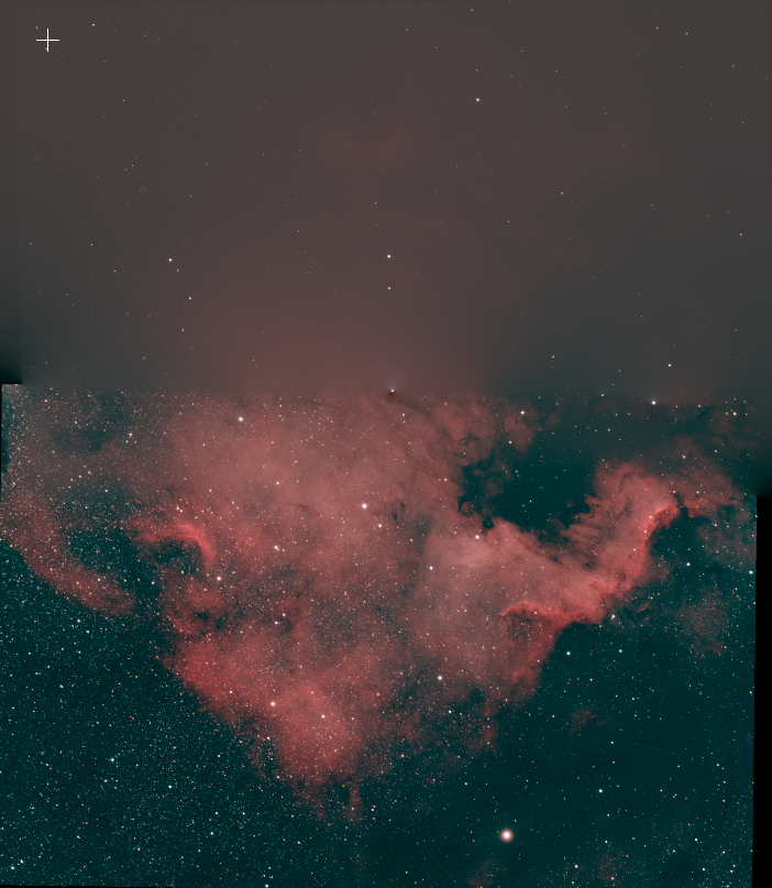

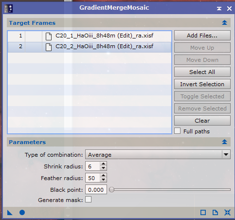

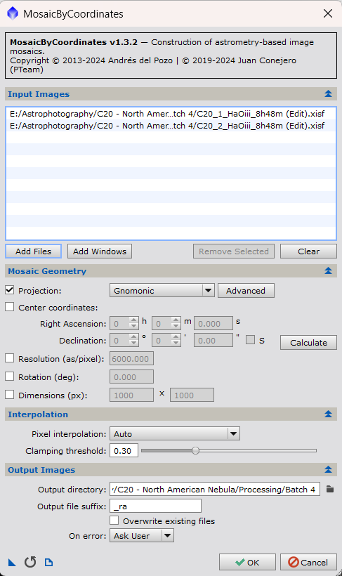

I've been trying to do a 2-panel mosaic. Below is the result I get from GradientMergeMosaic.  As you can see from the 2 images below, it's not correctly combining them. The top image is super blurry and the bottom image is super grainy and the contrast is screwed up.   My steps to this point: - Did a STF - Resampled at 50% - Cropped - DBE - Image solver to plate solve - Mosaic by coordinates (see settings below) - Gradient merge mosaic (see settings below)   I've played around a bit with these settings, but nothing has fixed it. Any ideas what's going on? Am I missing something? I have successfully done this before with the same process, so idk why this time is different. Thanks in advance!

That is because these two images have different brightness levels. You can use linearfit to make both images have the same brightness. Be cautious; it needs to be done before mosaic alignment.

Tipically GMM works best with stretched imagens - try to stretch both and then run the process. If it doesn't work, then I would go for PMM, as other colleagues are mentioning.

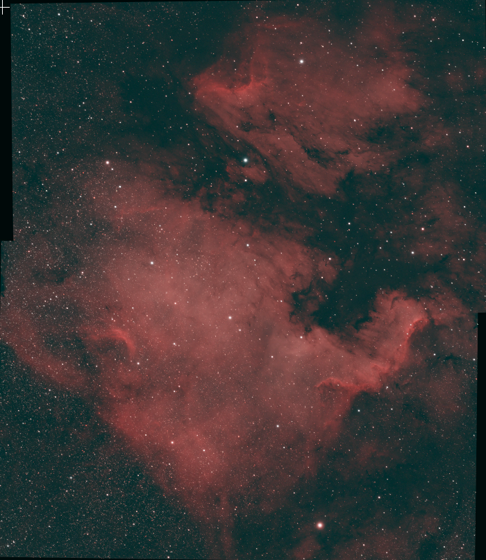

Shun-Chia yang: That is because these two images have different brightness levels. You can use linearfit to make both images have the same brightness. Be cautious; it needs to be done before mosaic alignment. This worked, thank you! Only note was I had to use DNA Linear Fit instead because regular linear fit gave me errors. Only other downstream issue was the bright stars where the image overlapped was giving me some strange artifacts. But I was able to solve that with pixel math (following the pinched star technique here: http://trappedphotons.com/blog/?p=994). Aside from that, just needed to hit the image with a quick background neutralization afterwards to equalize the green tint.  |
