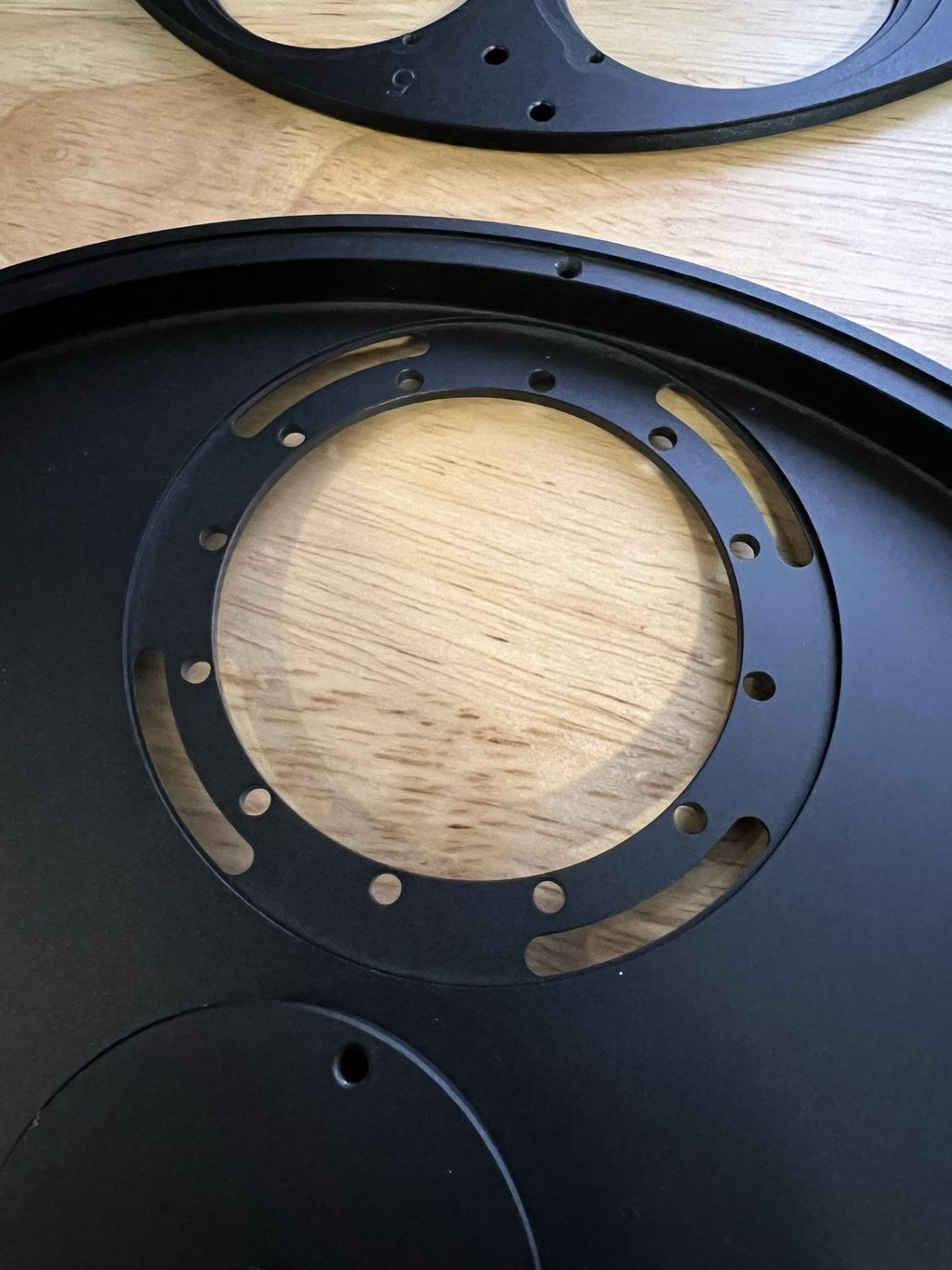

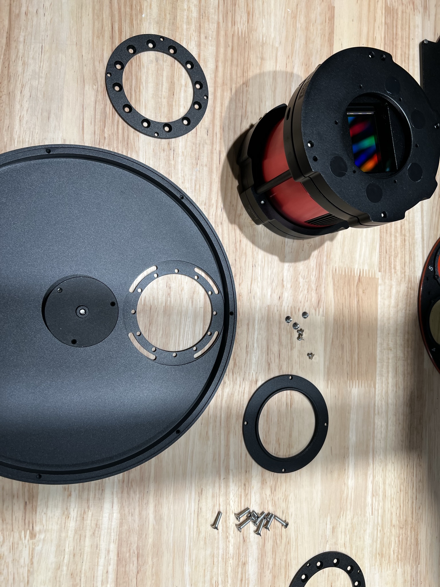

I went ahead and ordered an Indigo to try out. Does anyone have tips on how they matched adapters here? I'm thinking i'll attach the EFW directly to the ASG photon cage I'm a little confused as to what the m54 ring with 12 counter holes does. I know that it allows slight rotation, but then it's really unclear what else attachs. Any chance one of you saved some install pics when you put this together?   |
When you bolt accessories to the Indigo you use that ring with all the holes to mask the slotted holes. Otherwise they are dust and light leaks.
If you are threading accessories you use the other adapters and these also block those slotted holes (also where they attach).

Thanks @Chris White- Overcast Observatorythats very helpful. I was expecting them to be flush or work as a washer or something. Makes more sense now.
Nick Grundy: Thanks @Chris White- Overcast Observatory
thats very helpful. I was expecting them to be flush or work as a washer or something. Makes more sense now. The disks with all the holes go on the inside of the wheel so you dont even notice they are there. The other adapters do stick out a little and each add 0.3mm to the thickness of the FW when used.
