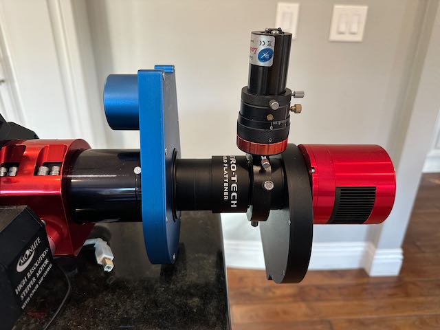

HBNorm 1.43
Here's an example of placing the rotator before the field flattener.  Not the best looking set up but it works perfectly! ;-)  Good luck and clear skies!
