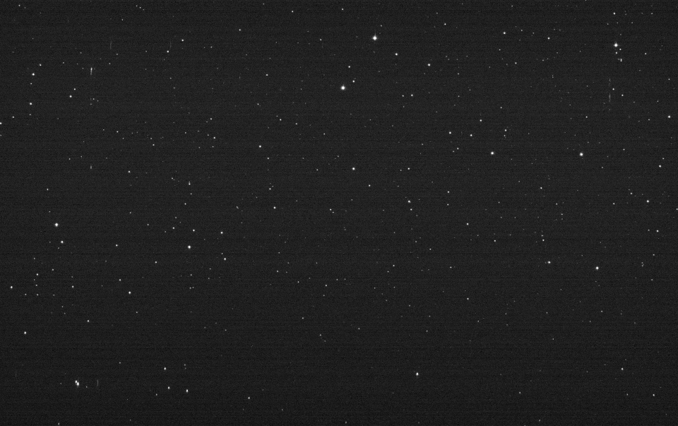

I have been having problems, especially when imaging on bright moon nights, where reflections on the OAG pickoff prism are causing significant deviations in guiding, where PHD2 locks on these reflections and the stars go 20-30 arc seconds in the opposite direction, completely destroying the exposure. I tried to single out these reflections by choosing a tighter selection criteria for HFD and SNR, but I still can't help but have some get selected in multistar guiding. Here is an example gif I made from the recorded frames in PHD2 when this happens to debug the issue. You can see the reflections in the top corner. The stars are flying by because PHD2 is trying to keep the top left reflections in the frame.  Any suggestions other than dismantling the remote equipment? (something I really don't want to do now).

Would it be possible to post an image or images of the guiding frames.

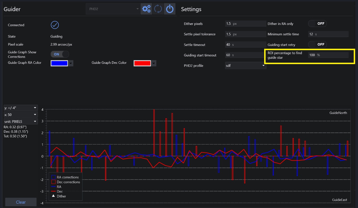

I'm not sure how to get rid of the reflections but if the reflections are only out in the corners/edges and you are using NINA, in the guiding settings in NINA you can select the percentage of the ROI to find a guide star and reduce that value so you are not including stars or reflections out towards the corners/edges. I personally haven't tried this myself but it is a setting in NINA.  |
Logan Carpenter: I'm not sure how to get rid of the reflections but if the reflections are only out in the corners/edges and you are using NINA, in the guiding settings in NINA you can select the percentage of the ROI to find a guide star and reduce that value so you are not including stars or reflections out towards the corners/edges. I personally haven't tried this myself but it is a setting in NINA.
 Thanks Logan. My understanding is ROI feature is not compatible with multistar guiding, which is a deal breaker.
Ah ok I didn’t realise that.

Paul Hi Paul. The animated gif I posted actually shows the frames from the guide camera as captured from PHD2. You can see the streaks of faux stars in the top left corner. Not shooting close to the moon at all. In fact I realized when looking at the timestamps for the frames that this happened minutes before the moon was even over the horizon, so they are certainly not common from moonlight. Maybe a bright star out of the FOV.
