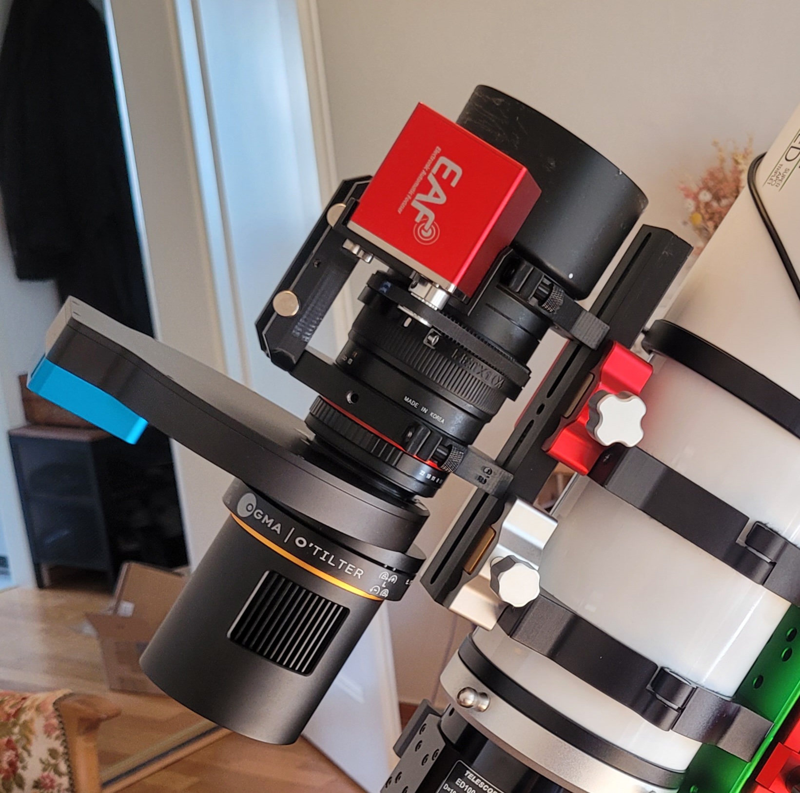

Hello Dcolom.  Very nice image.  I'm currently assembling a similar rig with the Rok135 and am trying to decide on the camera.  The OGMA is interesting and your results are making me lean that way.  I'm curious from the photo how you are attaching the camera to the lens–is it a typical T-ring?  Did you need another spacer when using it with the filter wheel and O'tilter?  Also, are you using the Antlia fast focal ratio filters?  Thanks!
jewzaam 3.01
Frank Spasaro:
Hello Dcolom.  Very nice image.  I'm currently assembling a similar rig with the Rok135 and am trying to decide on the camera.  The OGMA is interesting and your results are making me lean that way.  I'm curious from the photo how you are attaching the camera to the lens--is it a typical T-ring?  Did you need another spacer when using it with the filter wheel and O'tilter?  Also, are you using the Antlia fast focal ratio filters?  Thanks!
I have the AP26CC with my Rokinon 135.  I've connected it two different ways.  The simply way is the ZWO EOS filter drawer.  But I wanted to have an EFW.  So I changed the bayonet on the camera and got a 6mm spacer.  I have a set of aluminim spacers to get the right backfocus (or close enough) and then use the O'tilter to dial things in.
Parts list:
I think I have a total of 1.7mm of spacers in there too.  Lots of trial and error but the o'tilter is great to work with, worth the initial pain to setup.
