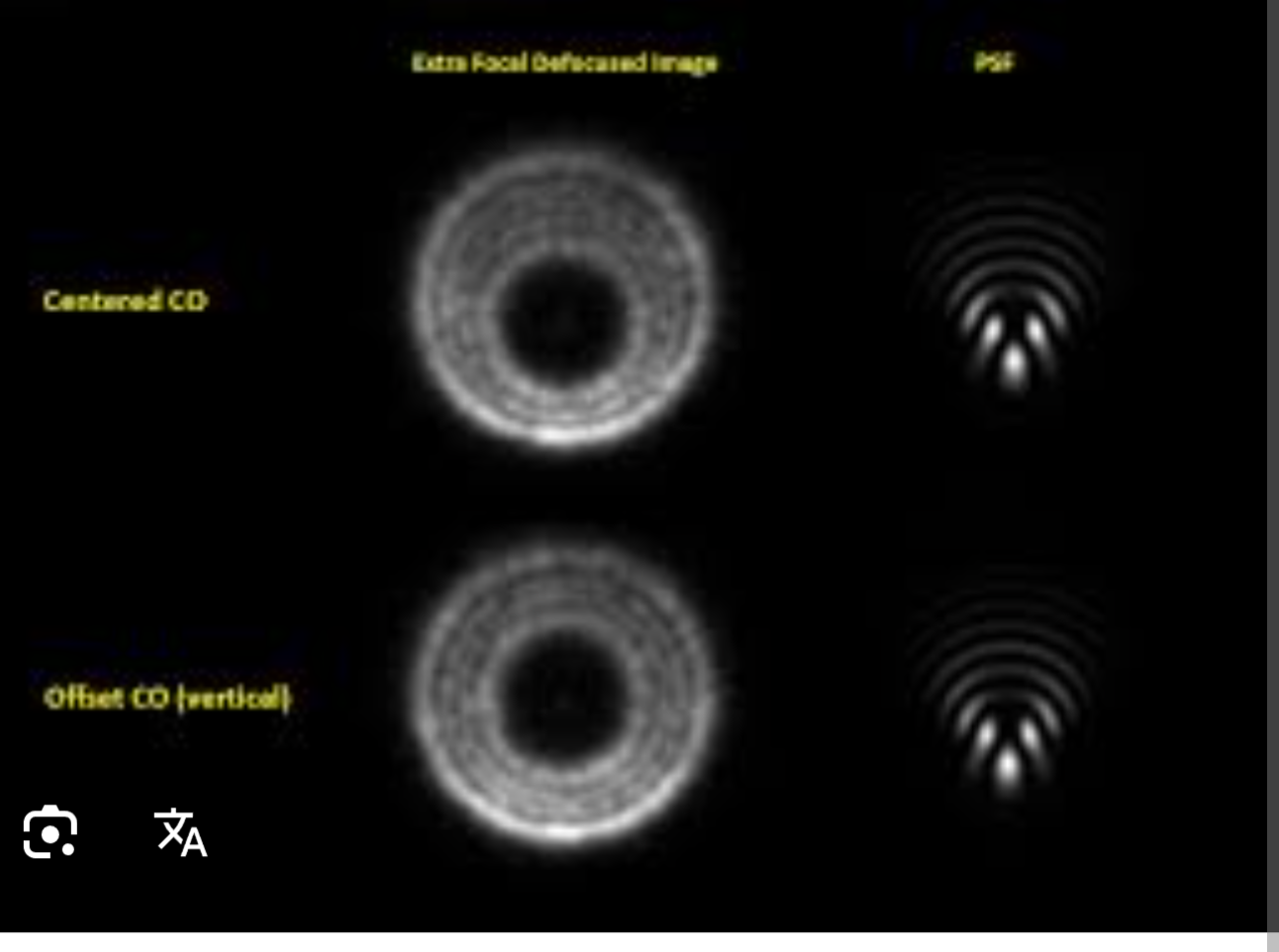

I forgot to keep an image of my defocused star but i Found something on Google to explain my problem .
I use a quattro 200p . I did my collimation with the ocal collimator . When the Night came , i checked my collimation on a Bright star and the star was a beautifull Donut but on the left and right it was like on the image ....but worst ! Overall , the result Turned out ok but i want to correct this problem .

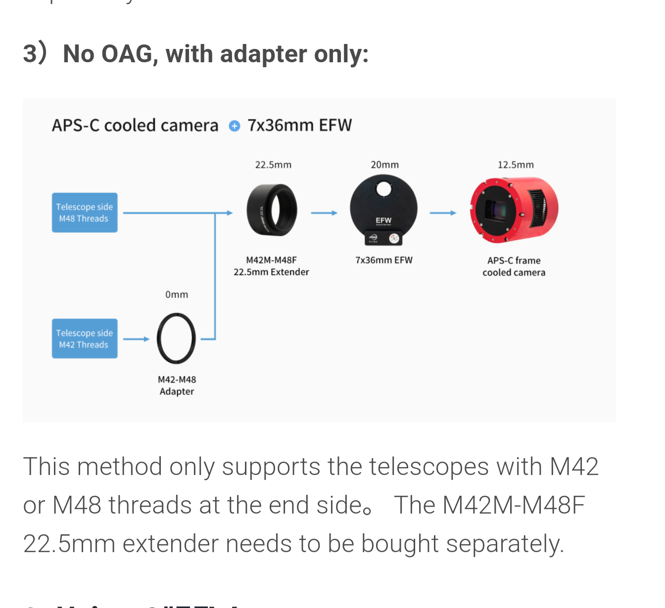

Im using exactly what they Say on the zwo website Screenshot_20250107-130346.png
Ricksastro 1.51
Sounds good.   It’s just that your original post was confusing.
That’ll be what I’m using as well (except I have an OAG instead of a spacer).

The appearance of the defocused star's central obstruction on the edge of your image / off axis cannot be used to determine collimation. My epsilon's defocused stars on the edge look like crescent moons when collimated.

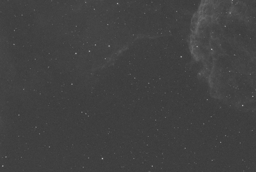

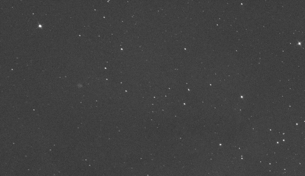

Here is 3h in HA . You can see that the big stars are not perfect . Thanks to Russell croman and blurx .
I dont have an image of my outfocus stars
That example is worthless. You need to provide an unprocessed auto stretched image, possibly without a NB filter in place to get started. The real deal is judging the Airy disk shape with a high-powered EP which I doubt many do. The only way to judge collimation is at the image center,  way off center means nothing in that regard. Tilt, however,  requires a full view of the field, in focus.

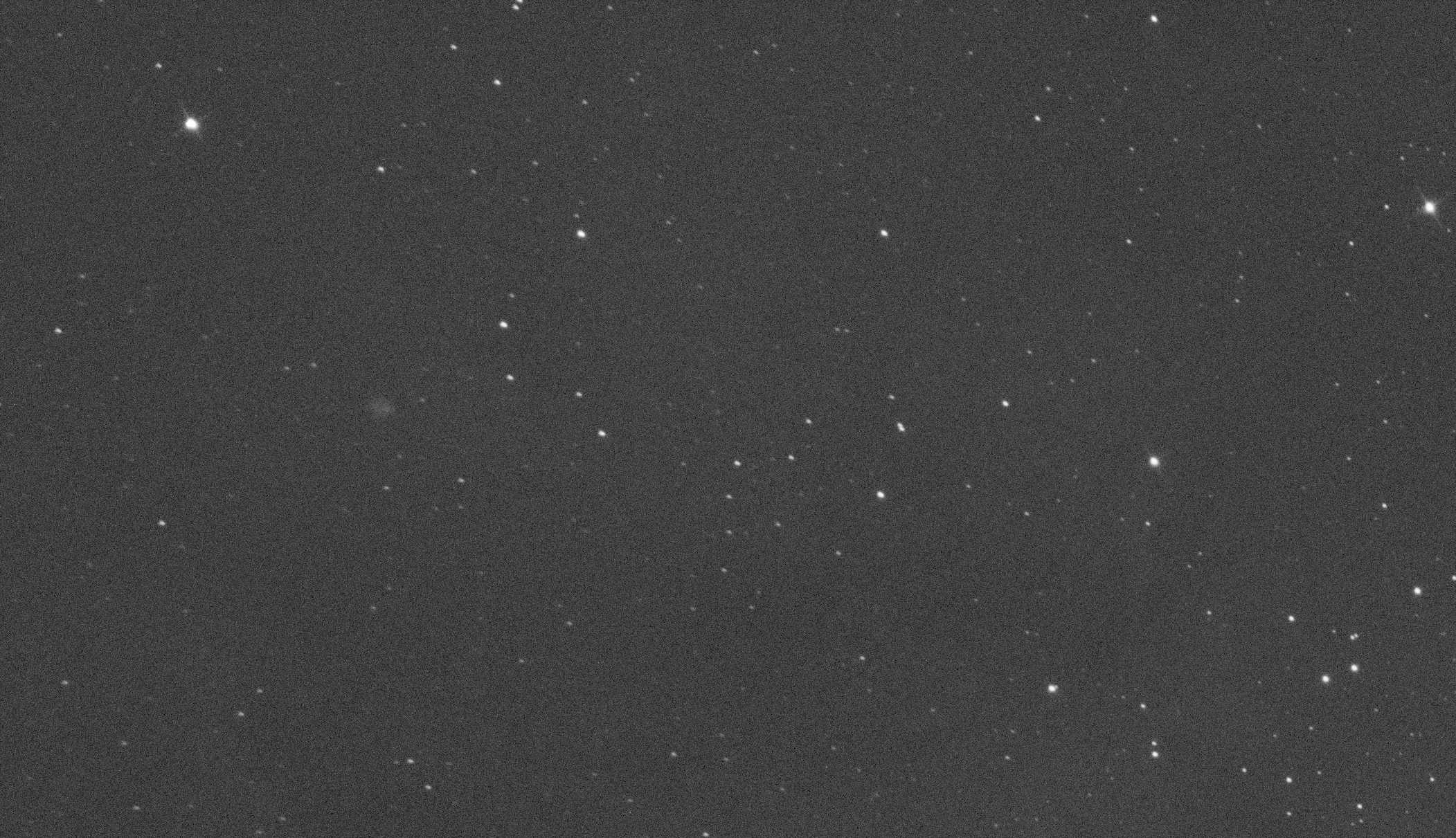

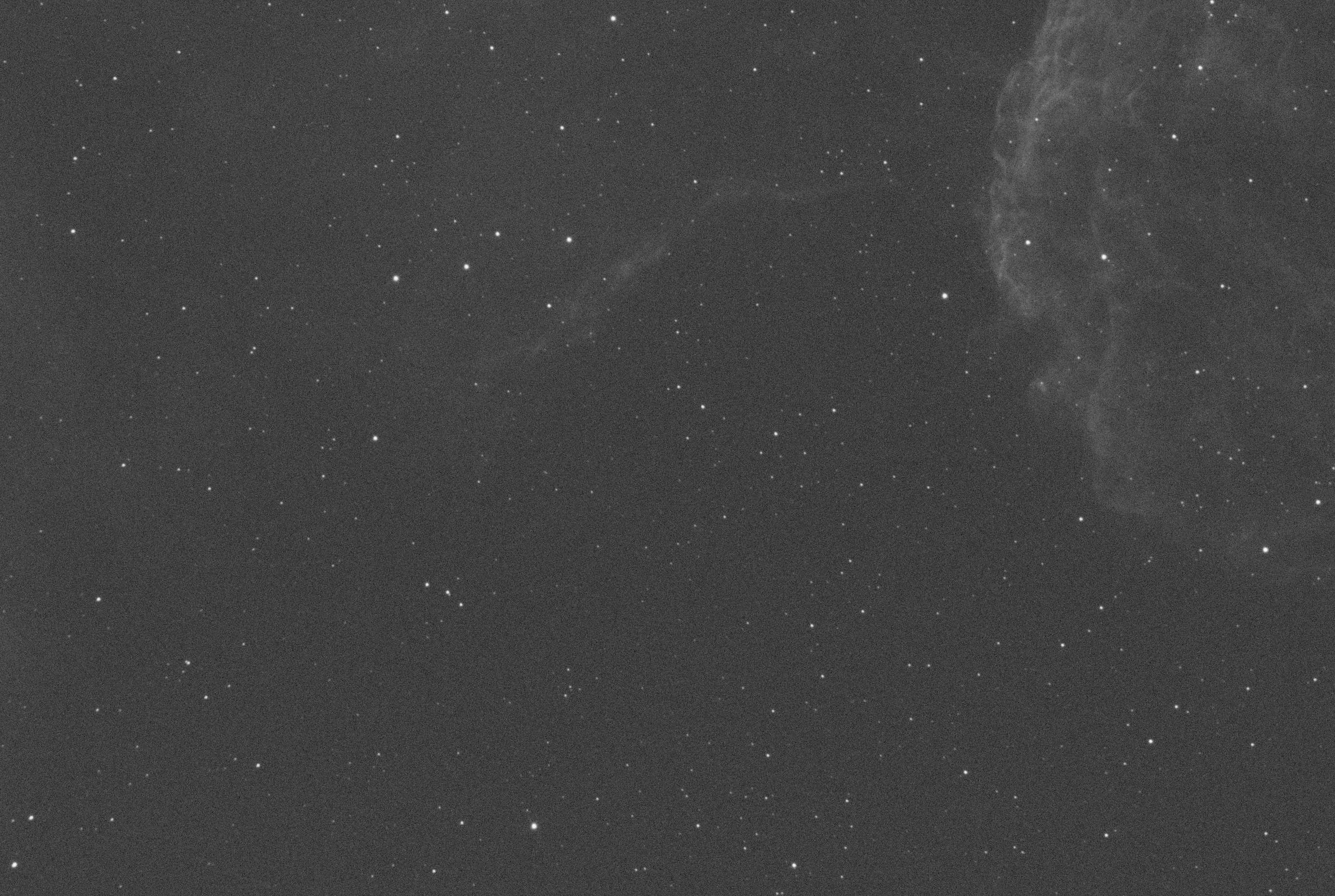

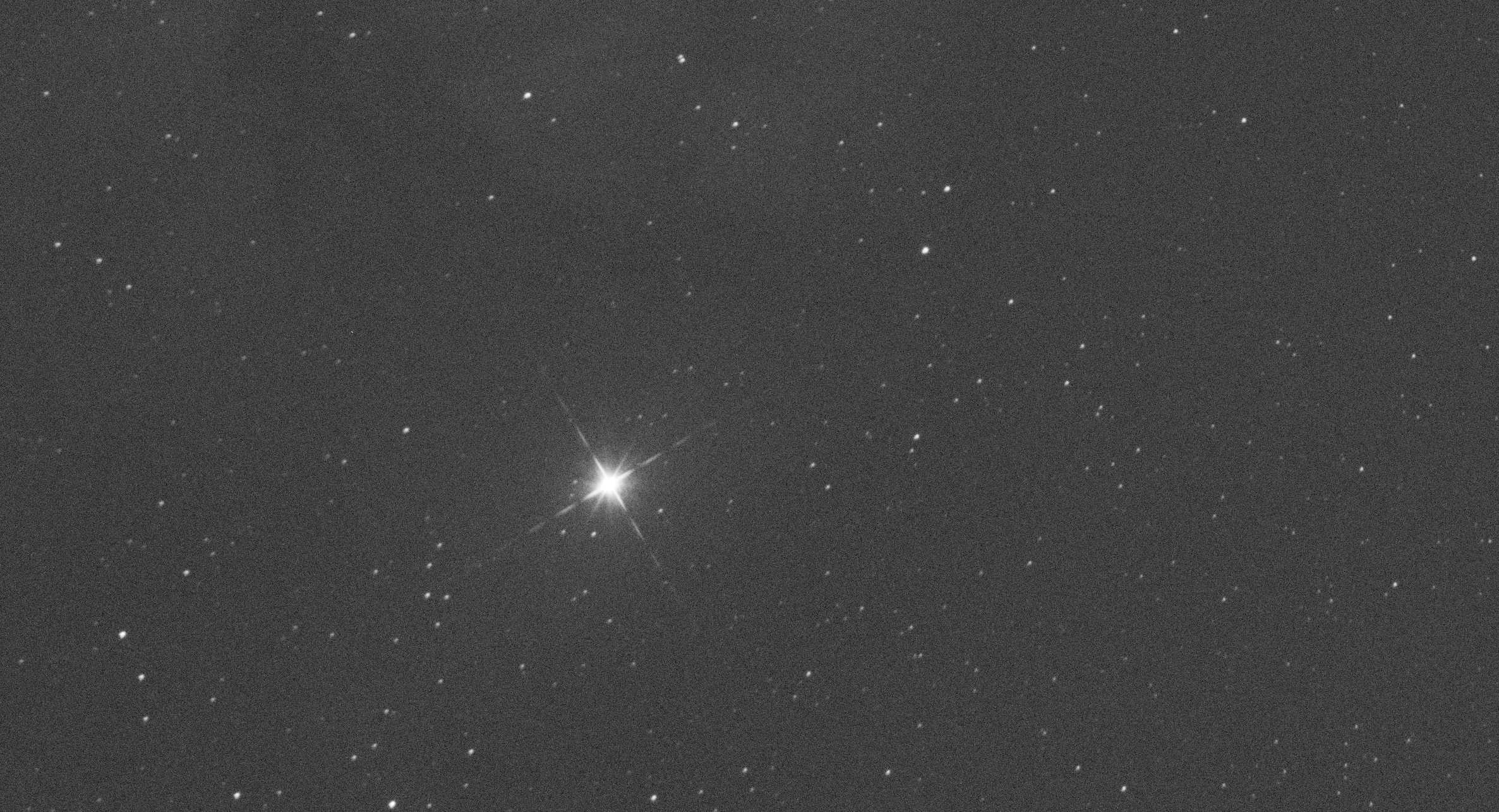

Here is a 2 min sub . It's not High quality because i cant attach big file here . I did 3 crop of the same sub .  top left , center and bottom lefttopleft.jpgcenter.jpgbottomleft.jpg
Collimation and then tilt
Ricksastro 1.51
Top left and bottom left show similar elongation and the center one looks pretty good.   Not sure if there's horizontal tilt since we don't have the right side.    But if the right corners look similar to the left then likely a small backfocus delta or just the optical limitations of a mass produced scope with a pretty extreme focal ratio.
