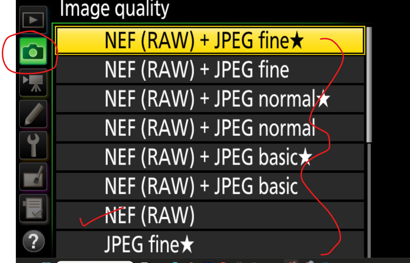

Hi
You shared JPG version. Are all 90 subframes in .JPG or you shot RAW format (.NEF) . NIKON D7000 or any Nikon RAW will have extension .NEF. If all original data (90 subframes) in JPG, that might explain.
What is the following MENU item set on your camera. I also highlighted NEF (RAW).
