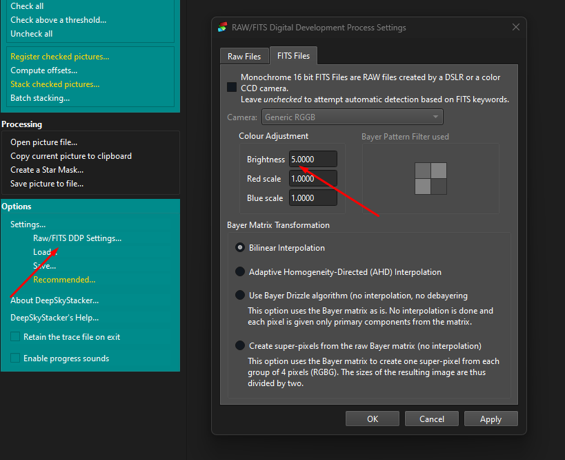

Drop the star detection down as far as you can. I think it’s 2 percent. I used to have this same problem. Usually when I bring it down to its lowest setting it would stack all the frames. Unless focus is really bad or trailing is really bad.
char32geek 2.11
You can also adjust the brightness of your raw/fits to 'bring out' more stars if they're there, just too dim to detect.  I had to do this recently when doing lucky imaging with my planetary camera.

Lower the star detection threshold (minimum is 2%) so DSS can detect more stars. Around 100 stars is a good number.
Also, if that does not work, increase star brightness in the RAW/FITS settings to 3 or 4.
I have used DSS for many years and it works very well, just experiment with the parameters.
